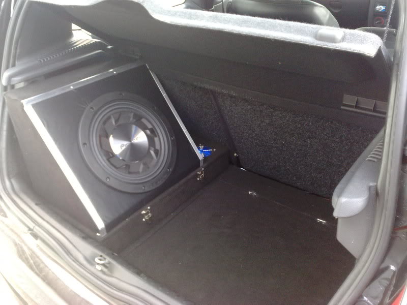

Here's a pic of mine...I could modify mine quite easily to act as I recommend above....

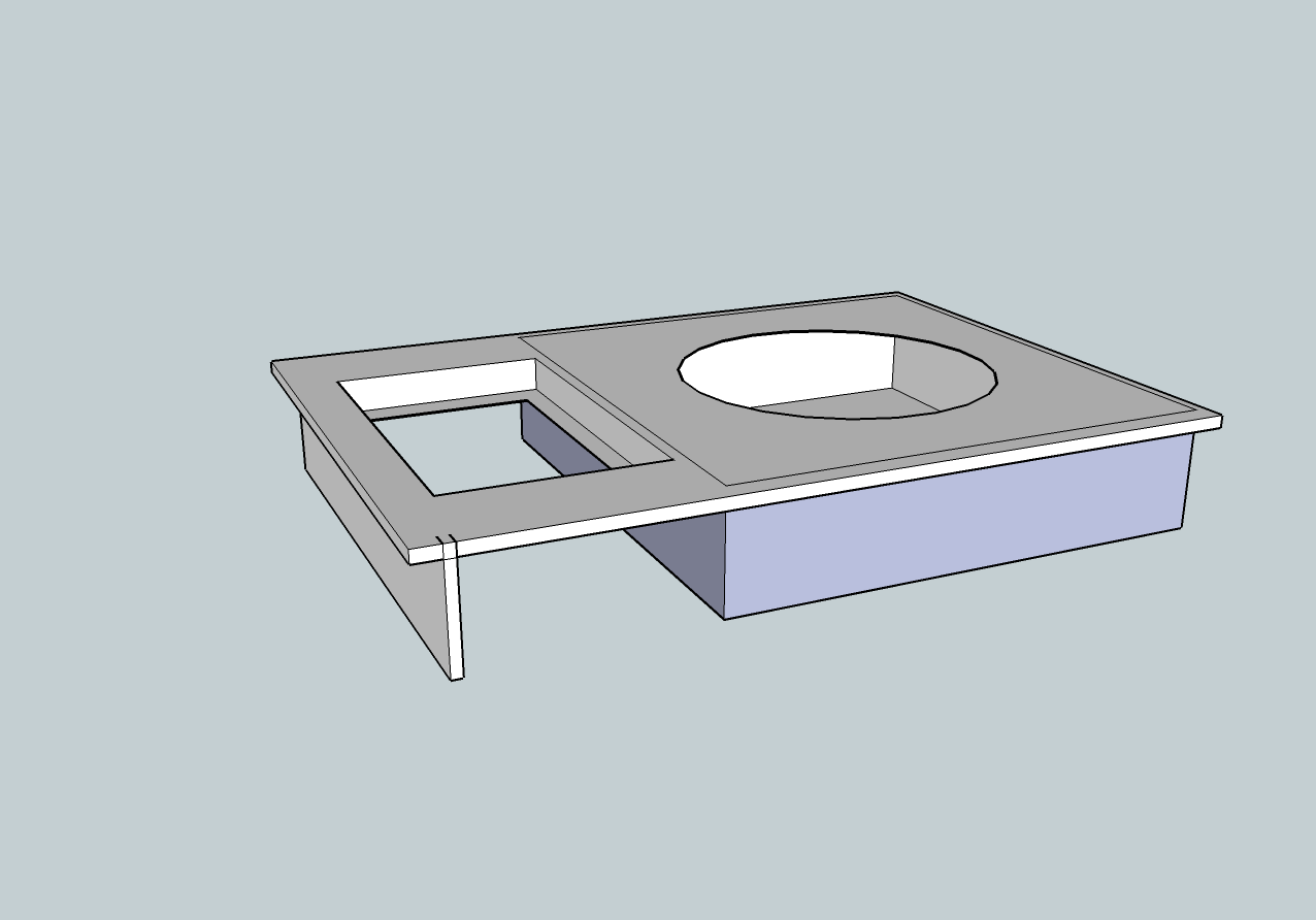

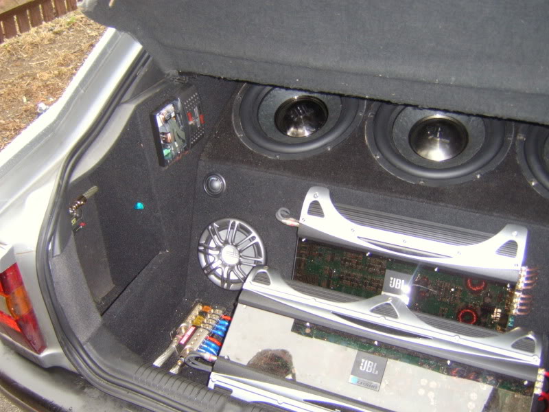

Heres a quick mock up I did on google sketchup which will be my next build (When the sun comes out and I can get cutting outside). Hope its some help.
Oh and if you want to fill all the edges you want to get a bit of hardboard and carpet that (instead of the box) and lay it over the top of the box. As you wont be able to build the box to fit the edges
Also, like has been said, dont put 6x9's in the boot. There is no point. It will most likely echo and sound terrible. Dont put them on the parcel shelf either. If you have a sub in the boot it will shorten the life of the 6x9's. You're better off getter components in the front (And back, if you want the hassle)

what would the measurements be of that?
including how high it would be of the boots floor?
I just did that as a quick idea, basic measurements would be the height of the boot (To the bit where the tailgate meets the boot, so its a fake floor), width and height of the top part would be dependent on the bootsize. Then the sub box would be dependent on what the sub needs, taking in that it need to be only a certain hieght.
