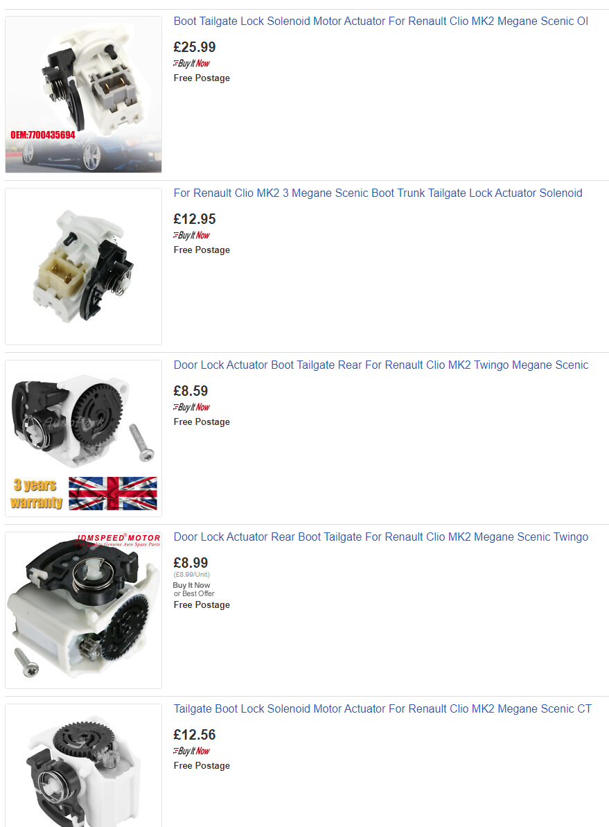

Right - this solenoid has gone again - each time it sounds like it's grinding gears when the car is locked/unlocked. I suspect the lovely black crown wheel at the end is gradually getting stripped by the motor gear beneath it.
It was barely a tenner for the part back in October - but it worth buying another eBay jobbie - or are the OEM ones a LOT more expensive?
Just had a quick look on the 'Bay....

These are common as muck. Mine had gone when I got the car. I replaced it with a scrap yard one. Every time I go to the scrappy and see a clip I grab them as they go all the time and mine has gone again but I have 3 in the shed. If you have that luxury then just grab them and stock up as I can assure you they will go again.

I must have been just bloody lucky with mine then! :LOL:
The one that went last September was the OEM part - and now its replacement has followed suit. No worries - I'll get another ordered.
