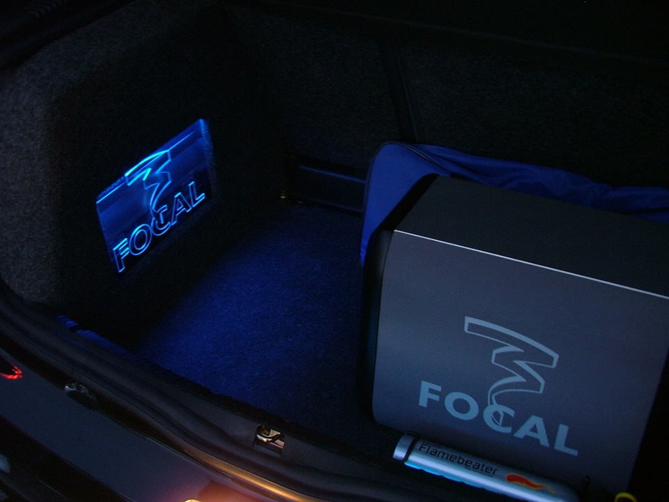

I wanted a neon, Ended up just replacing the festoon bulb with a blue one. And im happy with it. Does what you want (on and off with opening and closing the boot) and it illinates the whole boot at night:

Two 12" neon bars - one in the amp panel and another bolted under the boot latch to light the sub

look nice mate so basically u just used the old boot light feed ? i only want one single 12" light. if so how did u connect the pos and neg from the neon just with crimps, and what did u do with the third cable in the boot light ?
So long ago now since I had that setup, think the neon was connected to a black and a red wire with bullet connectors
I didn't do it myself the installers put it in.
