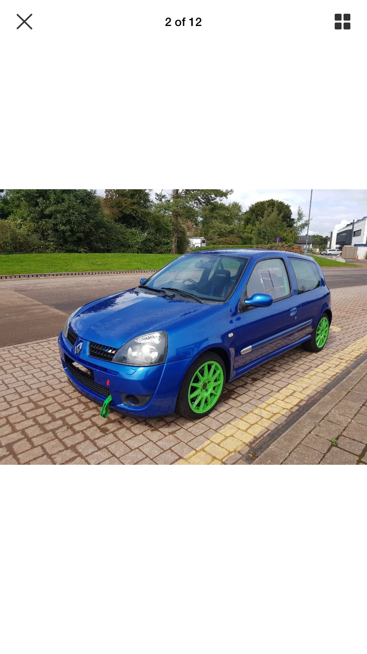

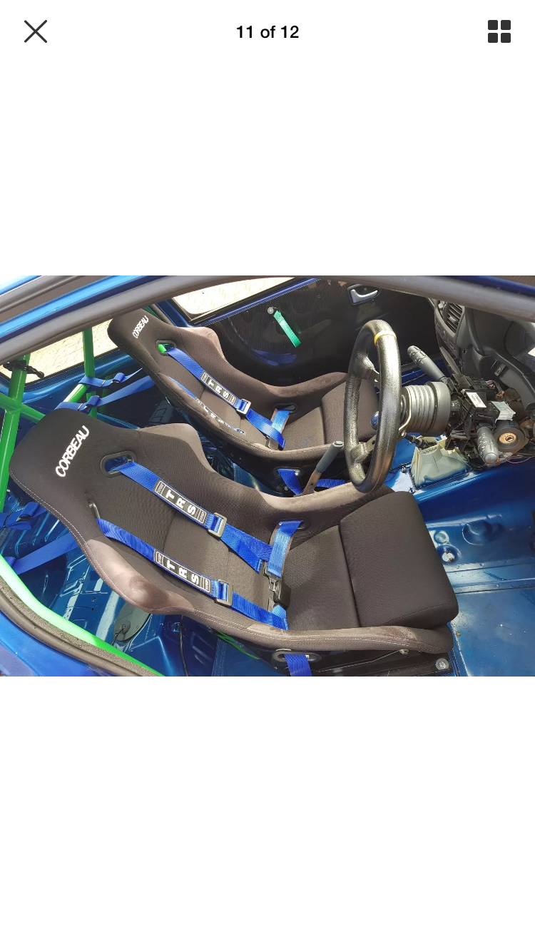

Hi all, recently just purchased my first Clio 172 cup. The car has been stripped and built purposely for track with buckets seats and harness and few other tasteful mods.
I have never done a track day and looking to go on my first one in November, was just wondering about tips and any general information about first time on the track and what brakes people are using on here? And is the tuition worth the money?

I saw that on eBay on thought it was a lot of car for the money. A good buy.
Tuition will benefit you more than fancy priced brake pads.
Enjoy.

Welcome along, looks tidy that
Tuition is well worth the money, especially if first track day. Get it booked for the morning, will help you a lot. I did my first track day at Cadwell in my 172 and didn't kill myself, just build your pace through out the day, and check your mirrors
If the existing brakes have plenty of meat on them and in decent condition, I'd do the first track day as the car is. It's got the brake cooling in place on the front, which will help a lot. Just do short stints will 15-20 min on track, and then a cool down lap and 20+ minutes off to let the car/you cool down. Leave the car in gear , and do not put the handbrake on
If the brakes do need replacing, get in touch I can supply various options of pads, discs, fluids, braided lines etc etc :up:

I'd be surprised if the car has been built like that with brake ducts if it has standard pads tbh. If it was mine, I'd be having it up to see if I could find out what pads are on it, sometimes the numbers are stamped, or if the pads are pretty new you can read the numbers.
