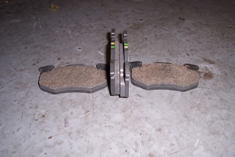

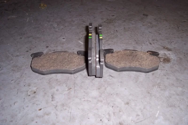

As above...check them yourself, you should see approx. 5mm of pad material plus the backing plate if they're brand new...and would need replacing at say 2mm of pad material.

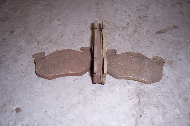

For reference, this is what they look like new...
...and this is what my rear pads looked like after 93,000 miles and a million trackdays/airfield sprints...
