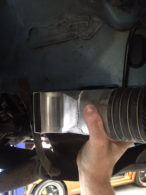

I got some of the 3d printed ducts from ebay and then got some proper ducts made up, not just deflectors -
joined the two together with some 76mm donkey d*ck flexi tubing.
I'm yet to try them with temperature comparisons but they look good!

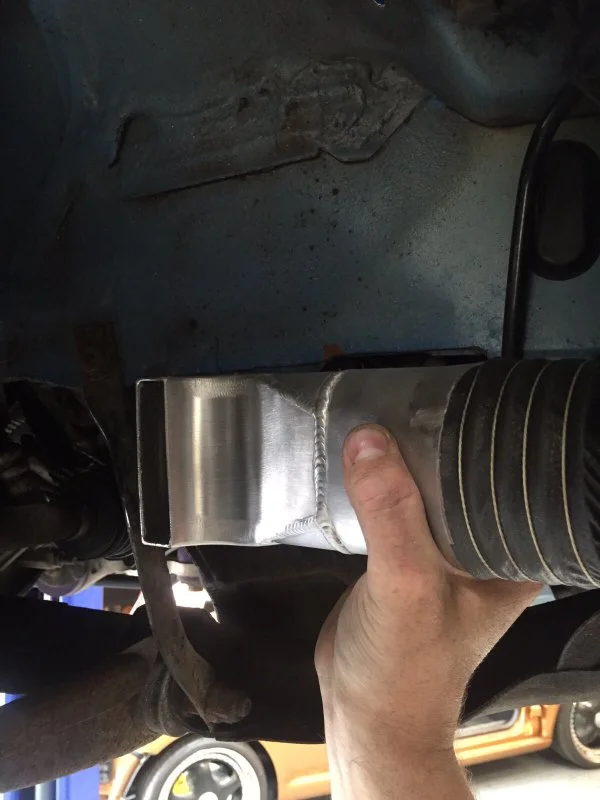

Looks good. You got links handsome?
