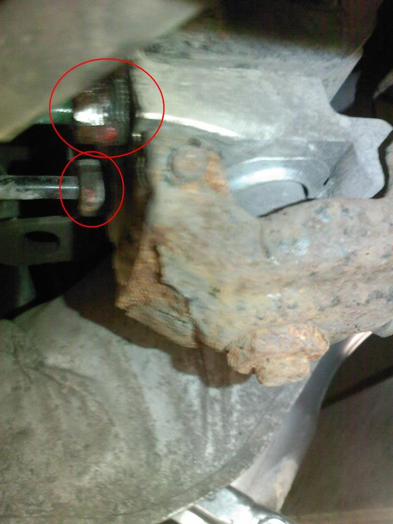

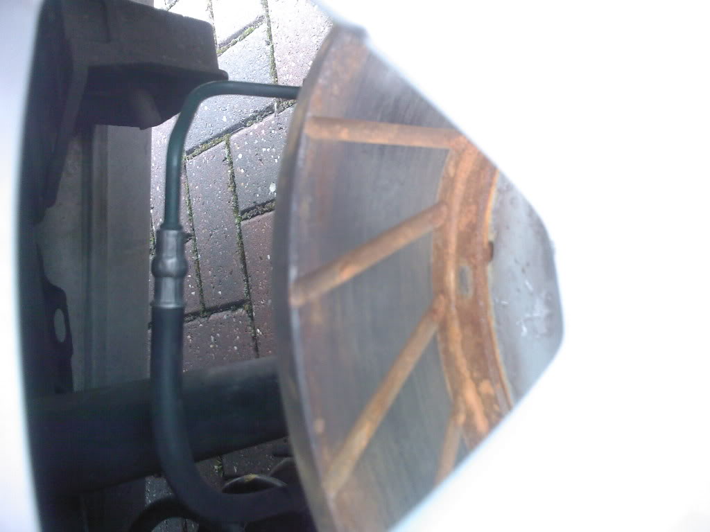

Hi, does anyone know how to access the top 2 pipes of the part (don't know what it's called or the part number) where the brake lines run from the front of the car into the block which has 4 brake lines, 2 of which run to the back calipers. I have undone the nut slightly on the bottom 2, fluid is coming out, but need access to the top 2 to see if there blocked. The reason is I cannot get any fluid from the bleed nipple or brake line when the brake hose is removed for the rear offside caliper. Just trying to see if fluid is getting blocked at this part (see pic 1). Don't know what the part is or what the part code is as i've said. This is what my disc looks like after being on for a couple of months, other discs are fine. It must be because of lack of fluid into the caliper.

I know it looks confusing but the pic is where the 2 brake lines run from the front of the car into a "box" at the rear of the car underneath. So 2 lines into this "box" which then has 4 metal brake lines from. Anybody know the part of part number please?

No, it's near the back underneath the car near the brake hoses. It's where the front to brake lines brake off from this sort of "box" and then to the rear discs.
