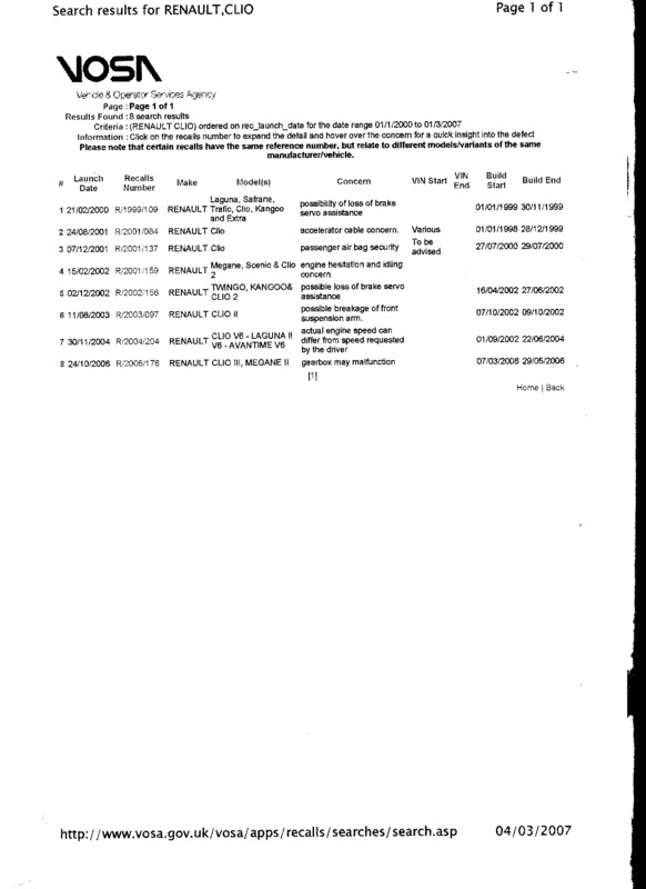

I was looking for something else and I came across this, it might be worth getting your dealer to check your VIN and see if its one of the cars effected, if so, get it in, its a free fix.
^^ interesting! sounds about right, although my car is three months older than the build start date!and surely the previous owner would have realised over the 4 1/2 years of ownership??
Not necessarily, some people just OWN cars, they don't worry about them till they stop.
Most maker recalls are recorded in the service book if the dealer remembers to write it in, best to have your VIN checked though.
