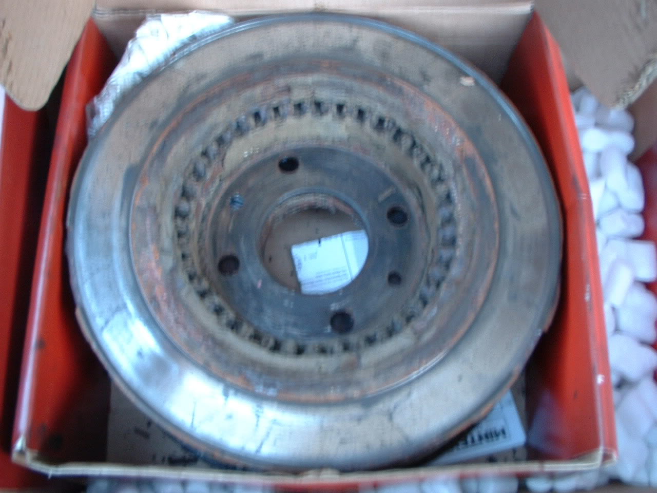

ps check the pic of the rear of the disk thats just corroded lol.......the corrosion is the same as the amount of pad that isnt in contact with disk....huge pic sorry

old disks were shot (see pic) but ive cleaned the are up where the pads contact.
