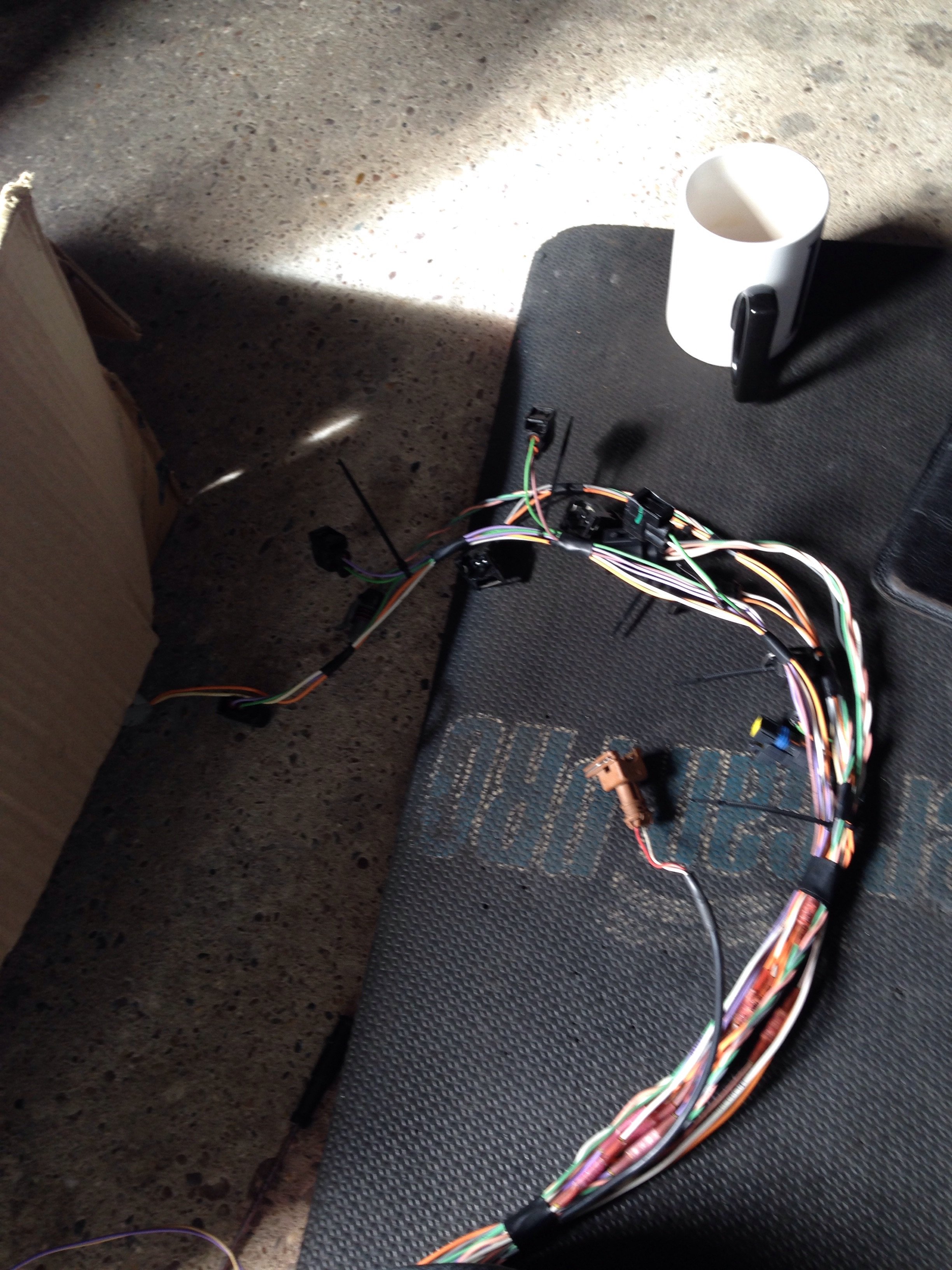

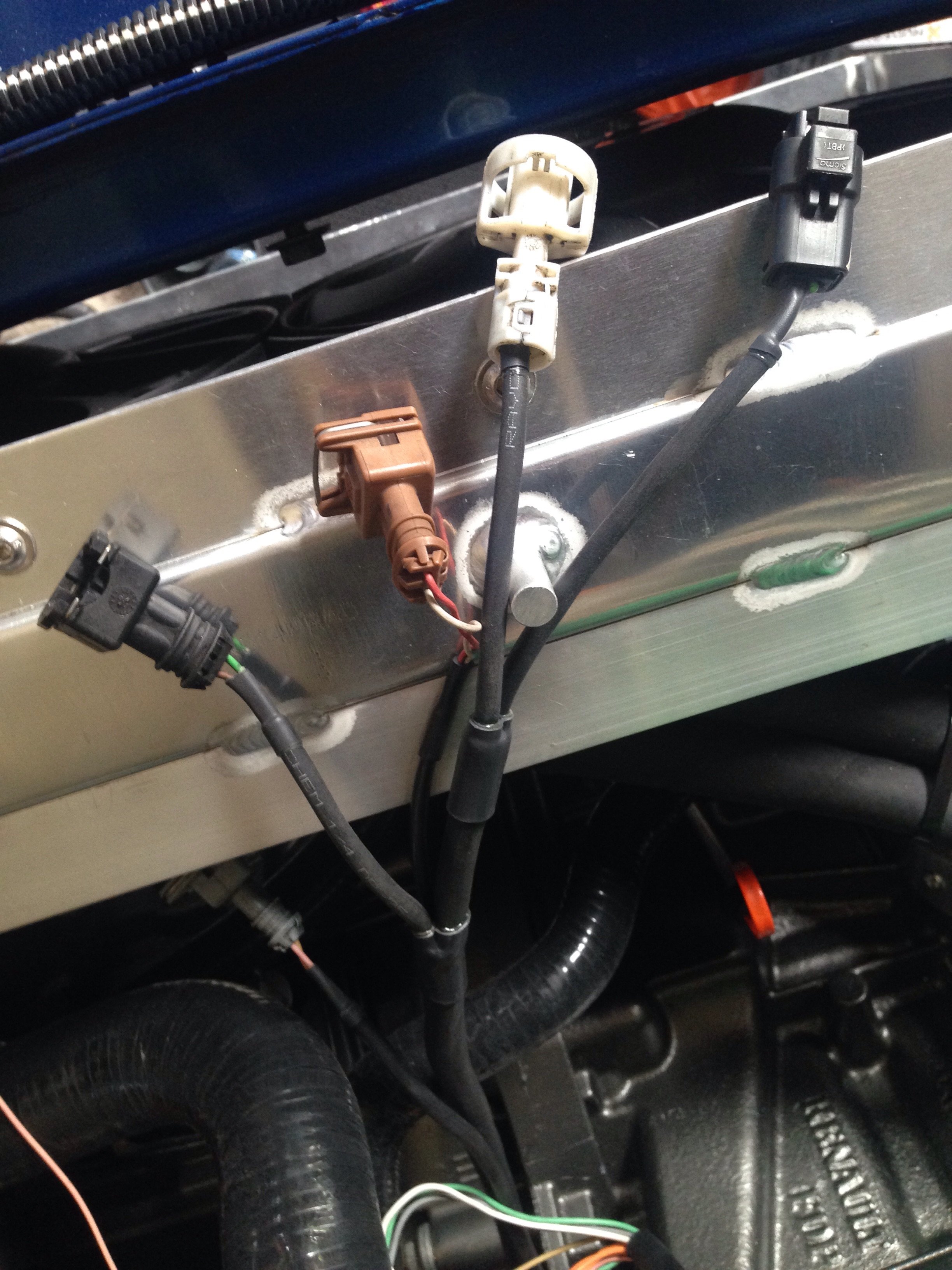

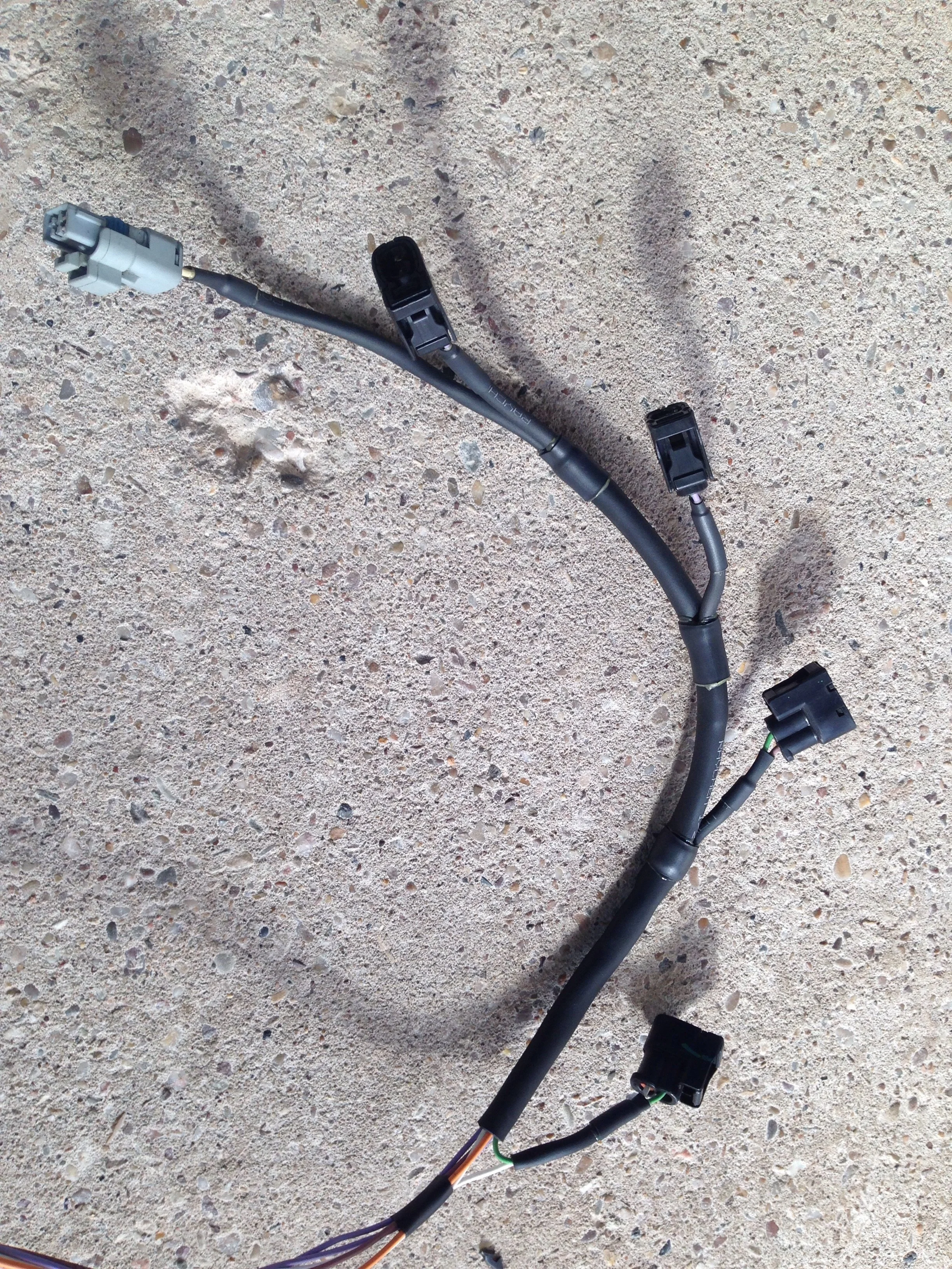

So, I've done a bit today...................Despite @not normal dan taking the piss after I told him I was in the garage! Lol!
Today's efforts started with this:
And ended with this:
What your looking at there is the loom for the vvt solenoid and the coil on plug. Still plenty to be getting on with though as there's effectively 3 separate looms! Stupid f**king 197 fancy s**t! Lol!
More to come. :up:

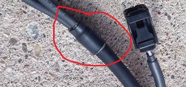

Looks good. What do you use under the heatshrink on these bits, is it some kind of glue?

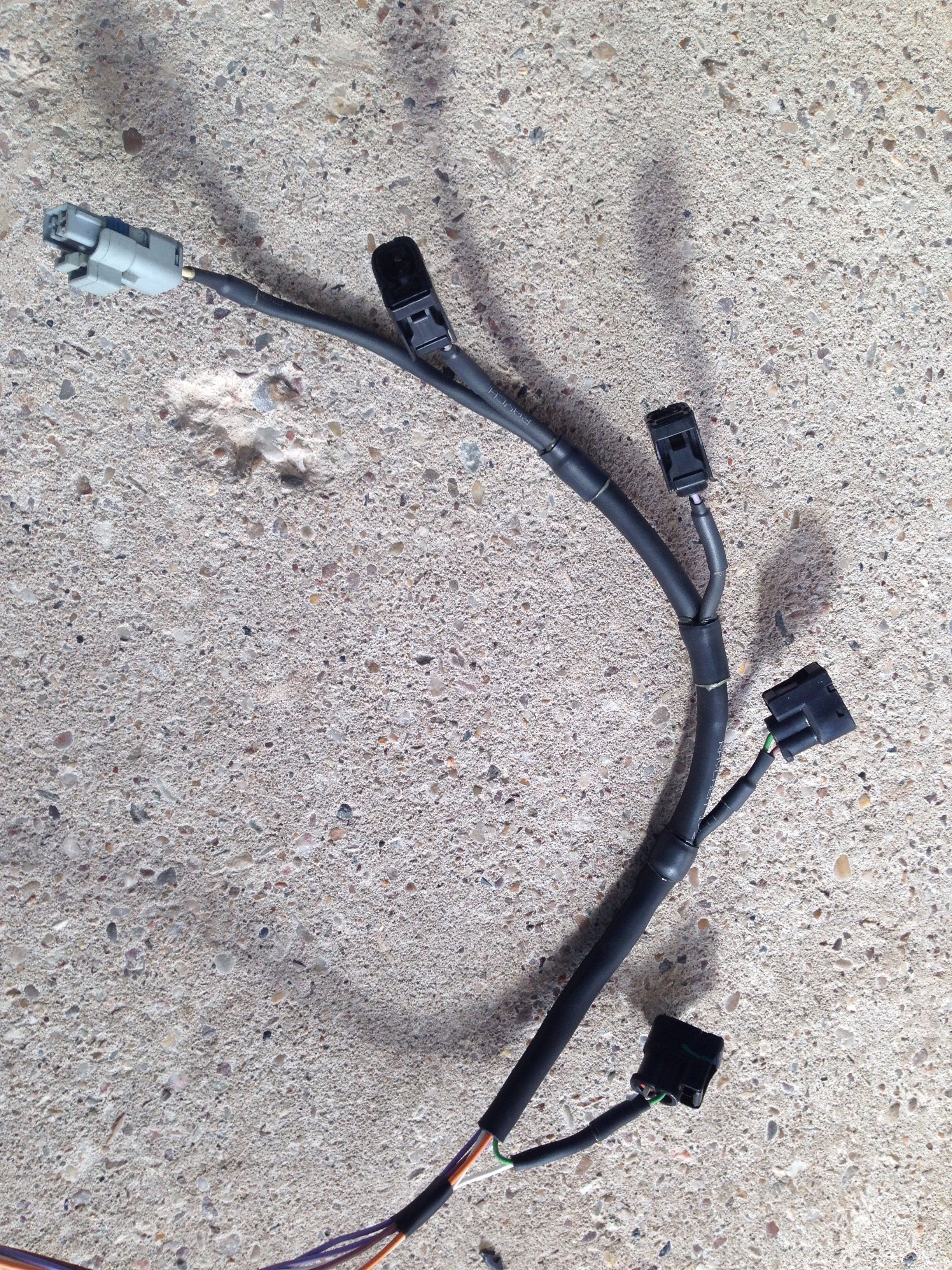

Today's efforts started with this:View attachment 132947
And ended with this:View attachment 132946
More to come. :up:

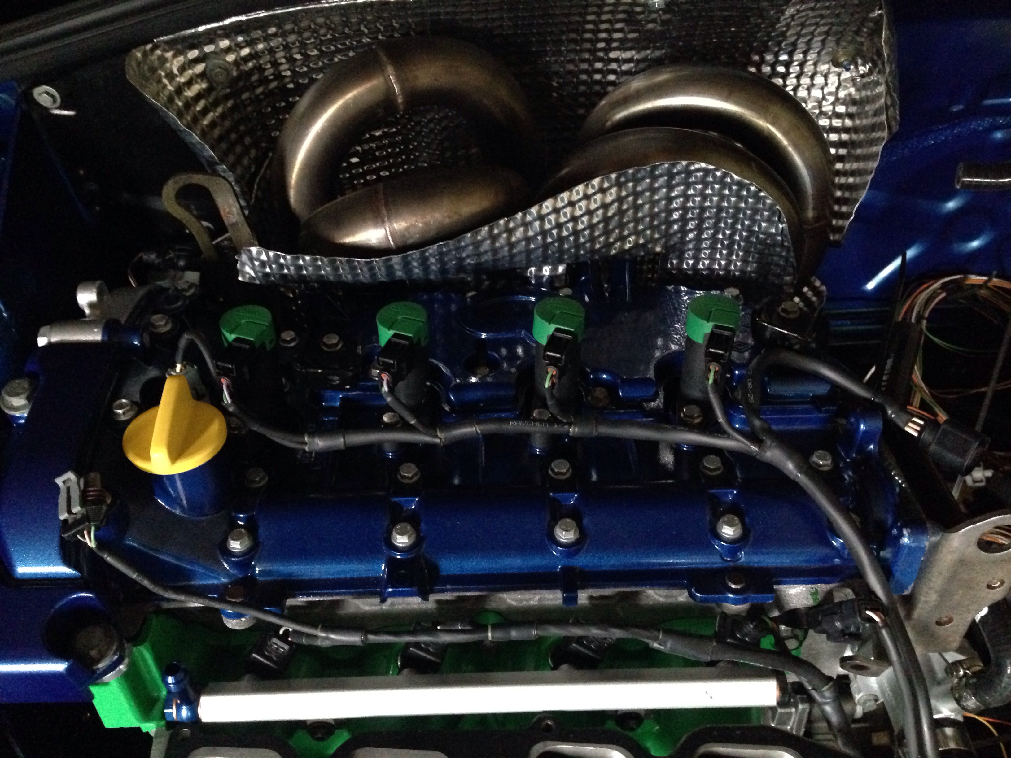

Looks great, those PMS manifolds really do look great!
By not cheap do you have a link to the heat shrink just to see?
More to come. :up:
I need to tidy up my r26 loom, when we pulled the engine out yesterday my OCD had a melt down.... Beyond tatty.
I was looking at some of the Raychem products to sleeve / seal the loom... I think that's what you've used?
Don't suppose you know a decent UK supplier? :smile:
Yeah it's dr25 raychem that I've used mate. Be warned, if you choose this option you will have to strip the loom entirely and de-plug it to get the heat shrink over the loom.
Do a search for Hudson Wiring mate. You can buy off them by the mtr.

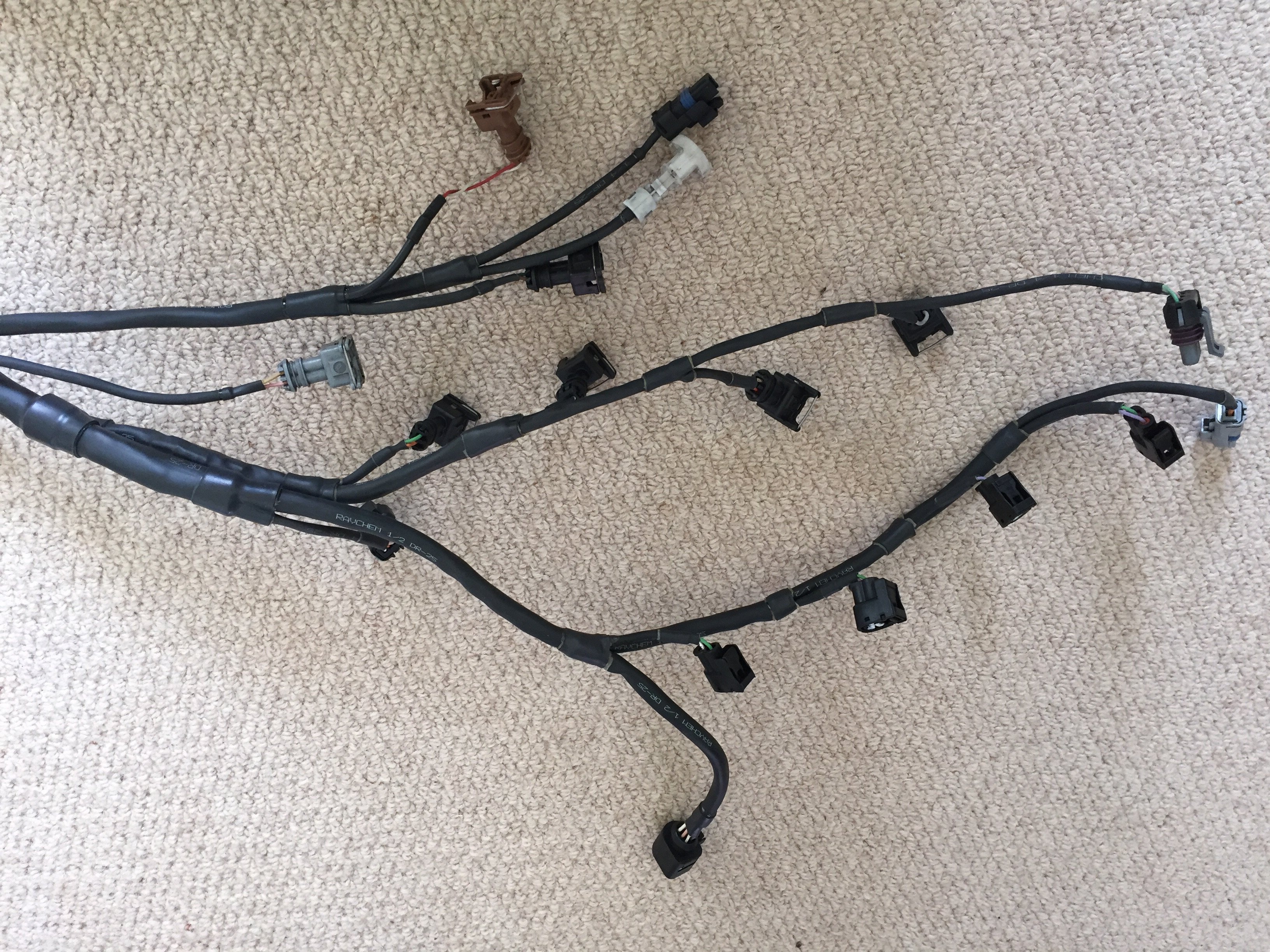

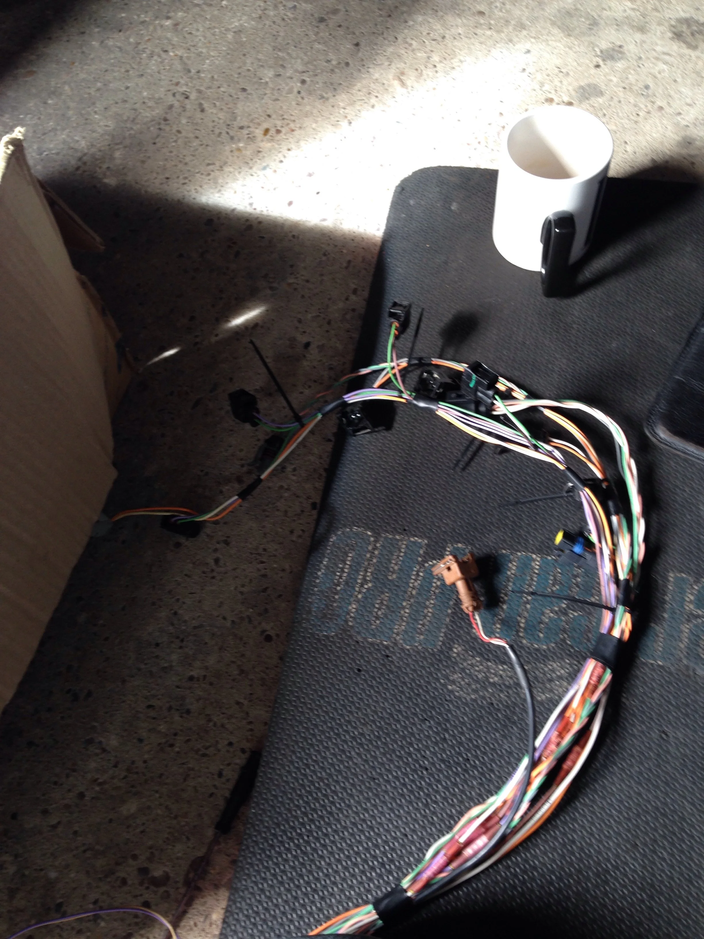

Little bit more done over the weekend. It's a real case of slowly slowly catchy monkey currently as I'm only getting an hour or so at a time.
What your looking at here is the loom for the alternator charging signal, oil pressure switch, oil level sensor, air temp sensor and the knock sensor. Not sure if the knock sensor will be required, but it's easier to have it in place and not required than to have to run it in afterwards.
Ok, so who's getting bored of me posting wiring loom pics? Lol! Really starting to come together now as you can see below. All that's left to sort is the coolant temp sensor, crank sensor, lambda sensor wiring, speedo drive sensor wiring and re-pin the new stuff that's going into the ecu. Theres a few splices to put in here and there as well, alongside retaining the original coil pack wiring and plug.
It just makes sense to retain this as if the coil on plug setup becomes unreliable and troublesome, all I'll have to do is make a strategic cut into 1 wire and remove 2 pins in the ecu plug. Done.

Lol! I don't mind looking it over mate at all, but keep in mind you'll be spending about £160-£170 just in raychem!
