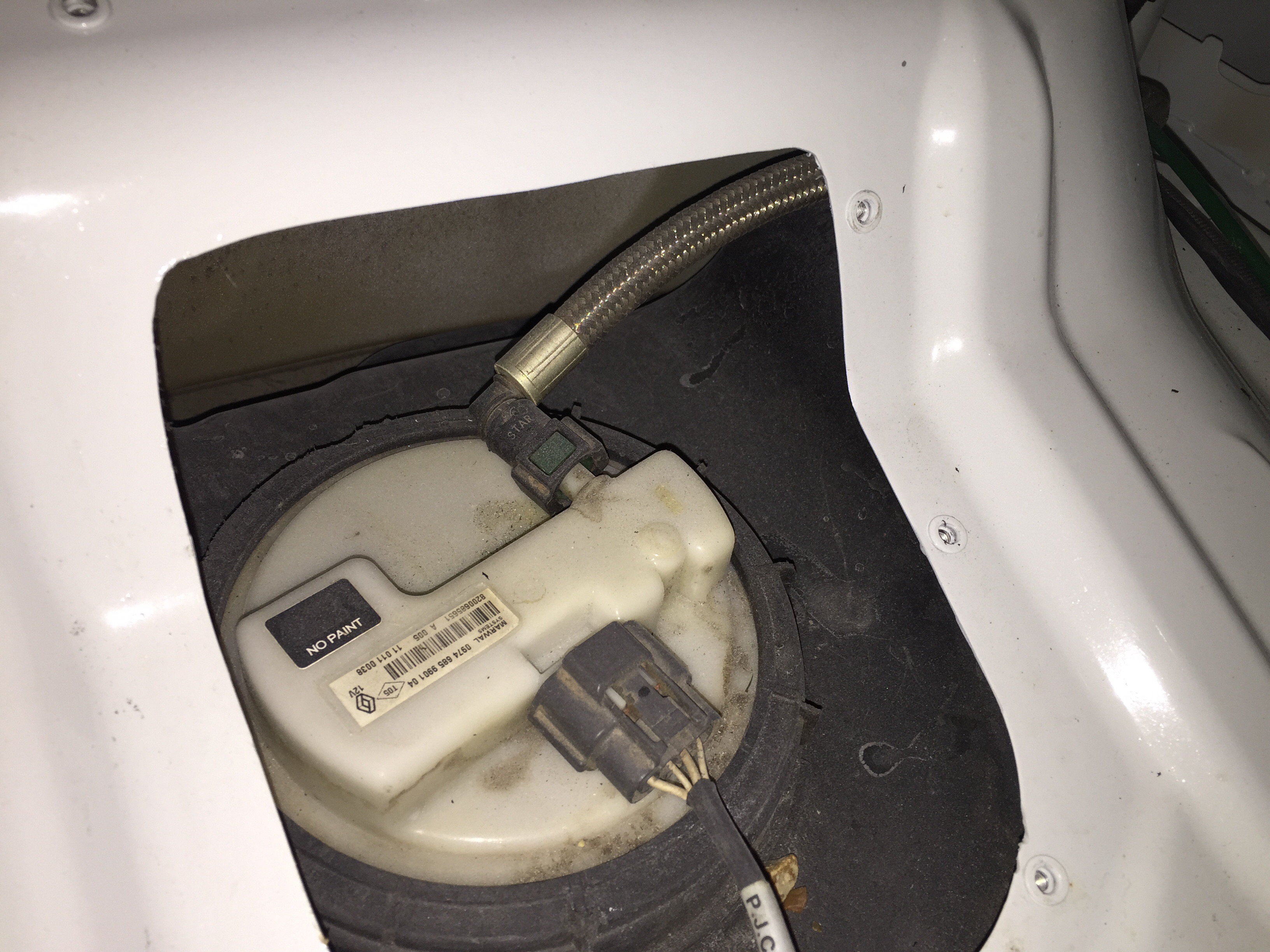

I just read it back and thought oops everyones going to think im crazy with that comment [emoji23] ... yeah the outlet on the pump doesn't even have any barbs so could have easily slid off.. im surprised the fuel pressure didnt just blow it off.. theres the risk of overtightening it too and crushing the plastic outlet causing a leak
Safe to say, dont do it that way

I assumed the typo option mate, so your safe. Regards crushing the plastic, you'd have to be one heavy handed fucker to crush it I reckon.
This is how renaultsport do the cup racers for reference:
This is a 200 cup racer setup ^^^

This is how renaultsport do the cup racers for reference:View attachment 134990This is a 200 cup racer setup ^^^
I was going to say thats how I'd do it.. most road car fuel pumps have the same plastic outlet design and they usually use the standard push on clips.. We had the same connector inside the tank to the pump on our GT3 cars too

That's how I was going to do mine as well tbh, but I just thought I'd give the adapters a try. The aeromotive quick connect adapters don't work with the renaults mate as there's not enough length on the outlet pipe. If the ring that it clips on to was further down the pipe and not so close to the body of the fuel pump housing/fuel rail they'd fit straight on. Inconsiderate s***s. Lol

Thats the same as the x65 Mark. Just a regular 90° fitting with a ferrule to crimp it on.

I used the standard pump connector. I removed the plastic fuel line and replaced it with a braided line, secured with a mikalor(sp?) clamp.
Its been fine so far
