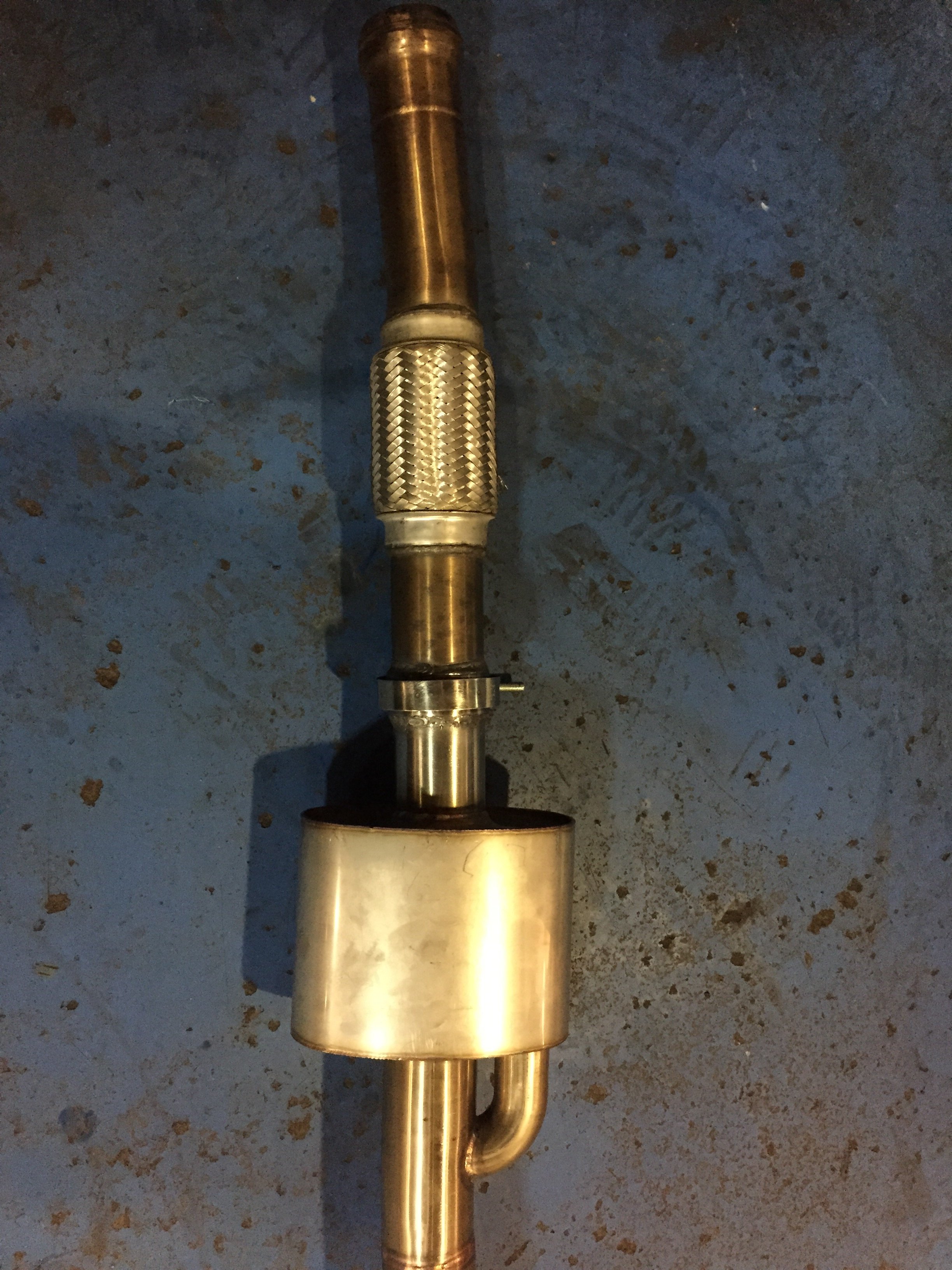

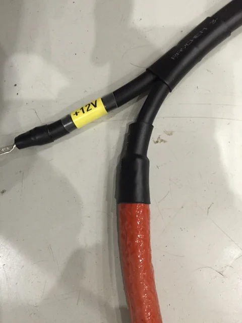

So another little update. Had a day off the wiring and decided to get the pms decat modified to connect up to the Btb prototype centre section I'll be using.
The preferred method was to v band the connection, so a 2.5" v band flange and clamp was sourced.
Did a bit measure twice, cut once, and took it to work to weld it all up. It almost seemed a travesty to mig weld it as the tig welding on the Btb centre section is first class!
Back to the loom again now to try and get it finished. It's about 90% complete, so not far off.

Please explain the extra tube going from the box into the tube?
It's just a resonator pipe mate. To give the exhaust system a bit more noise and make it more performance biased there's no perforated tube in the middle box. It looks to solely rely on the small pipe transferring some of the noise.
It's also reduced the weight of the exhaust system substantially as the original centre box is quite large.

no perforated pipe?, just a box with a tube out each end, or some damping material in there?

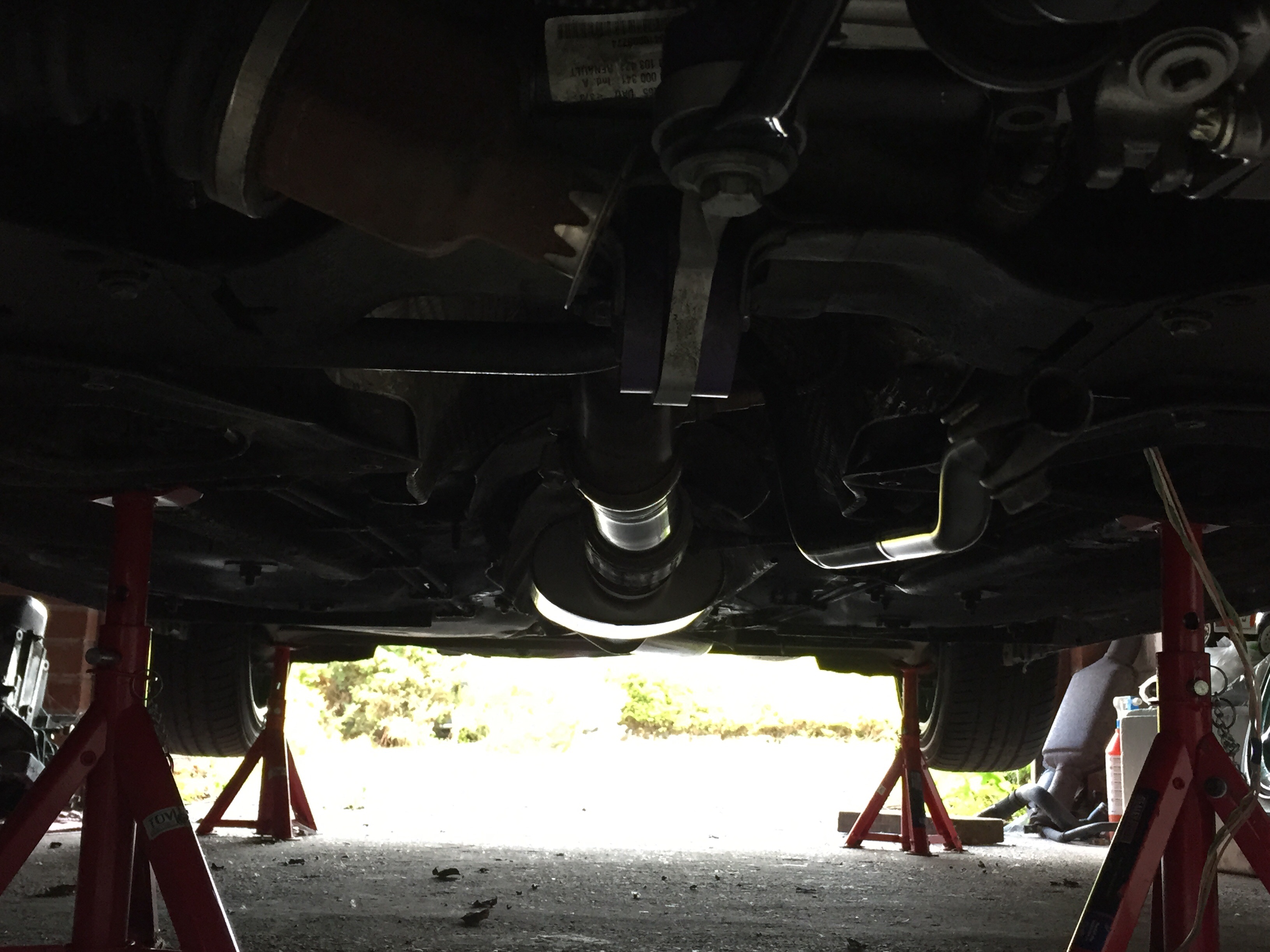

Yet another small update! The exhaust system is now all fitted. The driveshafts are fitted and the bottom uniball holders are tight and the gear linkage is on and adjusted up.
All that's left to do is the fuel line (fandango adapters sorted), breather from the air box to cam cover and finish off the loom. Then it's just a case of fill it all up with fluids (not bodily ones), upload the start up map and turn the key.................:cool:

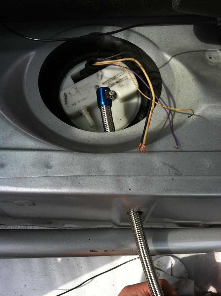

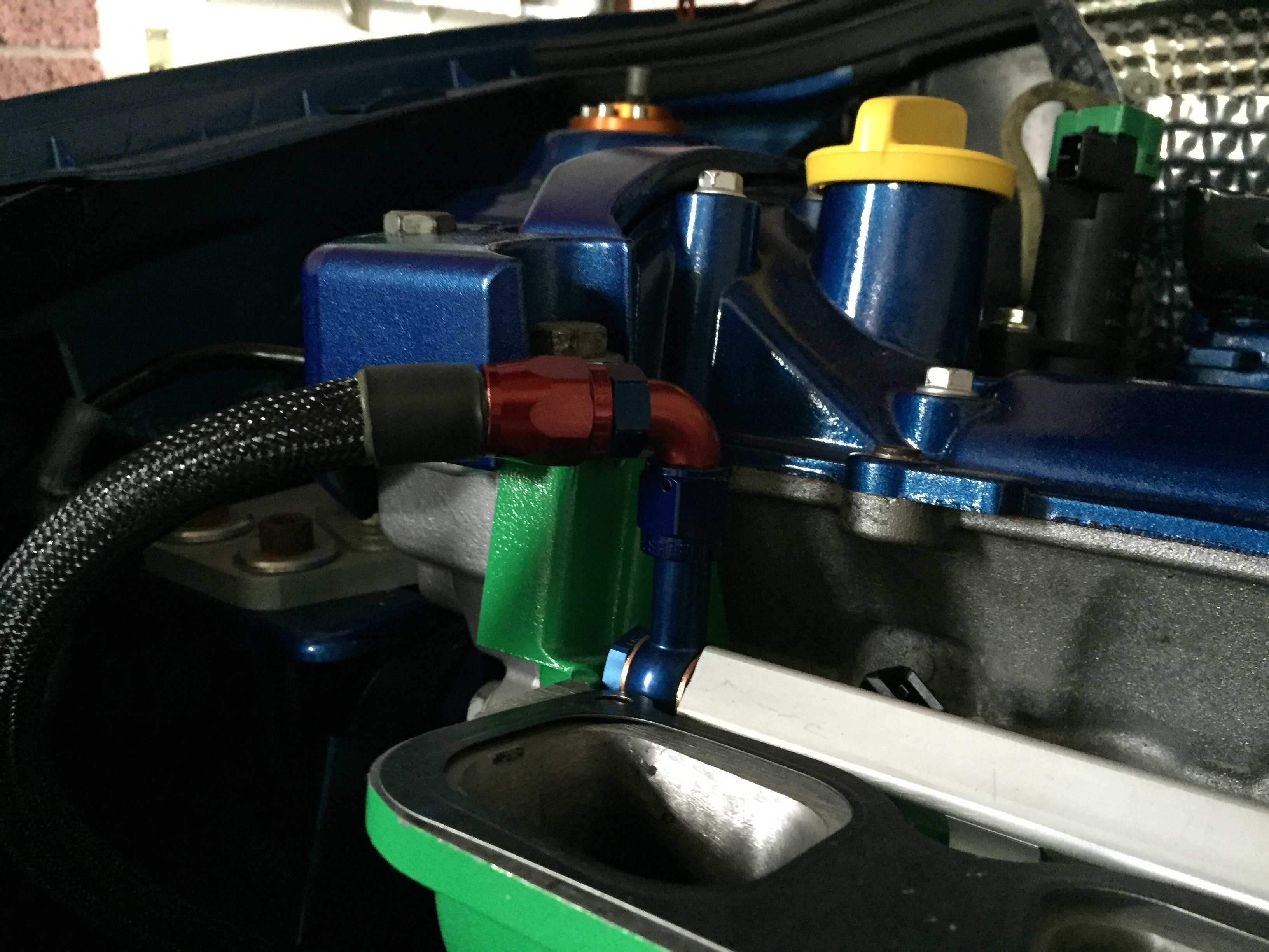

Fuel line made and fitted. Fandango adapters didn't work, so I modified them to work. :up:
I've covered the stainless braided fuel line in black nylon overbraid because it looked s**t under the bonnet imo!
Modified adapter:
Next week will see the loom finished off and making a start of refitting the upper inlet/air box.
More to come!

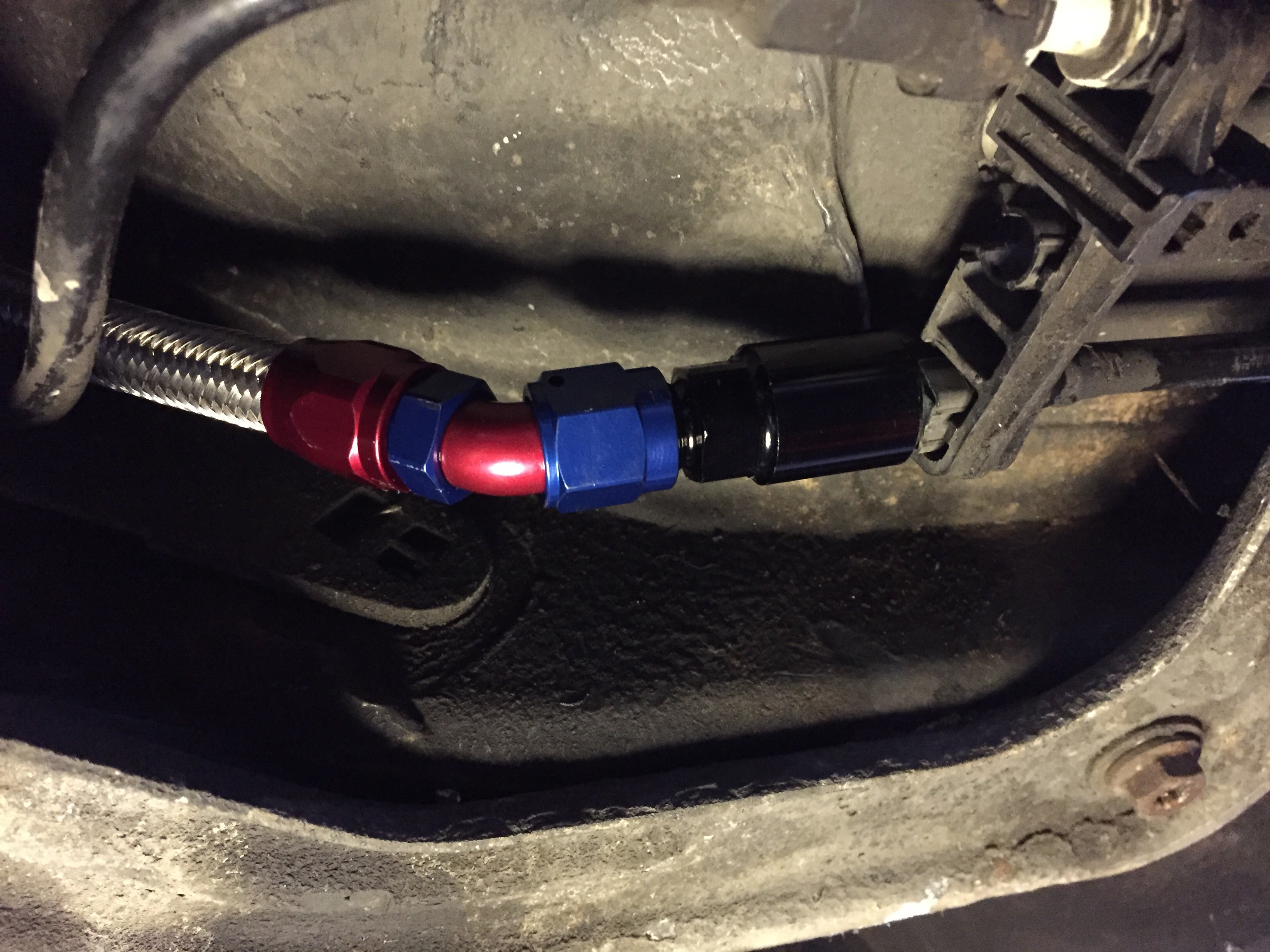

Fuel line looks great, easy enough to do? Could it essentially run through the car and in to the pump that way as well?
Yeah relatively straight forward mate. Are you wanting to run the stainless braided line in the car? If you do then the problem comes with connecting up to the pump with the adapters as they won't work. I modified mine to work at that particular point.
Rubicon_
  L110, RS6, Westfield

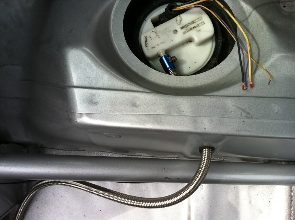

I see, I remember Chrispy doing it with his ill need to look at how he joined it to the pump. You don't have a link for the fuel rail do you mate?
Hey.. Chrispy is a mate of mine, and yeah he did.. this was his setup....
Yeah you see I didn't want to use jubile clips. The cup racers retained the oe clip on fitting with the stainless braided line crimped on and secured with a ferrule.
Ridiculous isn't it! You can't even see them when they're installed! Lol but it had to be jic fittings or factory look.

I forgot about the fuel line photo. Will try remember for tomorrow sorry mate.
Is that fuel line on the pump union just secured with a hose tidy jubilee clip?
Cheers Paul! Yeah been cracking on fairly well mate. The momentum will remain now as well.
No worries on the fuel line pic mate, I've got sorted out with the fitting in the last update I did, but I know I can copy the cup racer set up if I need to.
Yeah that fuel lines secured with a hose tidy jubilee clip mate.
