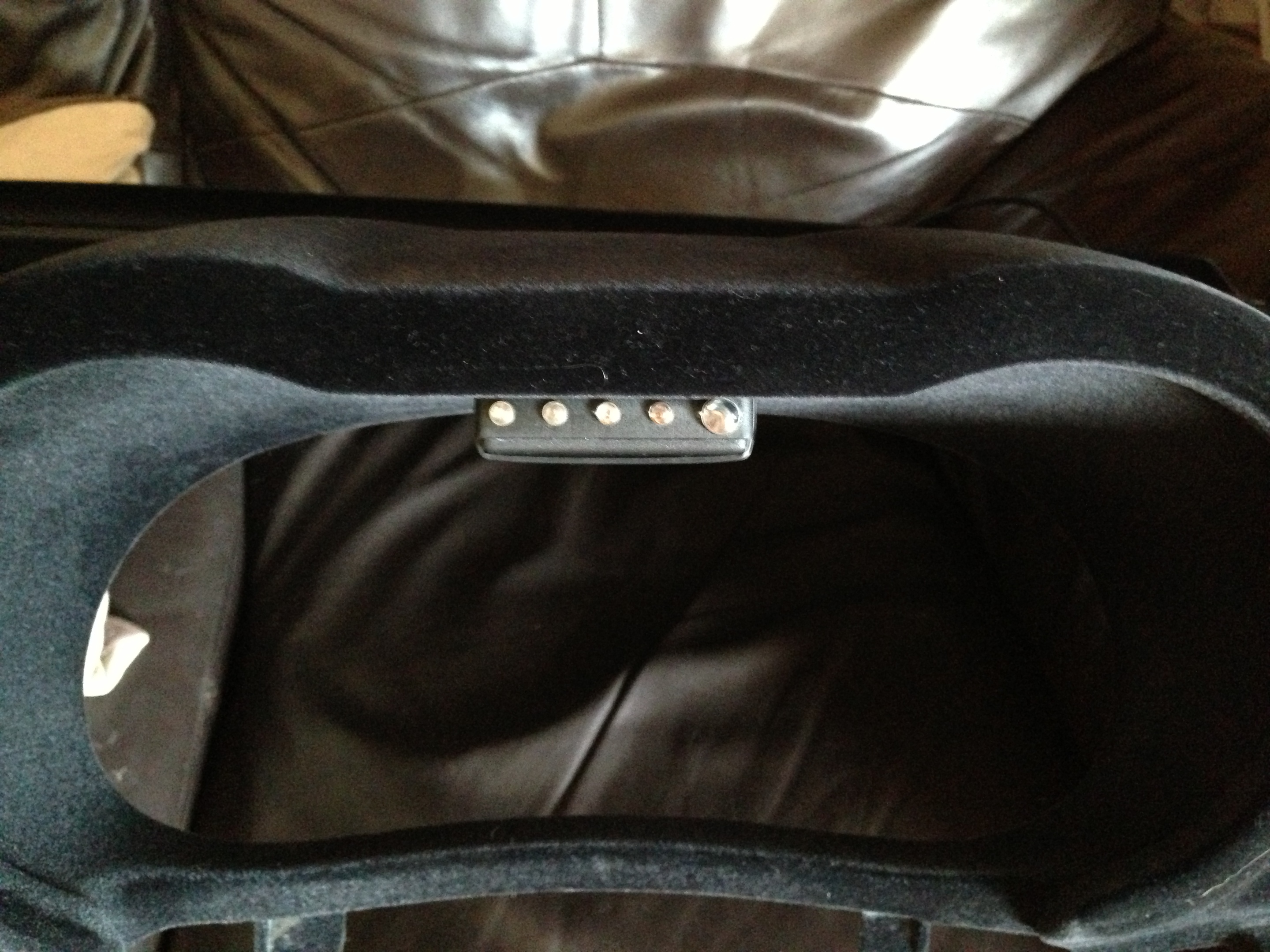

Small update. Seeing as Mrs northloopcup hasn't been feeling to chipper of late, no progress has been made. She's on the mend now so I saw the opportunity to make a purchase!
I've ordered one of these:
I've ordered a black faced gauge ^ that's just for illustration purposes!

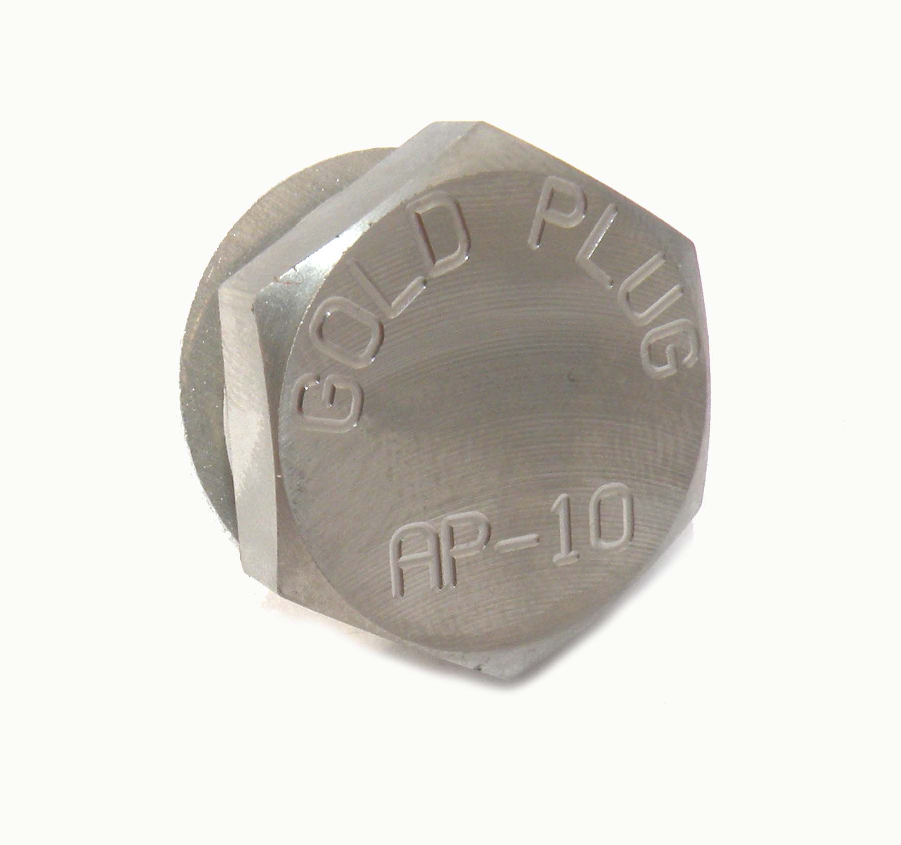

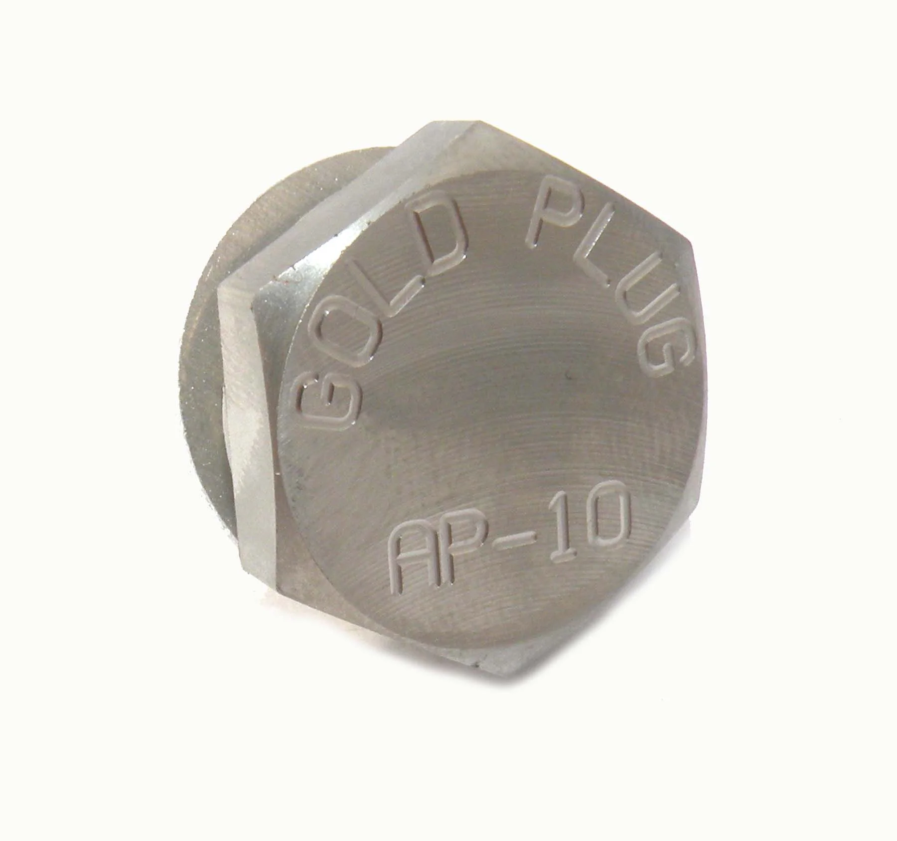

I've also ordered one of these:

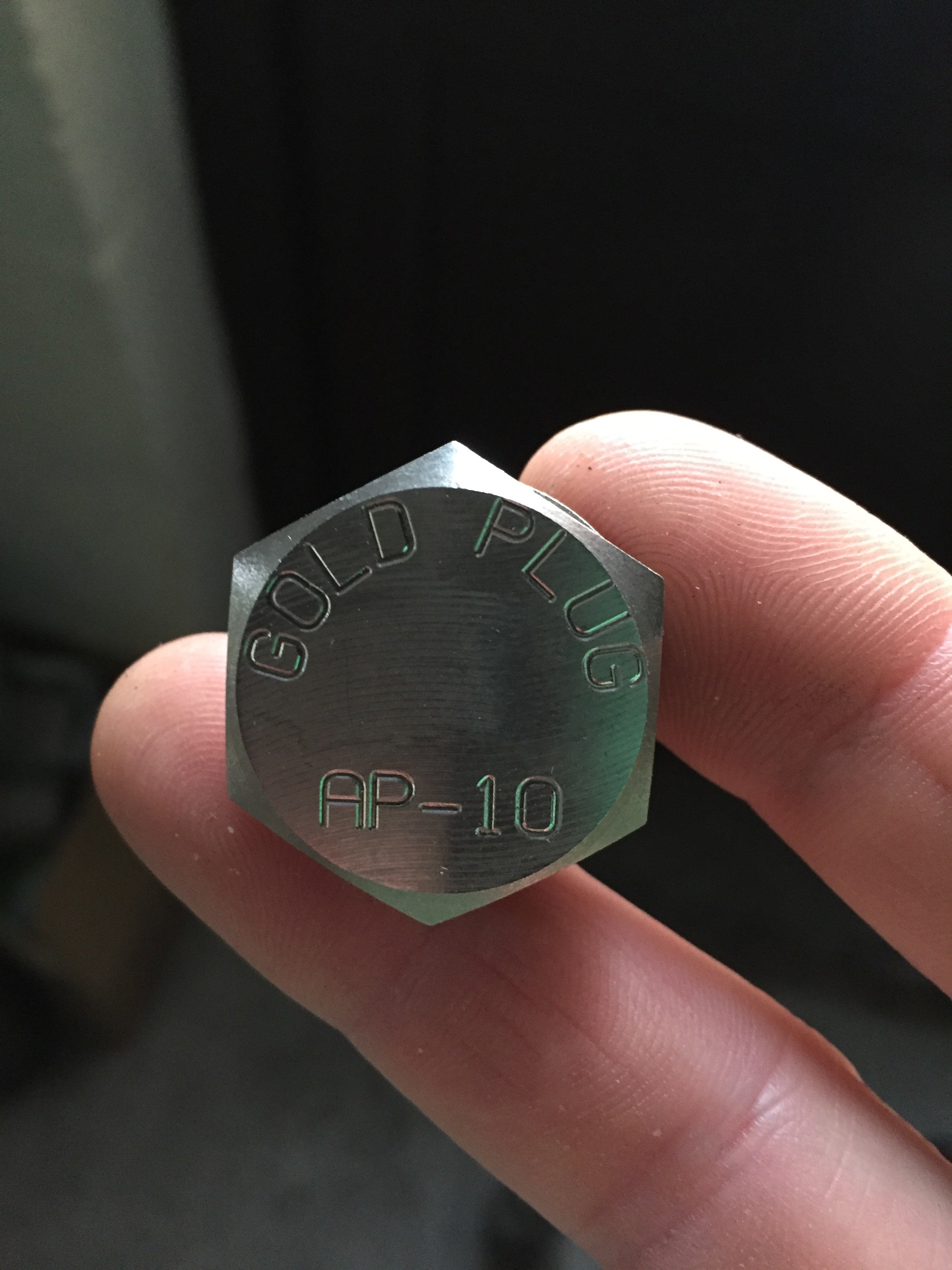

For those of you that don't know what it is, it's a magnetic sump plug. The magnets in these bad boys are stupidly strong, so they'll pick up all metallic particles in the oil. Probably should've bought one for the gearbox as well. Meh.

What spec Gold Plug did you get? Renault doesn't appear on their website.
EDIT: I see ''AP10'' refers to a specific plug. Is that the actual size to get?

I also bought one then realised I should've got two! I was too focused on sorting the postage! 😞
@NorthloopCup I've got the same SPA gauge, yet to fit it or even plan to yet though! Will you be using a thermostatic sandwich plate for the readings?
where did you get the gold plug from please also? Just reminded me I need to order one myself for when I do an oil change.
Have you got one for the Gearbox too?

I've got a set of SPA oil temp / oil pressure, boost pressure / water temp gauges to fit aswell :)

The sensors will be going into my take off plate, but it's not thermostatic. I don't need a thermostatic one with me running the laminova. The pressure sensor won't be hard mounted directly into the plate though as it can lead to premature failure of the sensor itself.
The gold plug came from opie oils mate. I never bothered with one for the gearbox mate. Wouldn't be a bad idea to fit one, but the big magnet in my gearbox was immaculately clean when the box was rebuilt, so it should pick up the majority of stuff.

I'll be using the external led driver function more than the gauge itself mate tbh. Unless the gauge is directly within your line of sight, you never look at them until it's too late. Same principle for the shift light - it's in direct line of sight
Just got to decide where to put the leds. I know the gauge has warning lights, but I need to see how bright they are first.
I'd happily pay for one of those plugs just to be rid of the stupid square drive! Will order one when I next get oil from Opie, cheers for the heads up.

Any idea if megane dci175 are same plug before I do a change soon..

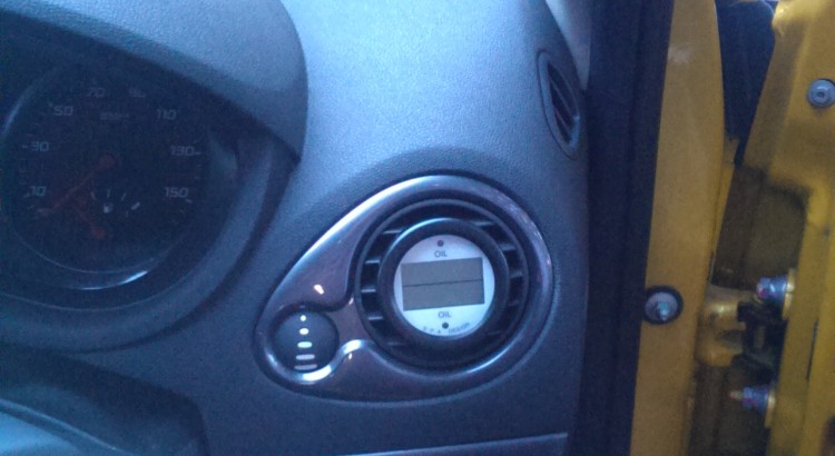

Are you going to fit the gauge in the centre vent?
I thought about moving mine at the weekend, sat in the car looked at it and thought sod it can not be arsed lol.
I would not mind remote mounting my pressure sensor.
Do you know where you will be getting the fittings and pipe from, I struggled to find the correct fittings.
I think so, but not sure atm. Need to see how it looks first. Tbh, it can sit in the glove box for me if the led drivers do the biz! I'm only interested in low oil pressure, so an idiot light is enough for me! Lol!
I'll be remote mounting mine the same way that @rich83 has done his mate. Having read the fitting instructions online, it does say you can use npt fittings with a bsp thread, so I'm going with it.
There's no fittings available that are the correct items unless you get something custom made.

Good idea to remote mount, ignoring the practical benefits - aeroquip in the bay is always a win!! ;) Thread fit's like a charm though and no leaking at all since it was fitted last April. The only place I had to deviate was on the sensor fitment itself; a 1/8 NPT male to -4 JIC for the sandwhich plate is easy to find an adaptor for, it was just the -4 JIC male to 1/8 BSP female not so! Like it says though in the SPA manual the thread is fine for using in an NPT female and has proven to be so - note we used some ptfe and the dowty washer that comes with the sensor.
Got the gauge installed now too at long last! :) Though I assume the mk2 probably has different shape vent so maybe not as easy to put there?

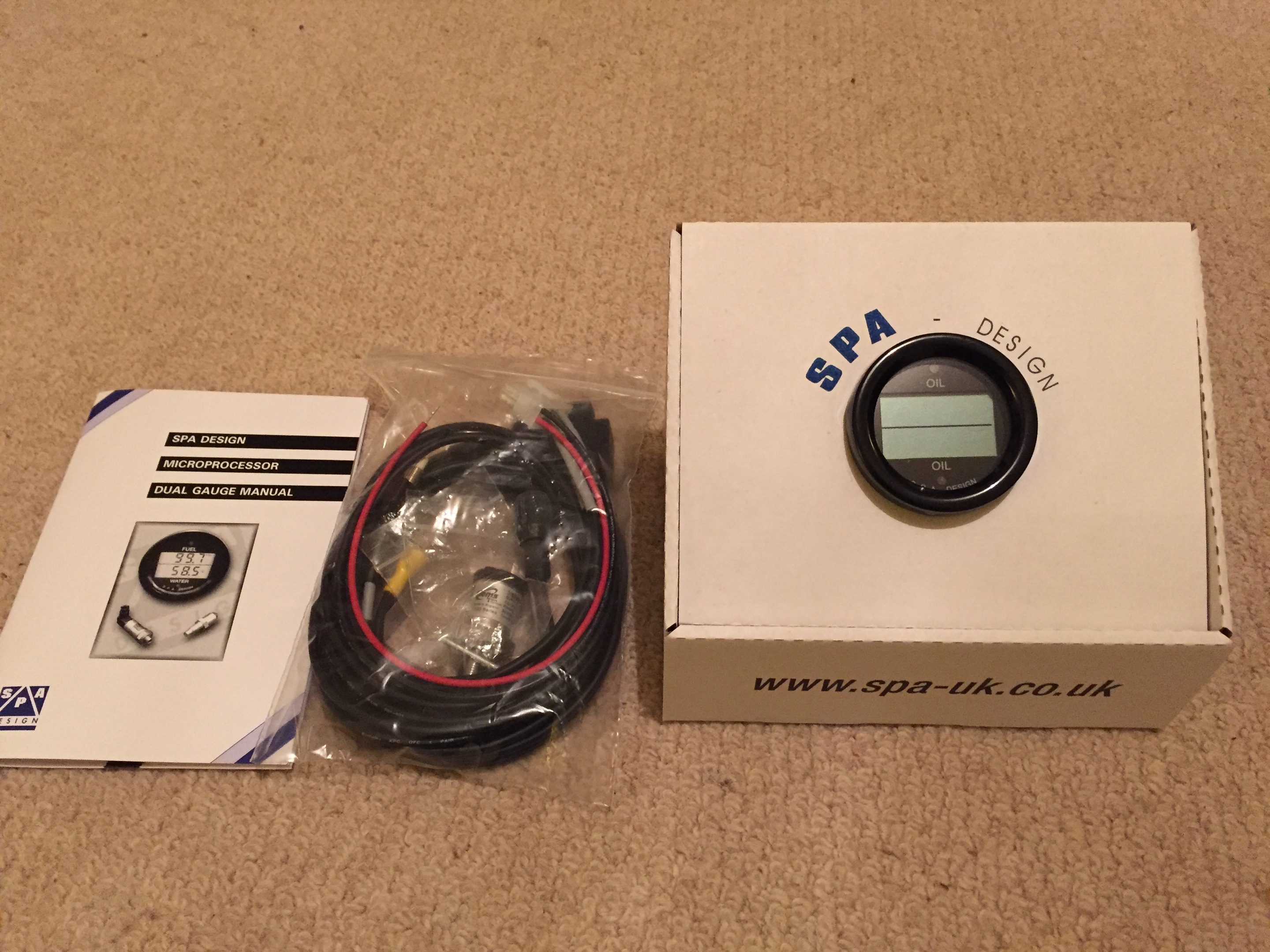

Not really an update, but this has arrived:
along with this:
Still not decided 100% where I'm fitting it at the minute. As long as I can see what the oil pressure is doing when I start it up for the first time I'm not too fussed! Lol!
It turns out that Spa Automotive are literally less than 10 minutes away from where I live, so today I went over to pick up some terminals for the plug so I can run my external idiot lights, sorry, led warning lights!!

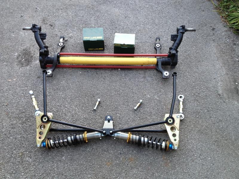

Had a good long chat with the guy there about how to mount the sensor to reduce the risk of premature failure and a few other things. The other thing being Penske suspension. They can basically do anything I want for the cup!! This could well mean waving ta ta to the asts. Cost is what it is, so we shall see what the future holds!

I spoke to the one bloke at SPA when I thought my gauge was faulty and he was really helpful and replying to emails at 8 pm, he was even going to stop a bit later one night so I could take my car over to him to have a look at the issue and test the gauge.
:up: customer service, don't get that with cheap ebay stuff.
NorthloopCup
Yeah totally agree mate! I emailed yesterday when the gauge turned up and they'd replied this morning!
