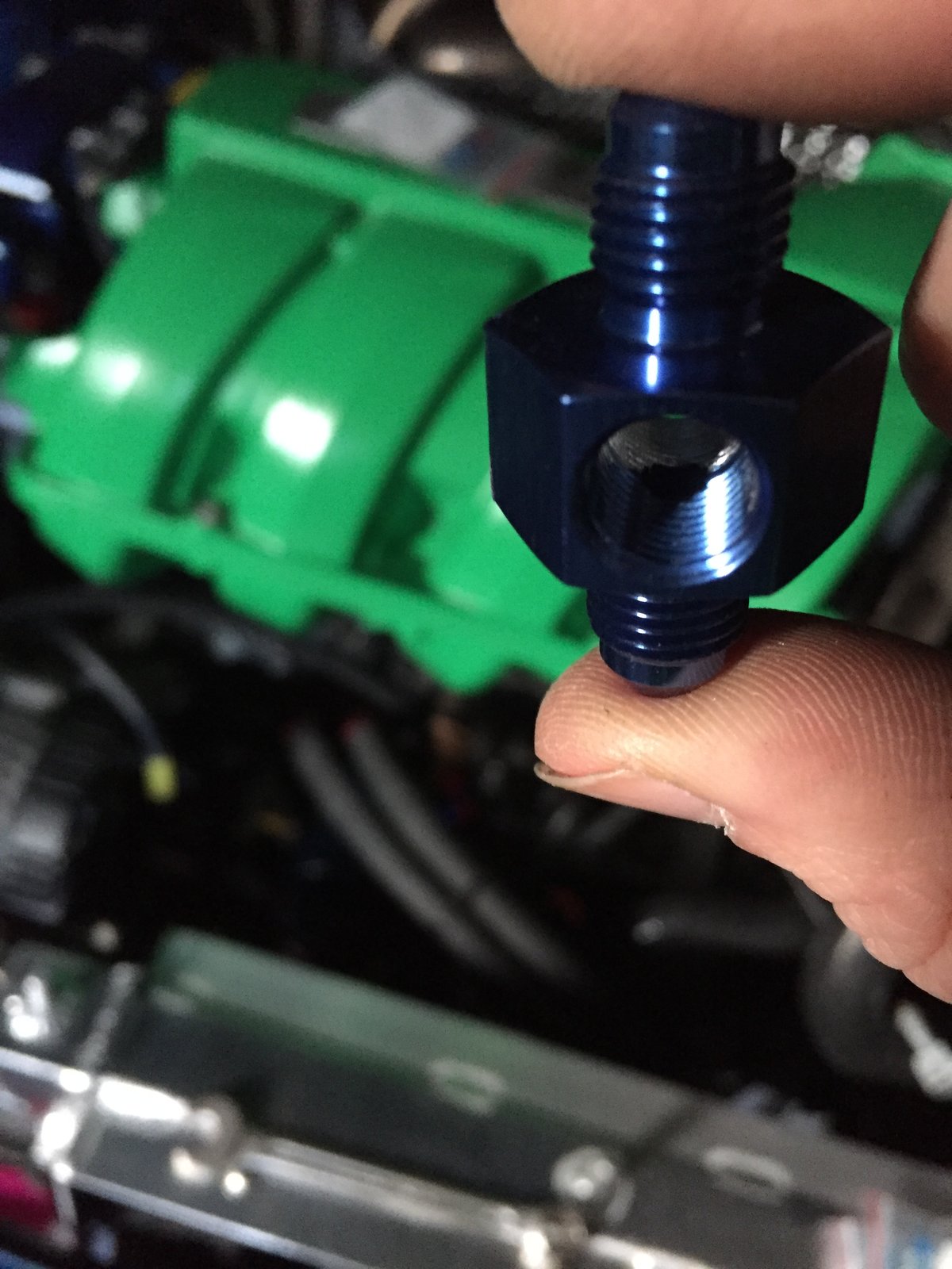

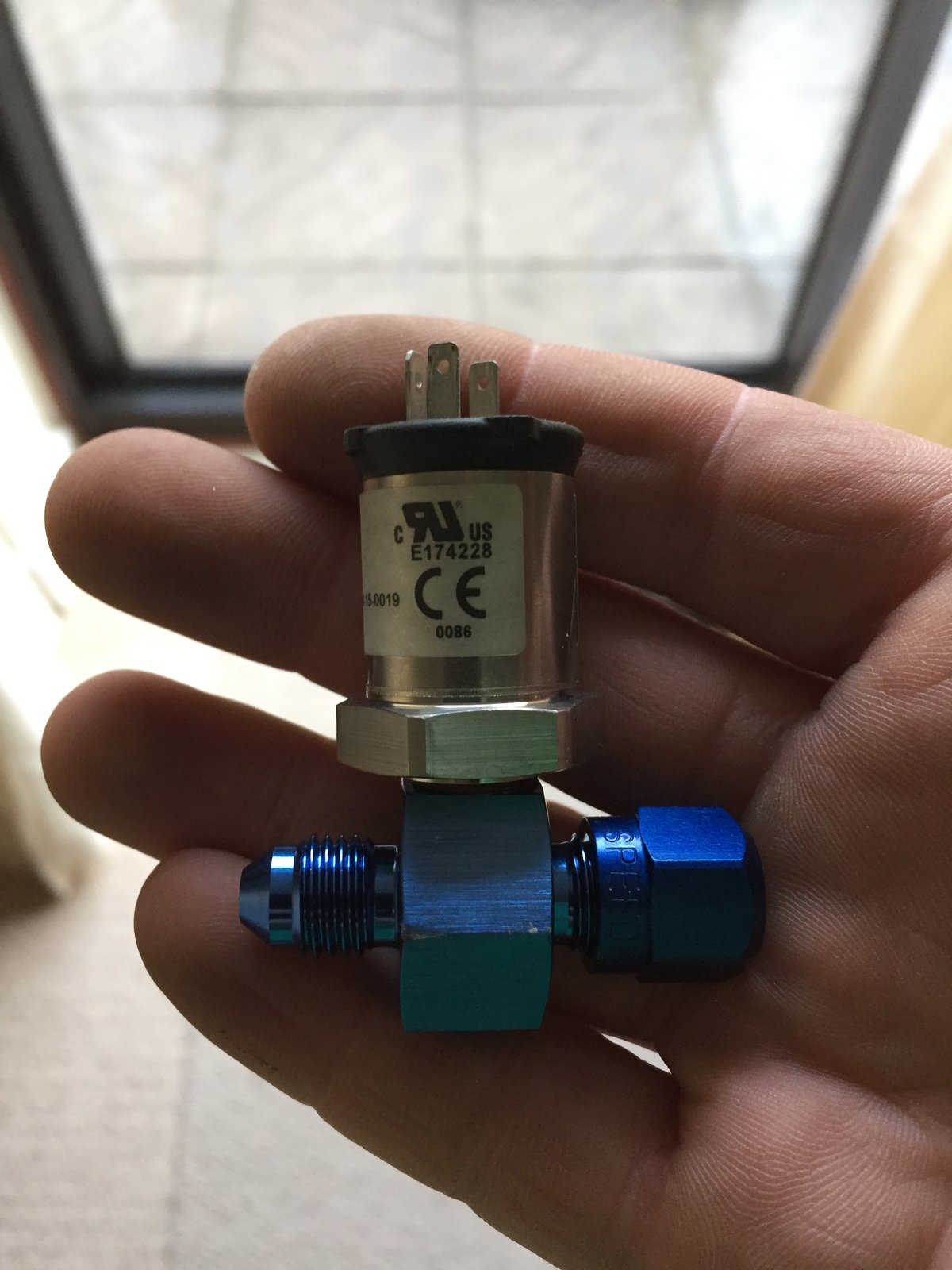

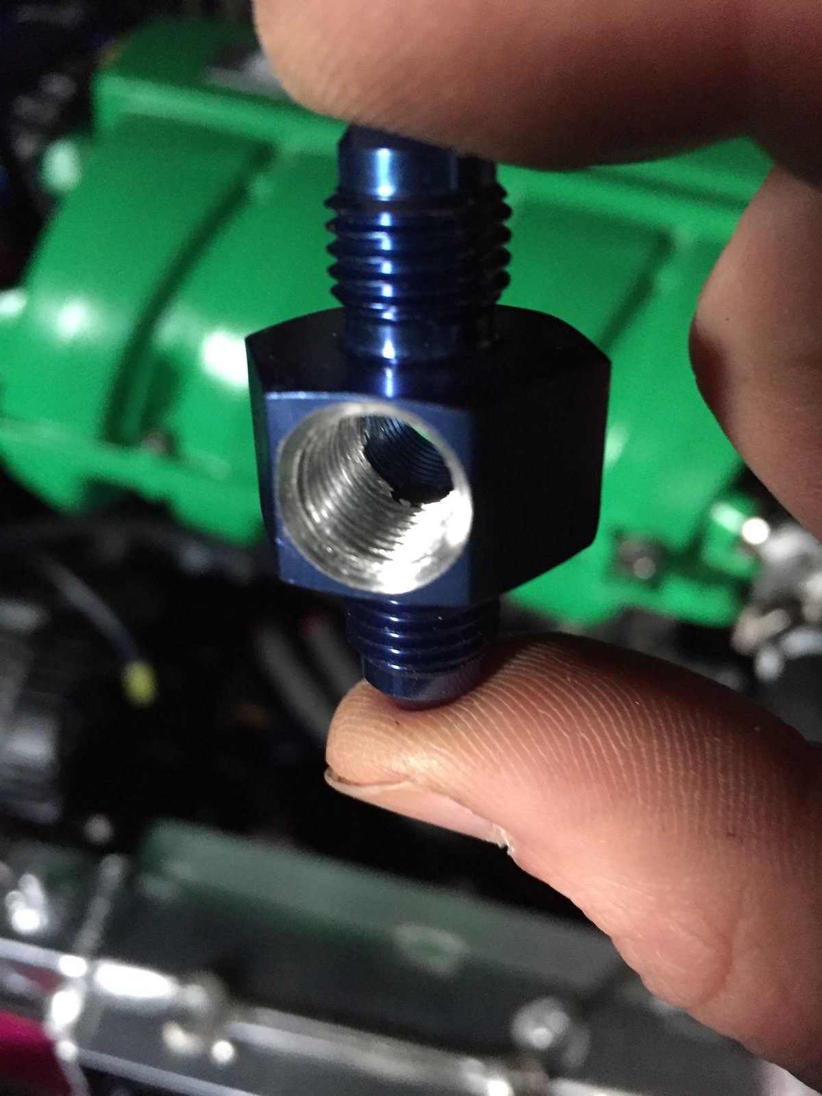

Ok so fittings arrived today so I made a start on installation and modification.
@M.C.. this is where you may be interested in what I've done. I spoke with Faye at speedflow for a solution to the 1/8bsp oil pressure sensor thread. I explained what I'd got and what my thoughts were, and she offered what I think is a better solution! She recommended a male-male -4 fitting with a 1/8npt fitting.
I then drilled all the way through to the opposite side and tapped it out to 1/8bsp:
This has to have a chamfer put in at the top to allow the 'o' ring to locate and not be squashed out when the sender is fitted. I put a 1/8npt bung in the now redundant npt thread and fitted a -4 blanking on the end of the male-male fitting:
Like a glove. That's how it fits! :up:
Made a start on making up the oil line for the sender. Just a case of deciding where to mount it tbh.
Not sure where though atm, as ideally it needs to be mounted to the chassis, but I'm pretty confident that I can mount it to the engine with a rubber lined p clip as this will remove a lot of the vibration that the sender would see.
More to come. :cool:

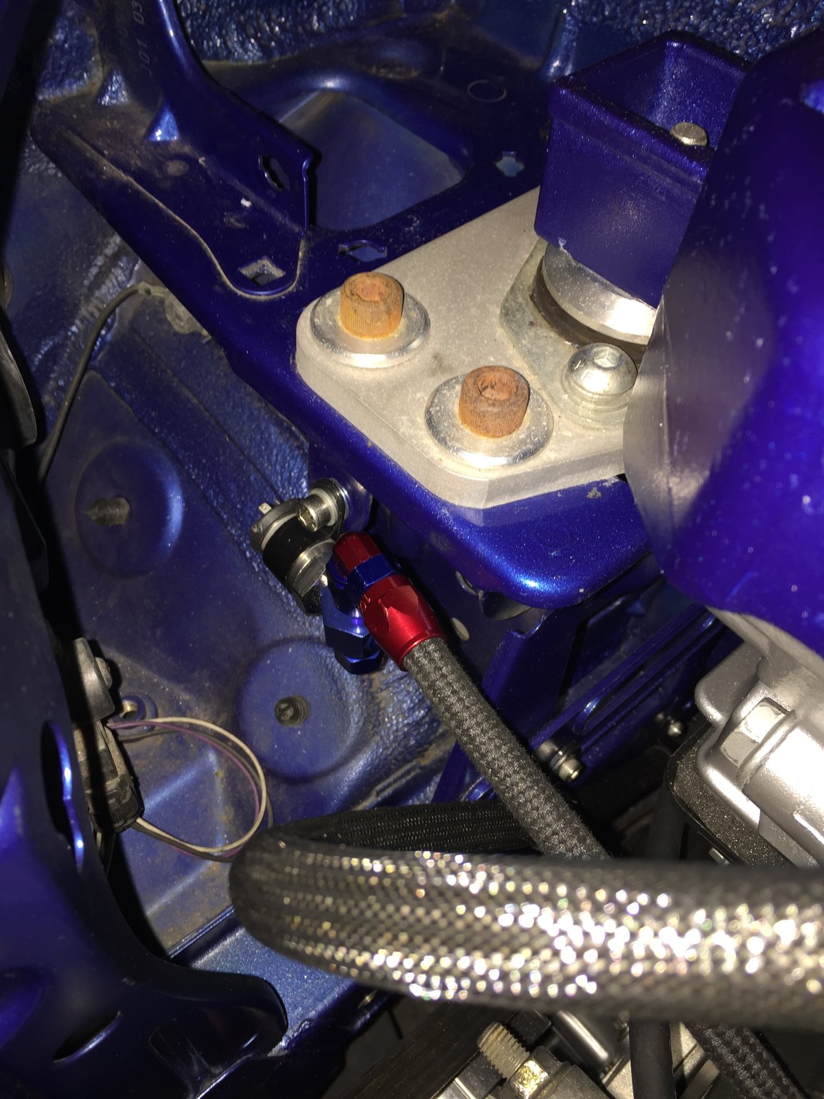

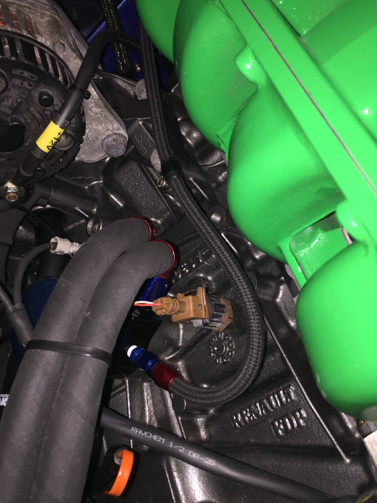

Had another few minutes spare this afternoon so I finished the oil pressure sensor plumbing today.
I opted to mount the sensor over on the o/s inner wing. Should hopefully be reasonably vibration free.

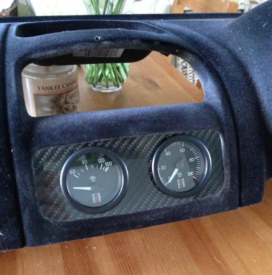

Next on the agenda will be where to mount the gauge. If anyone has any suggestions I'm all ears! I offered it up to the air vents in the centre of the dash and tbh, it looked w**k. Anyone got any thoughts?

Had another few minutes spare this afternoon so I finished the oil pressure sensor plumbing today. View attachment 148845View attachment 148846 I opted to mount the sensor over on the o/s inner wing. Should hopefully be reasonably vibration free.

I'e get a large P clip or similar round the actual hose there mate, I've seen these alloy fittings fatigue fracture, or the threaded section on the sensor break off in similar circumstances.

I was thinking of having my gauges somewhere like this:
Thought it looked ok?
The gear oil is redline MTL mate. There's about £50-£60 quids worth in the box! 😢
Yeah that looks ok, but I've got a dual gauge, so I'd either lose 1 vent or be left with it looking like there's a bit forgotten about if you get me?
Thanks for the suggestion. Which picture are you relating to though mate? The hose is secured with a nylon p clip on to the alternator bracket, but not sure if it's all that visible.
Hi mate,
This one:
You've got the sensor securely fitted to the shell and all the relative movement from the engine, transmitted down a relatively stiff hose is taken by the thread on the sensor itself, and the alloy adaptor hanging off it.
It will probably be fine, but for the sake of an extra clip I'd be making sure, a mates rally car snapped a sensor thread off and emptied the oil all over the ground the year before last.

Hi mate,
This one:
Ah yeah I get ya now. Tbf mate, the pipe is the aeroquip startlite and it's extremely flexible! It's got a lot of strength, buts not as rigid as the braided stuff is.
I'll definitely look at fitting an addition clip though if I can. :up:
