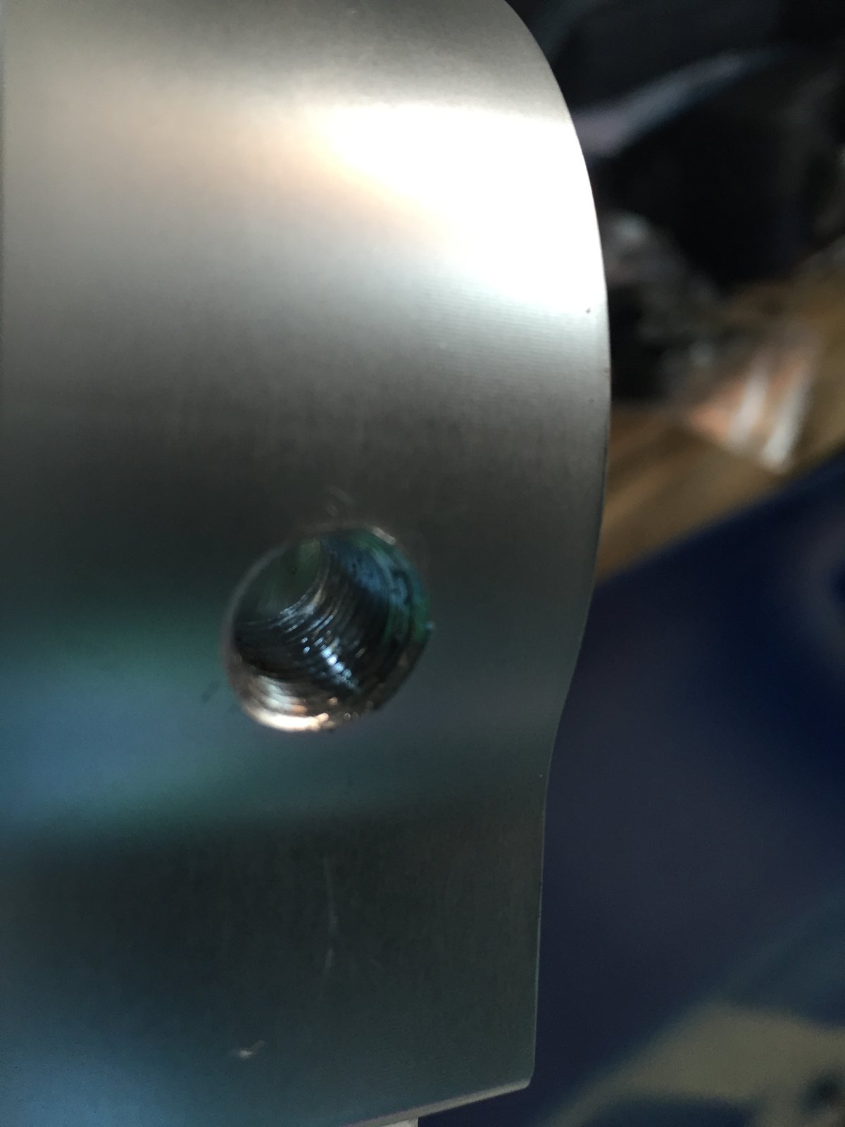

Had a bit of spare time on Tuesday, so thought I'd make a start on fitting the oil temp sensor into the oil cooler sandwich plate. I went to remove the 1/8 npt blanking plugs and disaster struck. One of them was in so tight that it rounded out the bung! This meant stripping down and removing the take off plate so I could remove the plug. Easy enough to remove you'd think, but oh f**king no!! Stud extractor was laughed at as the bung itself was aluminium.
I decided the best thing to do was to just order a new one which arrived today. I now have a black one!
Today I had another look at the old one to see if it could actually be saved. Managed to attack it with a small electricians screwdriver and a hammer to see if I could remove the remains. Success!! Ffs.
Ran the npt tap I've got down it to clean the threads up and she's now a beaut. Typical.
Moral of the story? Don't be so imaptient until you know it's 100% fucked. I'll be putting this up for sale shortly. Lol! No need for 2!!

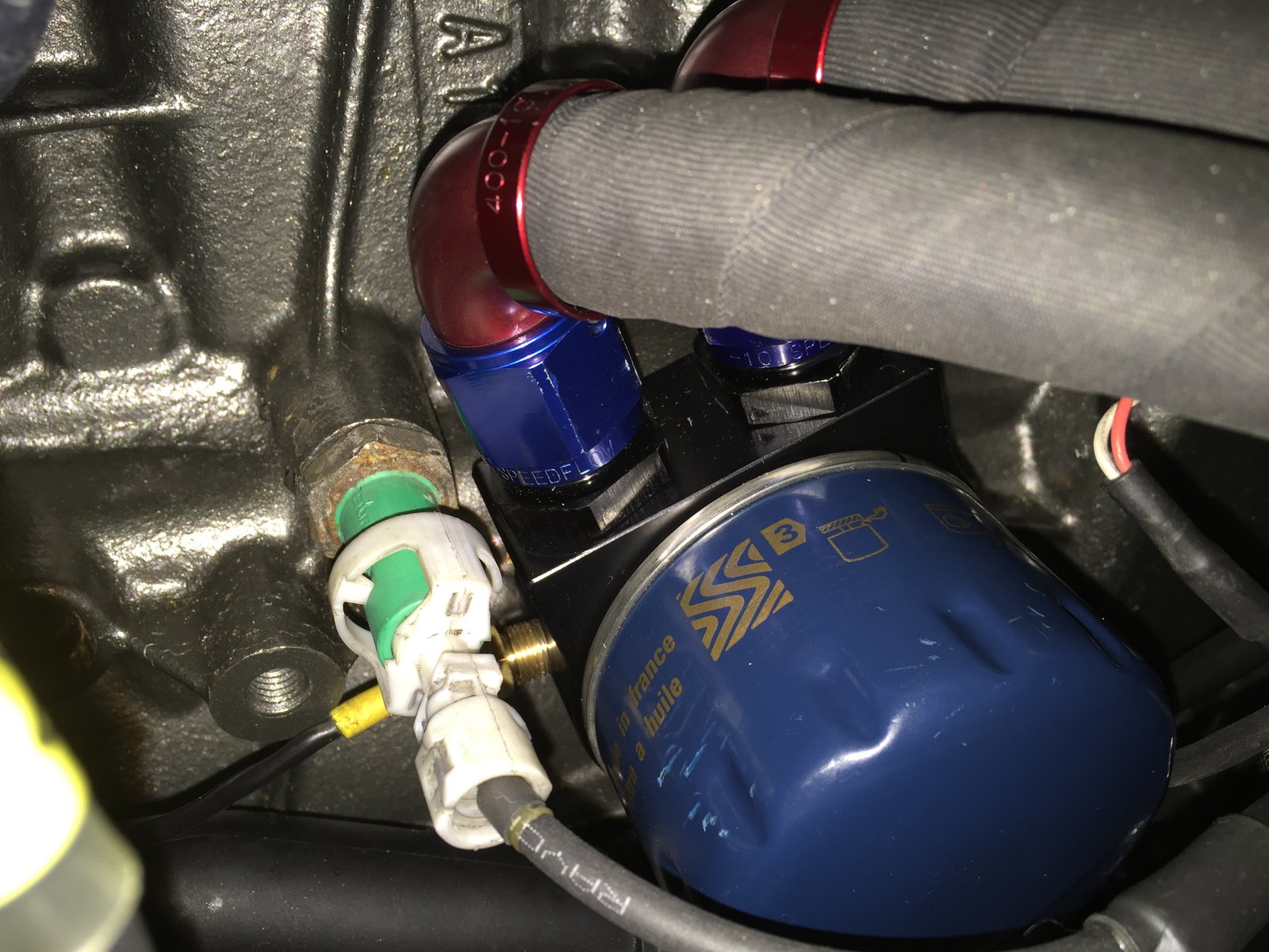

This arrived today as well
so thats another job ticked off the list. Ordering fittings for the oil pressure gauge tomorrow.
