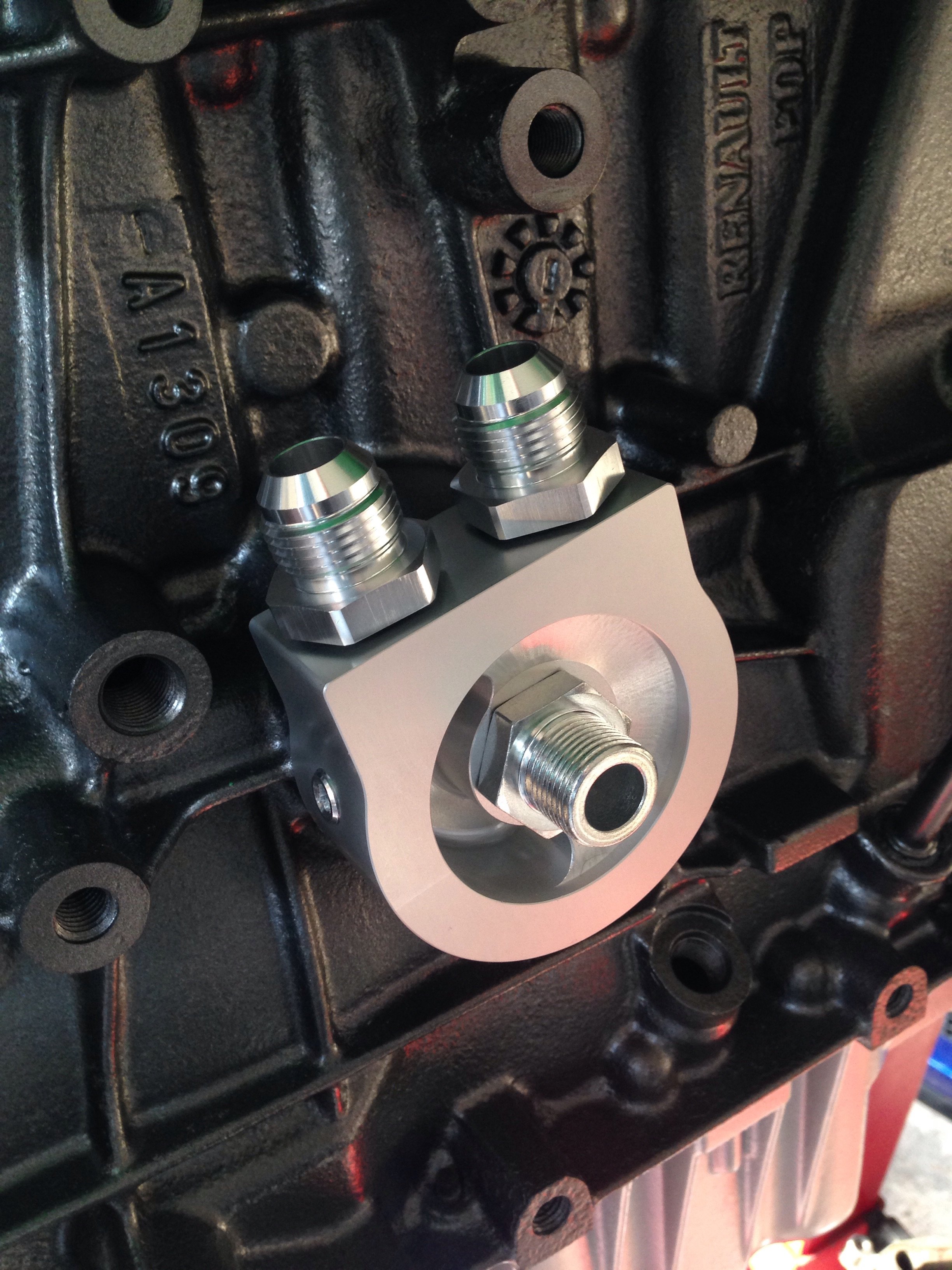

Billet oil cooler plate.
I'll do my best to keep this updated if people are interested? I'll be building my gearbox up soon so I'll be able to add pics of that through the various stages.

Billet oil cooler plate. I'll do my best to keep this updated if people are interested? I'll be building my gearbox up soon so I'll be able to add pics of that through the various stages.
Nice, is that a Modine same as the cup cars? Which box you using? You sticking with a jc5 or you picked up a Sadev now?

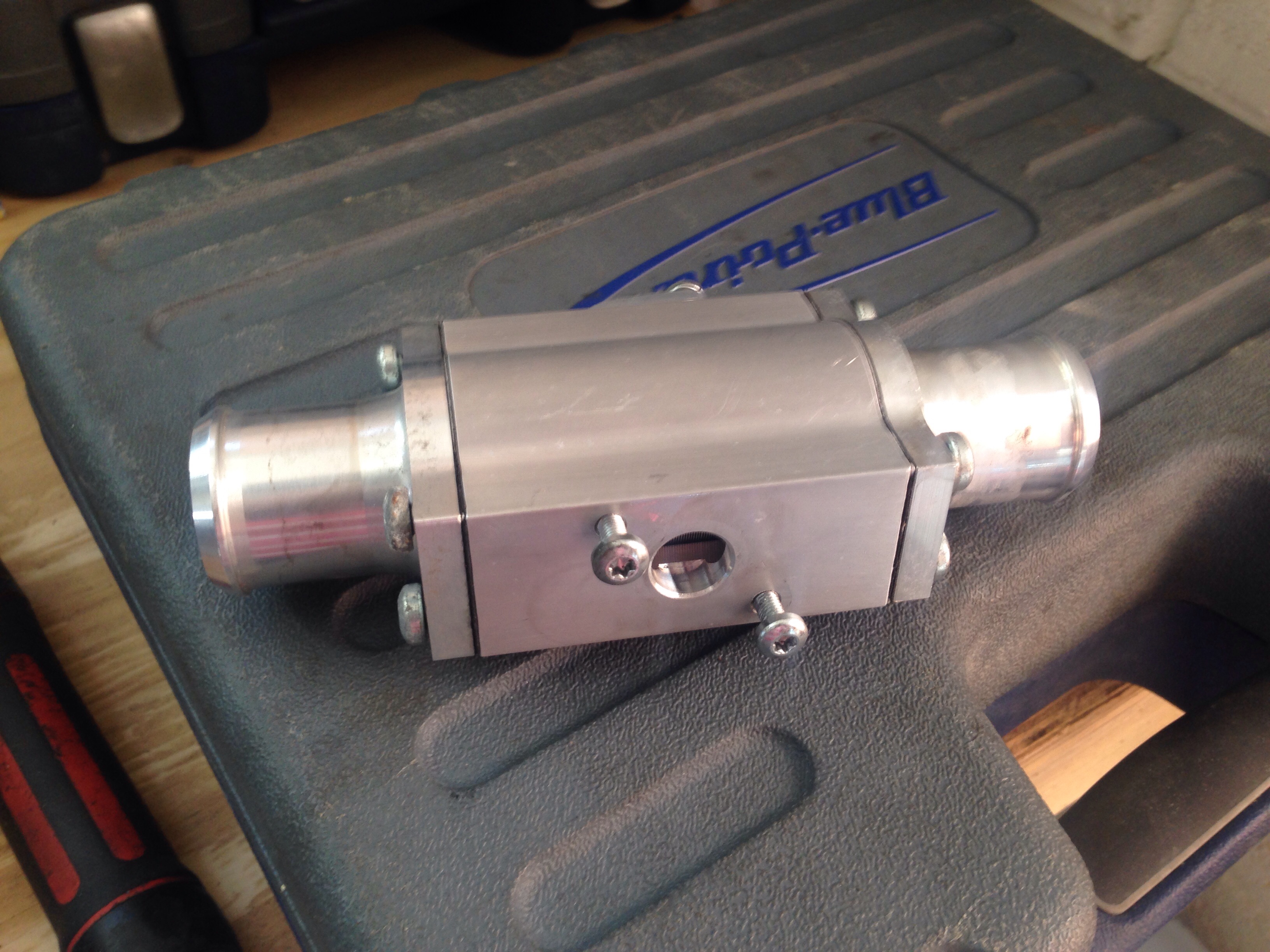

No mate not a modine. It's going to be feeding my laminova oil cooler.

Here's the laminova that I'll be using to keep the oil cool. Really trick bits of kit tbh.

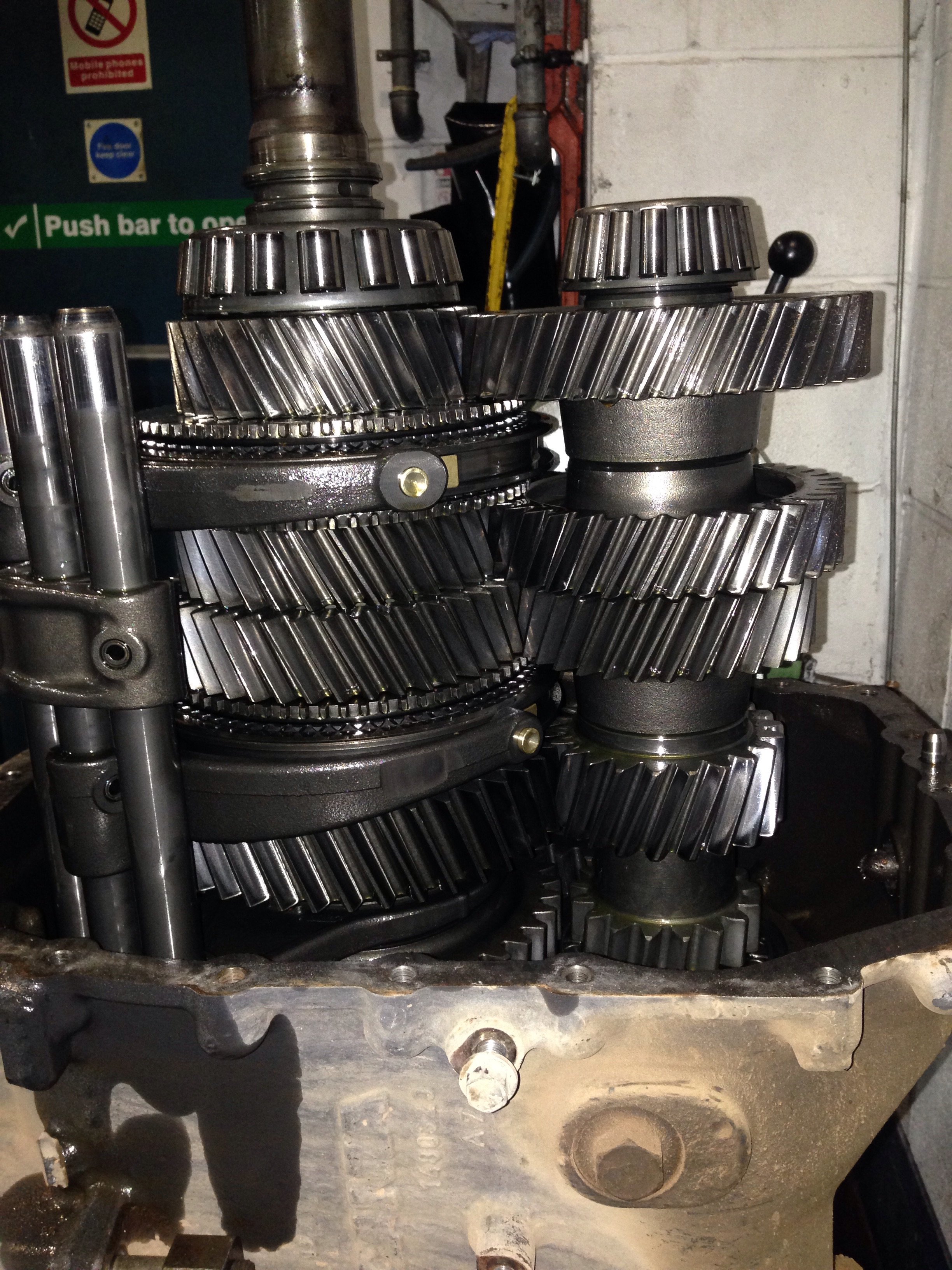

Next up we have a jc5 in kit form!! Hope you lot know where everything goes, because I'm fucked if I do! Lol!

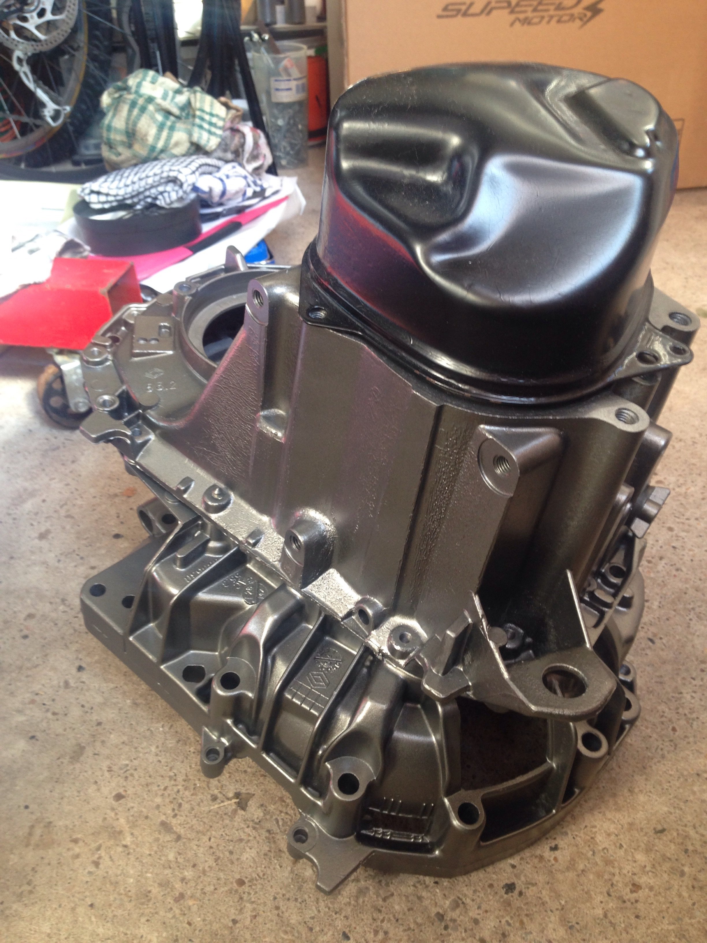

Here's a shot of the freshly painted gearbox casing. Same colour as the block.
I'm sure the bits will find their way in there somehow. :wink:

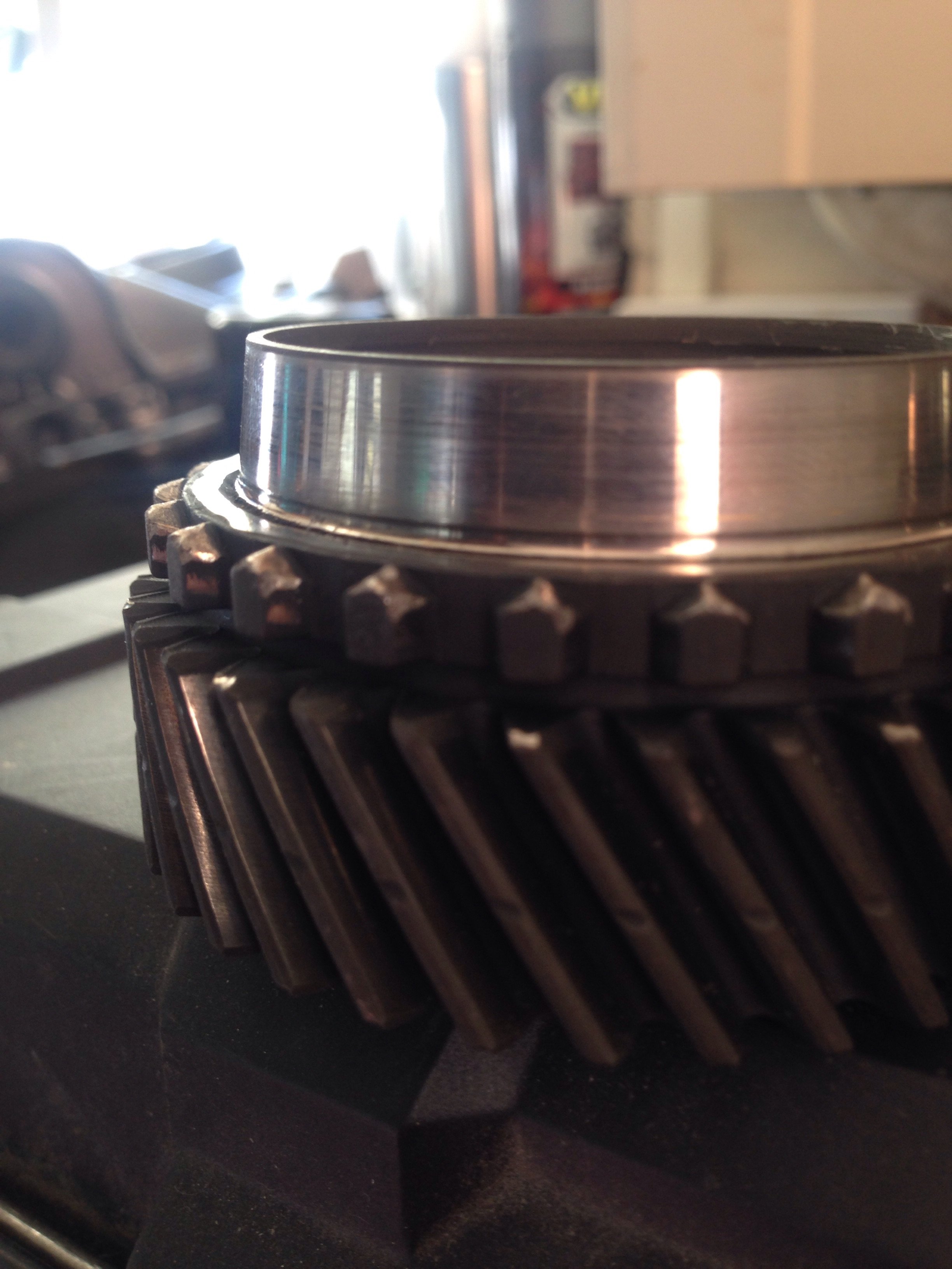

Here's what happens when you drive like a stick 'n' arse - it f***s the dog teeth on the gears.
Not the best pic I know, but you can see where the points are rounded off. Synchro's are fine it's just these teeth that wear! £££'s to replace as well.

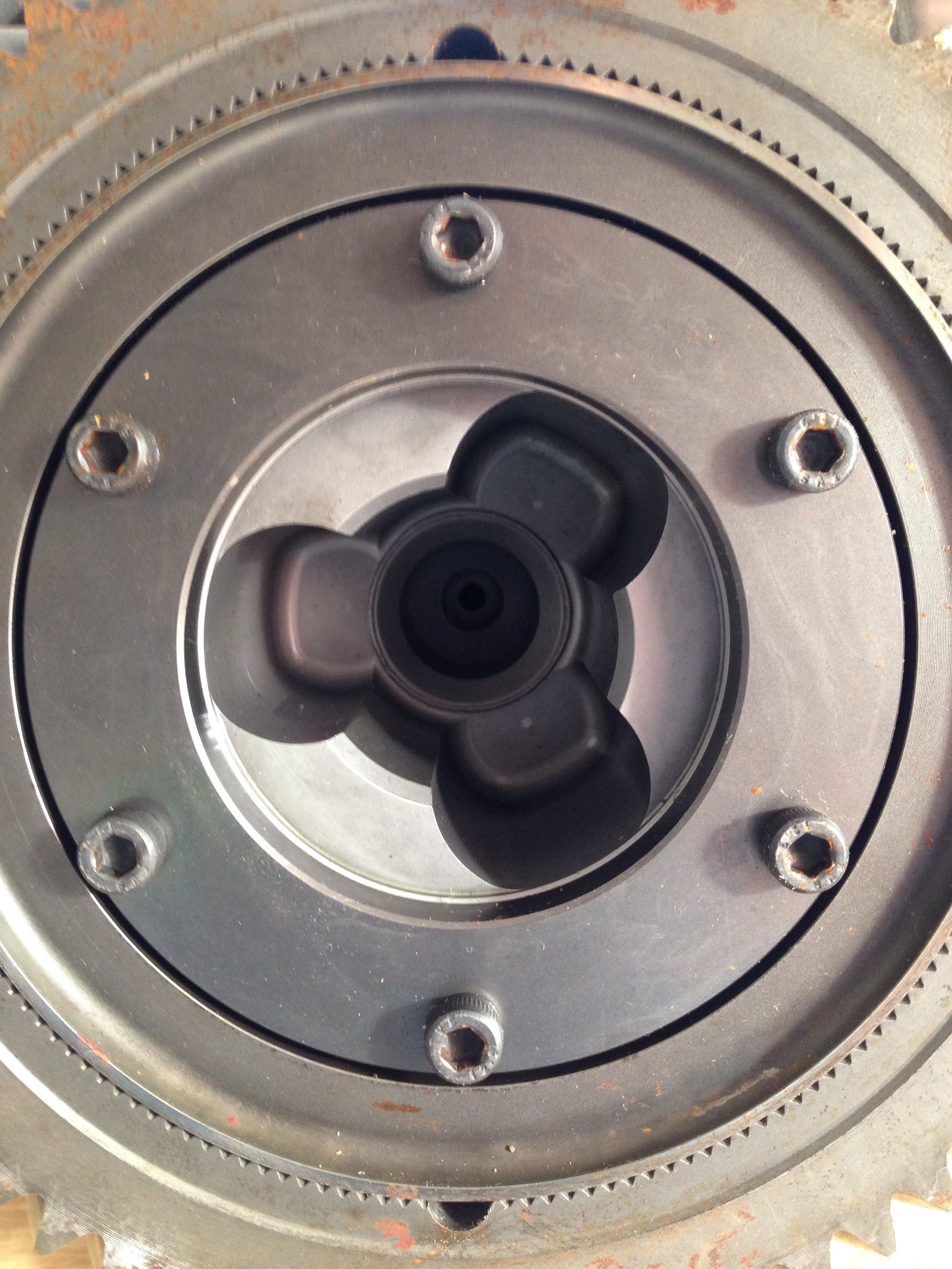

Here's something to keep the power in check! Quaife LSD.

that laminova looks smaller than I thought it would be, expected something 30cm or so for some reason.
that box in bits looks worriying, you gonnan assemble that yourself?

That is the smallest laminova mocal do mate. It was originally used on my Astra Quaife straight cut gearbox. It used to have overheating issues from anything over 150-160mph and this cooler was boss of the job!!
Box in bits is no drama tbh mate. It's been stripped down like that for well over 12 months though. Lol!

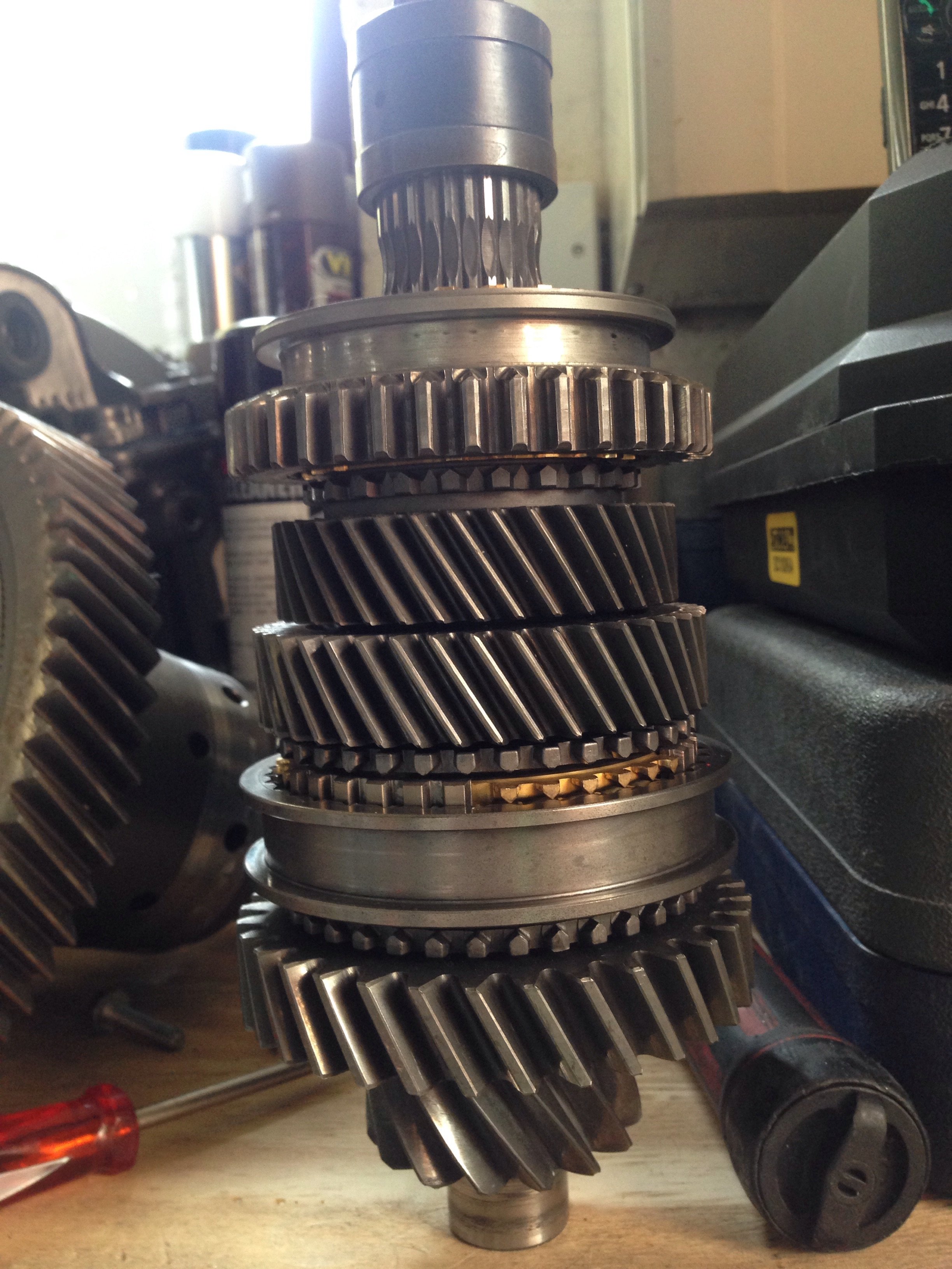

Made a start on the gearbox today. Waiting on 4th gear arriving ( on back order) so there's not really much else I can do other than knock a bearing race on to the pinion end of the mainshaft. The bearing collar for 4th gear on the top of the shaft has now been fitted properly too. Gave myself a there there after I clouted my finger between the hammer and punch so bid it b****cks for the day after that. Lol!

Gearbox nearly finished now. :nomouth:

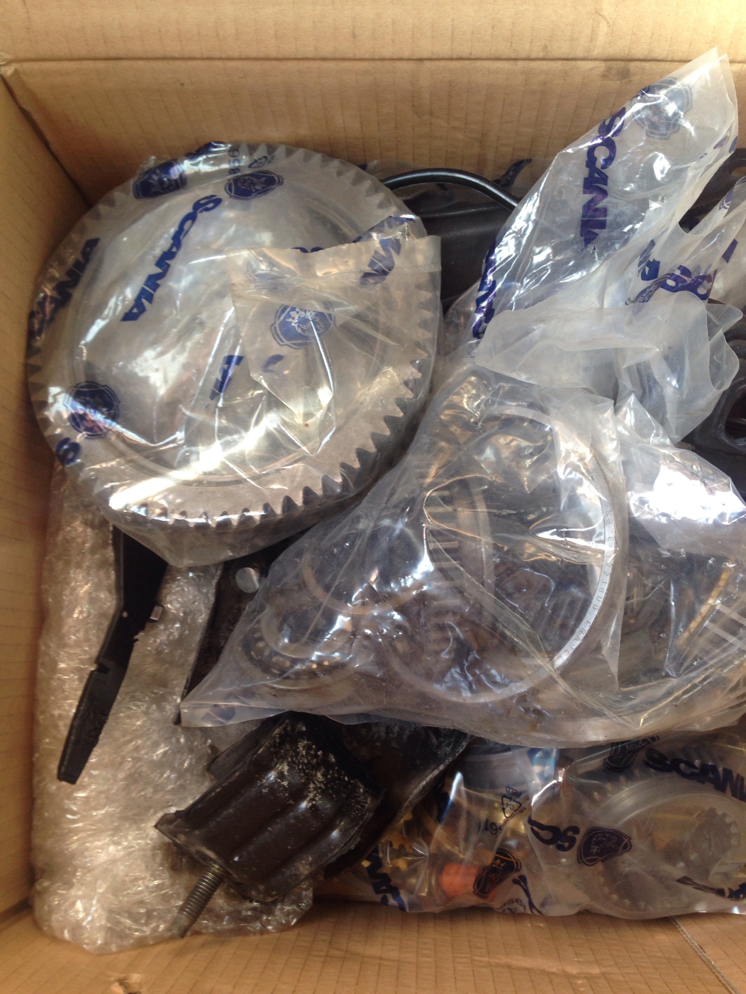

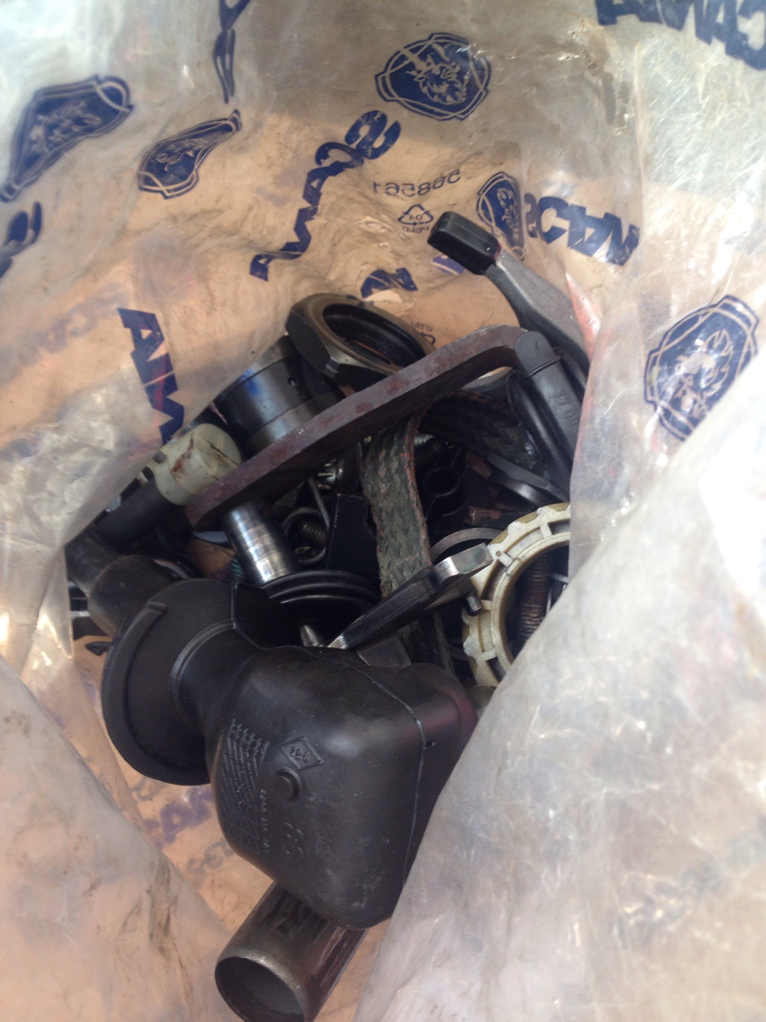

Ok, so maybe that's not a jc5, but it's as equally unreliable. Lol! Got a full strip and refresh to do on this, then refit it. 9hrs of fun. I thank you.
In jc5 129 news I'm waiting on back order parts to arrive overnight from Tokyo. Allegedly. So nothing to report for the time being.
