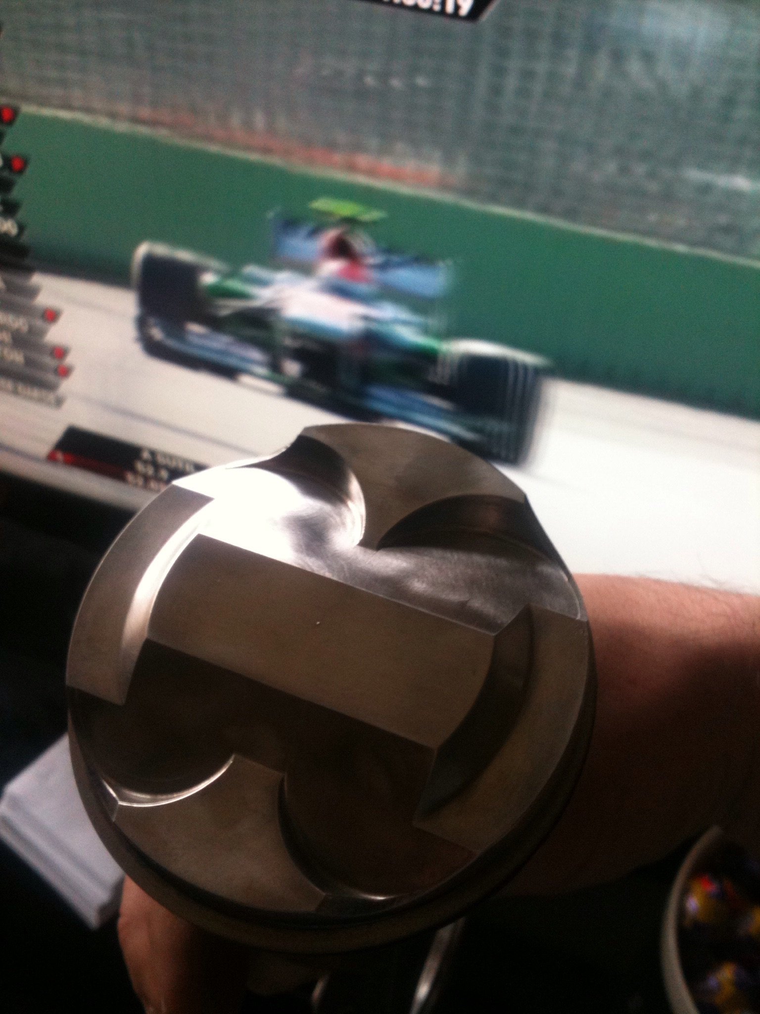

Excellent spec.. Stupid question.. Are the Maxi piston HC?
Not a stupid question at all mate, but yes they are high compression. Here's what they look like:Excellent spec.. Stupid question.. Are the Maxi piston HC?

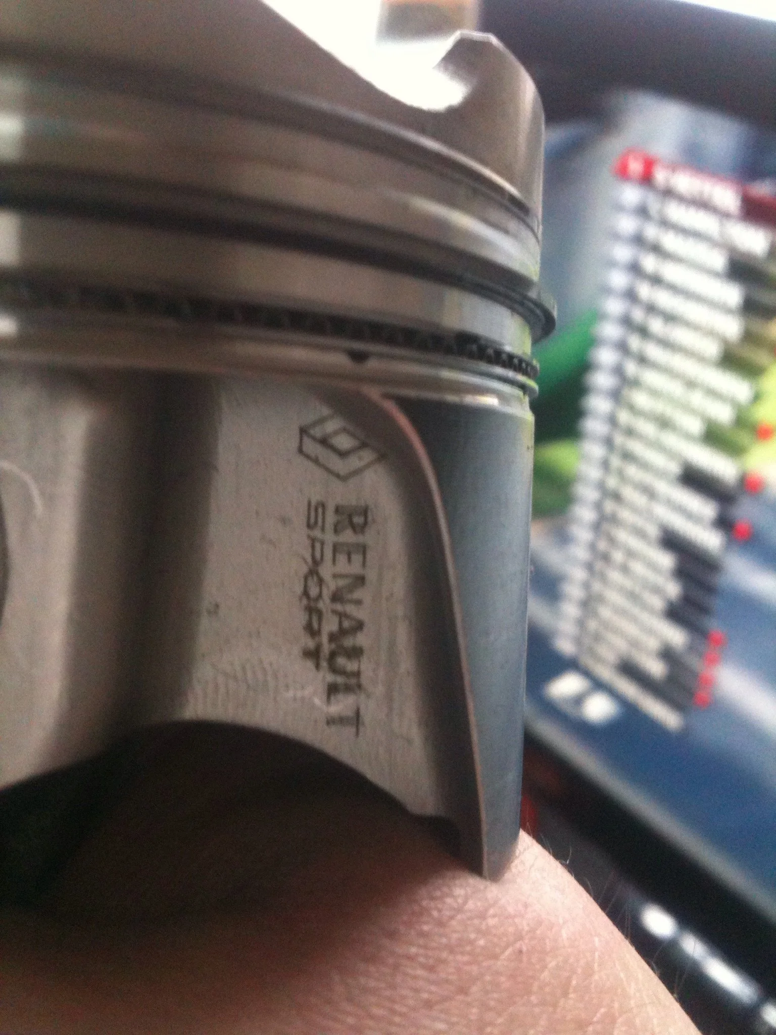

You have the top compression ring, 2nd compression ring and 2 oil control rings mate. That's the standard piston ring setup. It's only race engines that they start doing away with some of the rings, but they need rebuilds a lot more often.4 piston rings per cylinder?
Always thought competion engines had less rings, not more?
Or is there a special reason for it?
Thanks mate. If it doesn't make the numbers I'll re-engineer the pms manifold to accept a gt3076 and low comp it. LolThis looks amazing, like others can't wait to see the figures.
Lol!And i'll have it off ya lol
Ah ok so it is the oil ring that is doubled upYou have the top compression ring, 2nd compression ring and 2 oil control rings mate. That's the standard piston ring setup. It's only race engines that they start doing away with some of the rings, but they need rebuilds a lot more often.
Tbh mate I've not seen an engine without 2 oil control rings, so couldn't comment on if it's an f4r thing.Ah ok so it is the oil ring that is doubled up
