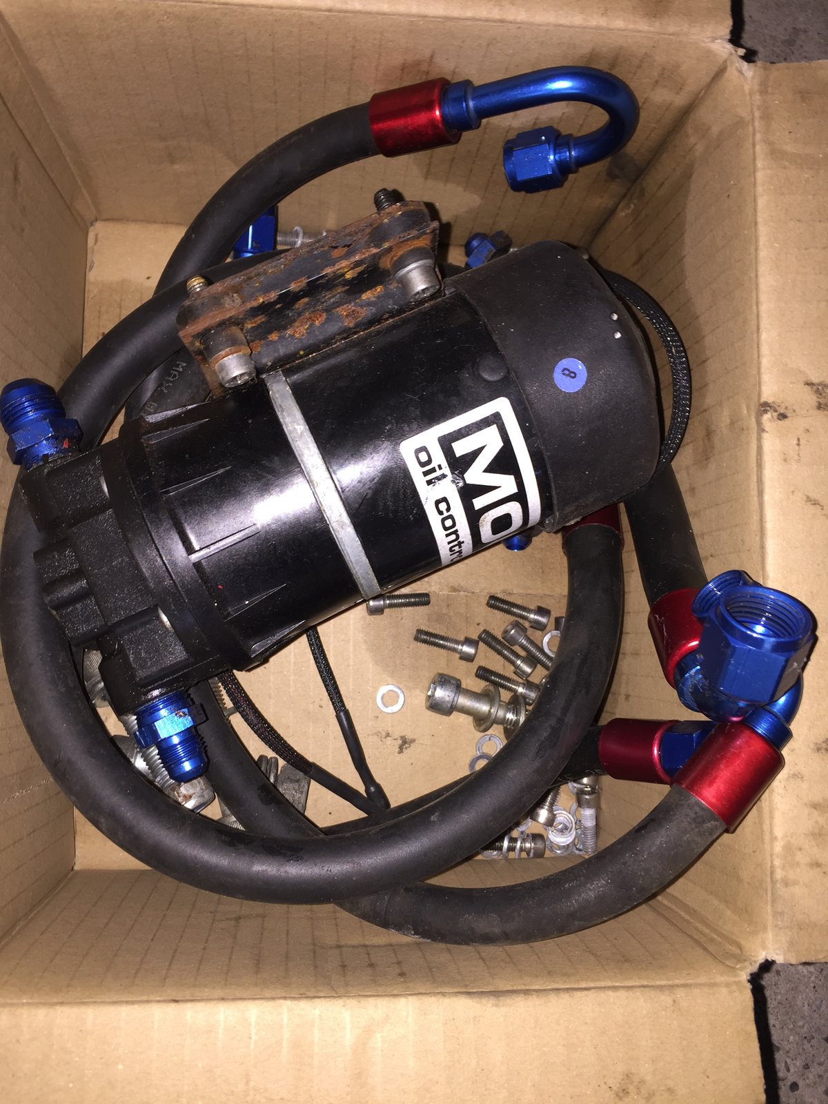

Ok so seeing as it's now making some proper hp, I thought it's time to dig out the gearbox oil cooler. This is another leftover item from off my Astra build.
It's tried and tested and proven to work, and let's be honest, the jc5 needs as much help as it can get! Lol!
Just a case of where/when to install it, but I think it'll be done over winter when it's in hibernation.
