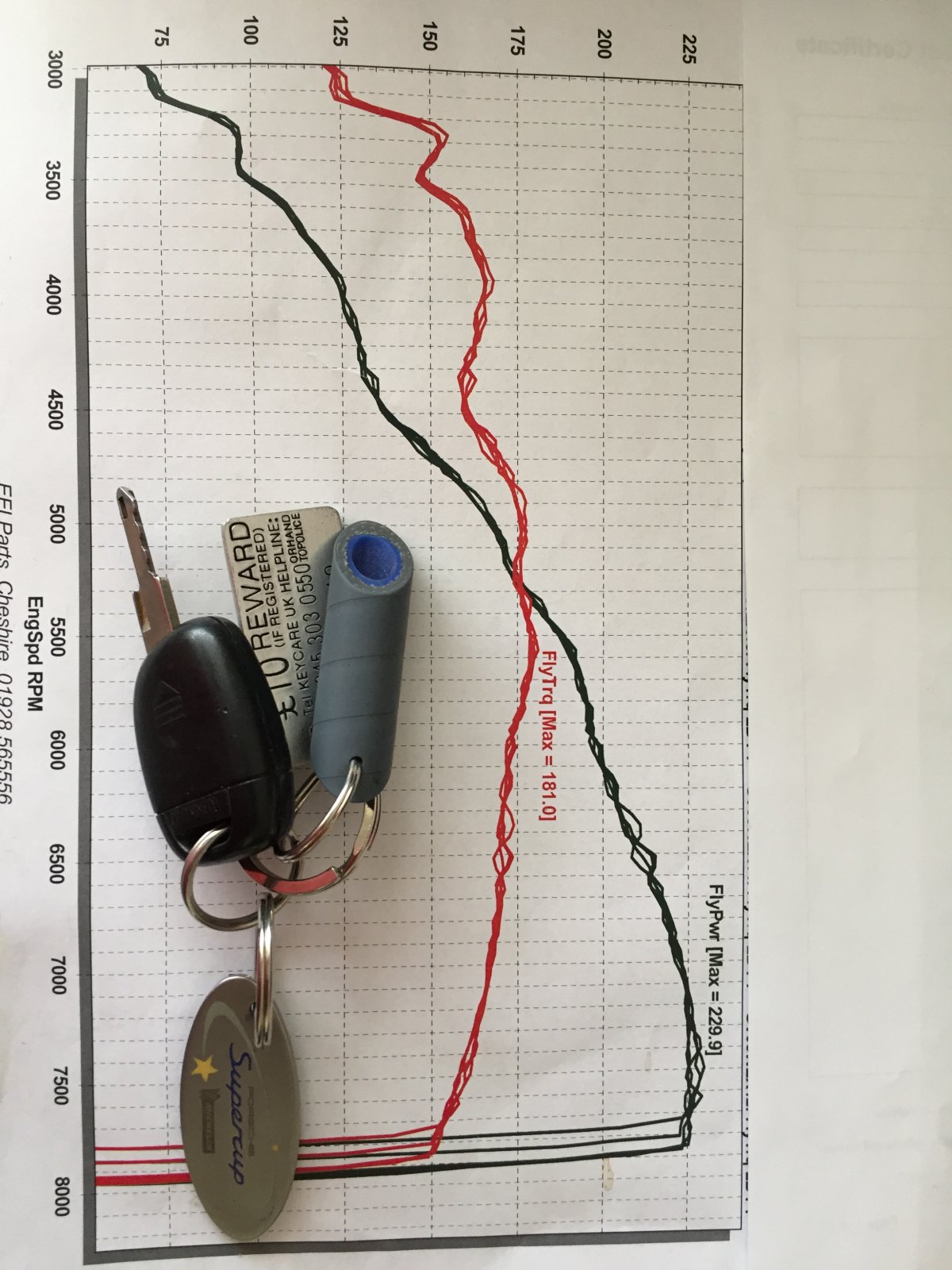

What a load of bollox, you told me several times you would never, never, never, never, never, never, never, never. never, never, never, never, never, never, never, never, never, never, never, never, never, never, never, never, never, never, never, never. never, never, never, never, never, never, never, never, never, never, never, never build a modified engine for the Clio.Yeah I'm very pleased with the end result tbh. It's done more that I anticipated as well tbh - not bad considering I started out 'just wanting 200hp'. Lol

Lol you'll have to mate because unless there was a proper set of itbs available to suit the 197 head (I'm talking 48's not poxy 45's) it's staying on the standard inlet and maxi evo airbox.I will wonder for you then! Yeah I can well imagine, essentially identical curves to mine (mine peeks 182fltb from 5000-5300) all the way to 6500 when yours just carries on relentlessly. Coupled with the light mk2 shell you have, batshit and legitimately so.

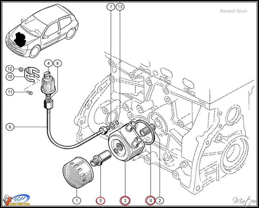

Yeah you can fit them to all the 1*2's. Can't remember which model it comes from though, so can't say for definite that the 197/200 item will fit.Had to google it, but liking that modine setup...would it fir on a 182?
None that are clear mate tbh. I'll take some and send them via iMessage mate.Sorry to hi-Jack Mark but any pictures of the Modine set up anywhere? Easy enough to install?
It's just a sandwich plate basically, Google says the mk2 Cup Racer apparently had one:Sorry to hi-Jack Mark but any pictures of the Modine set up anywhere? Easy enough to install?
That is a very interesting setup on the cup racer...did that diagram come with part numbers?
thanks mate.....Yeah these diags just look to have come straight from the RS parts PDF.
Found a mk2 copy here: http://www.renault-sport.de/uploads/tx_news/Teilekatalog_Clio_II_Cup_2005.pdf
section 10.84 and 19.05 for the parts.
