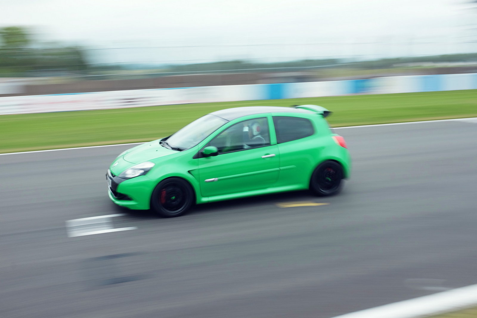

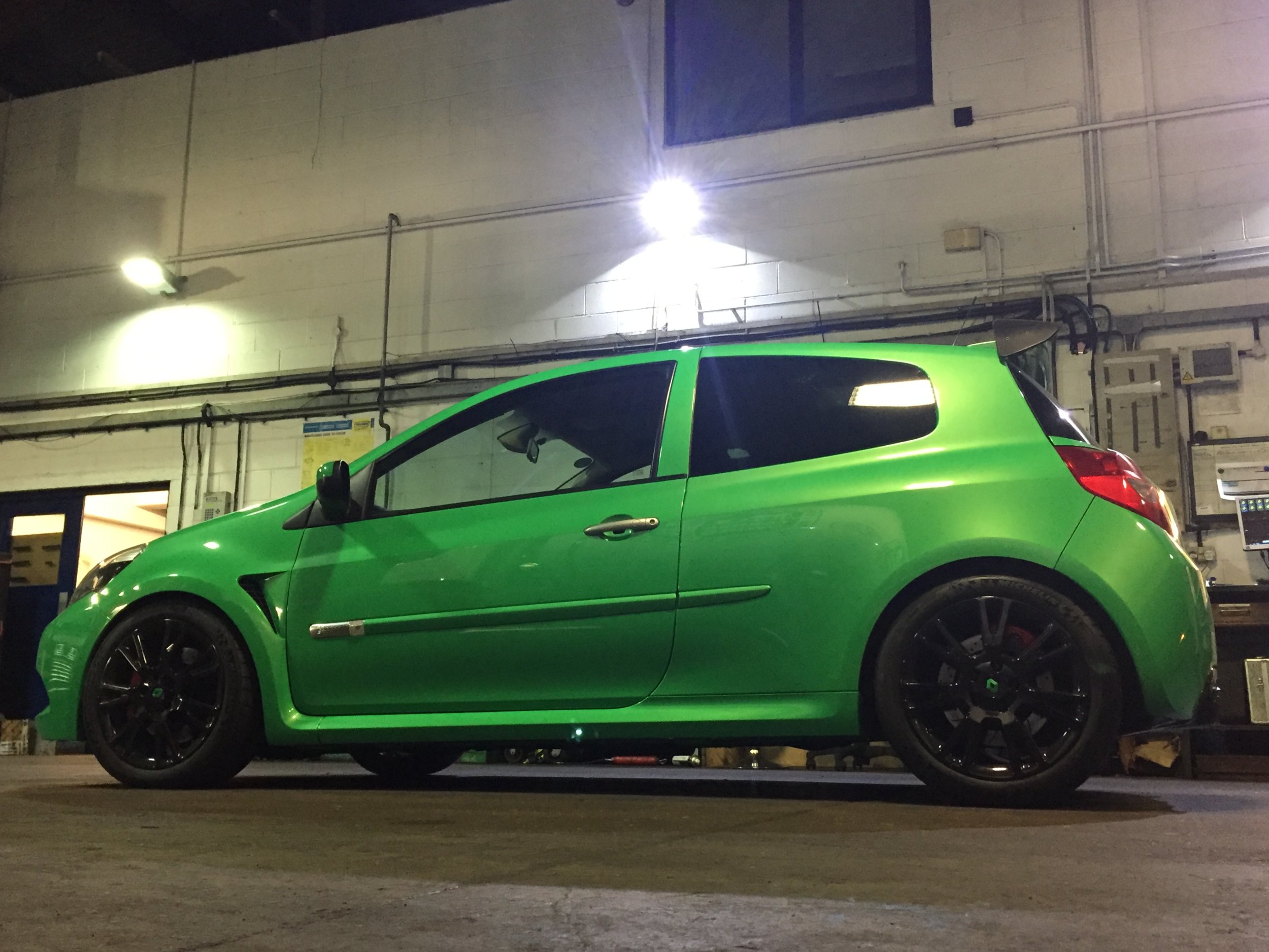

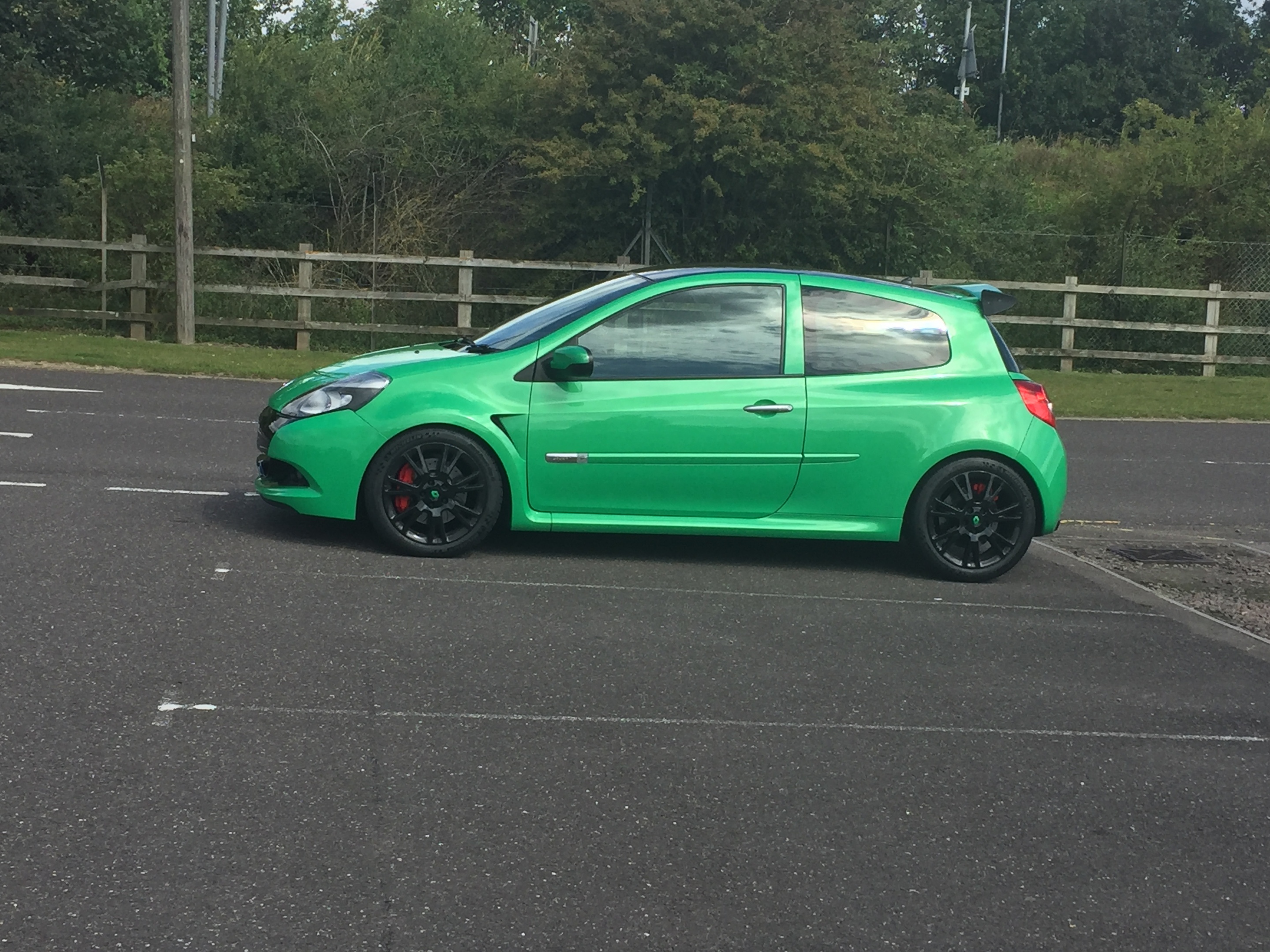

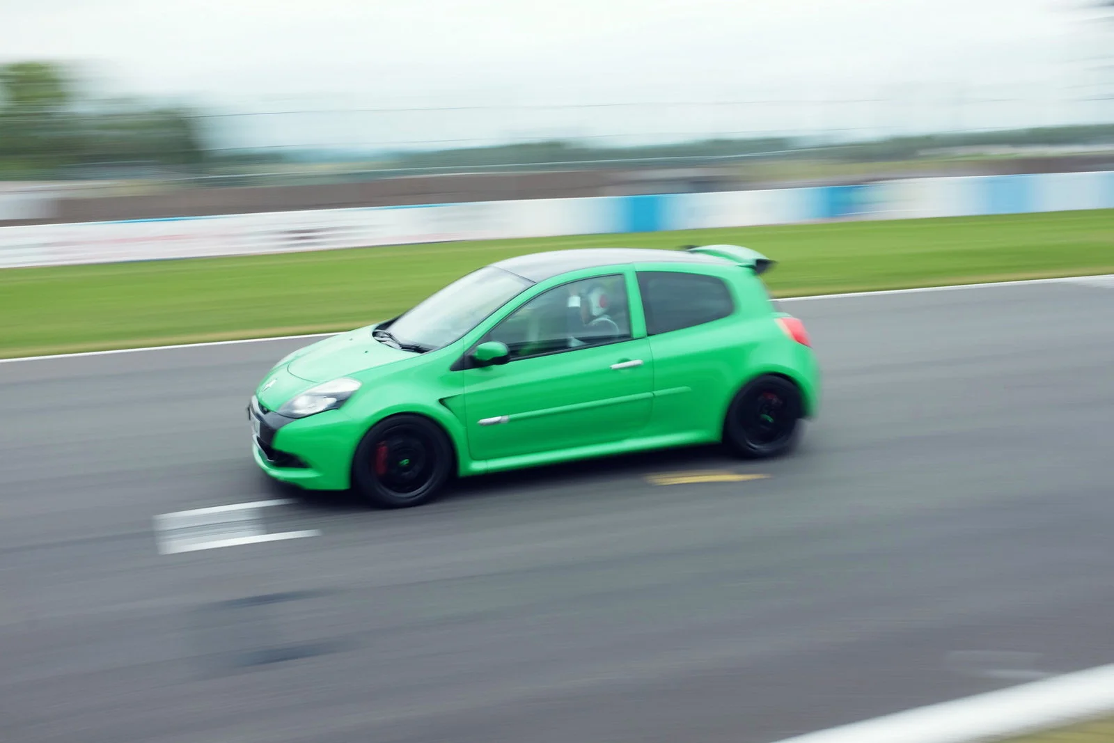

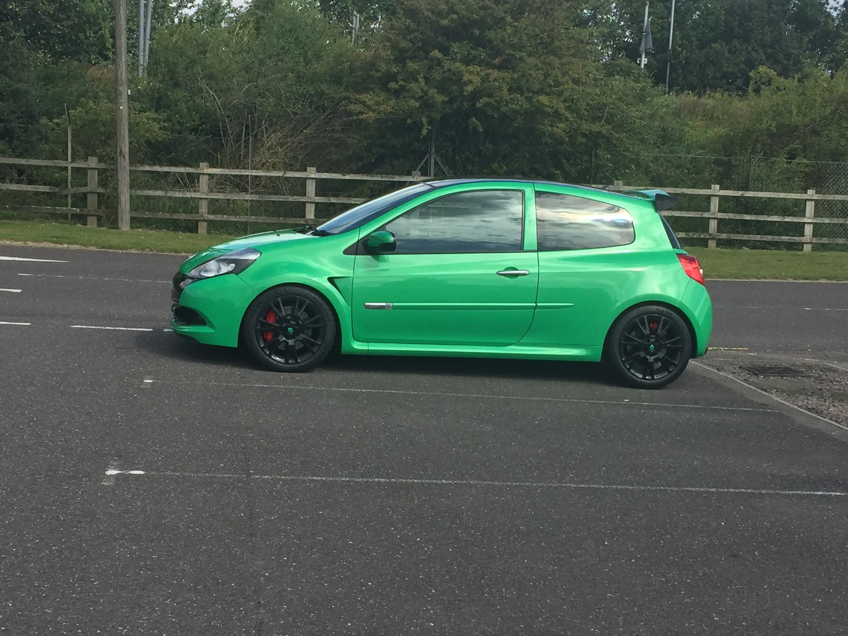

Couple of pics for the album. :cool:
Shamelessly stole this pic from off here ^^^
^^^ I think that one shows off AG quite well considering it's an absolute wanker to show off the pearl in pretty much any photo!!

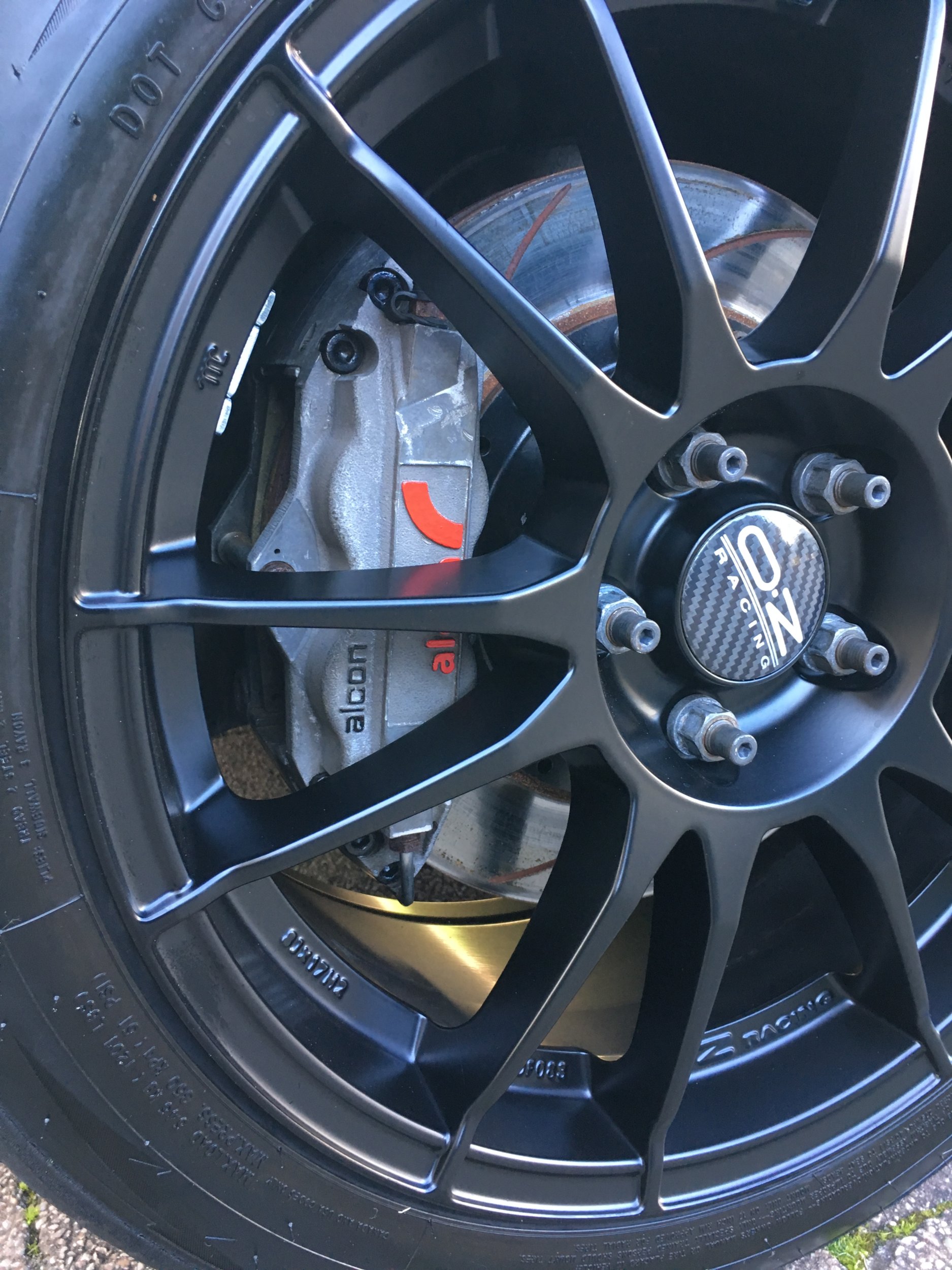

330mm bell and rotor setup are off the cards for the time being. I'm just going to stick with the tried and tested cup racer setup and see how we go.

I'm pretty sure that 330mm is the biggest you can get under the 17's mate tbh.

I think the Speedline's are the restriction on disc size tbh mate.

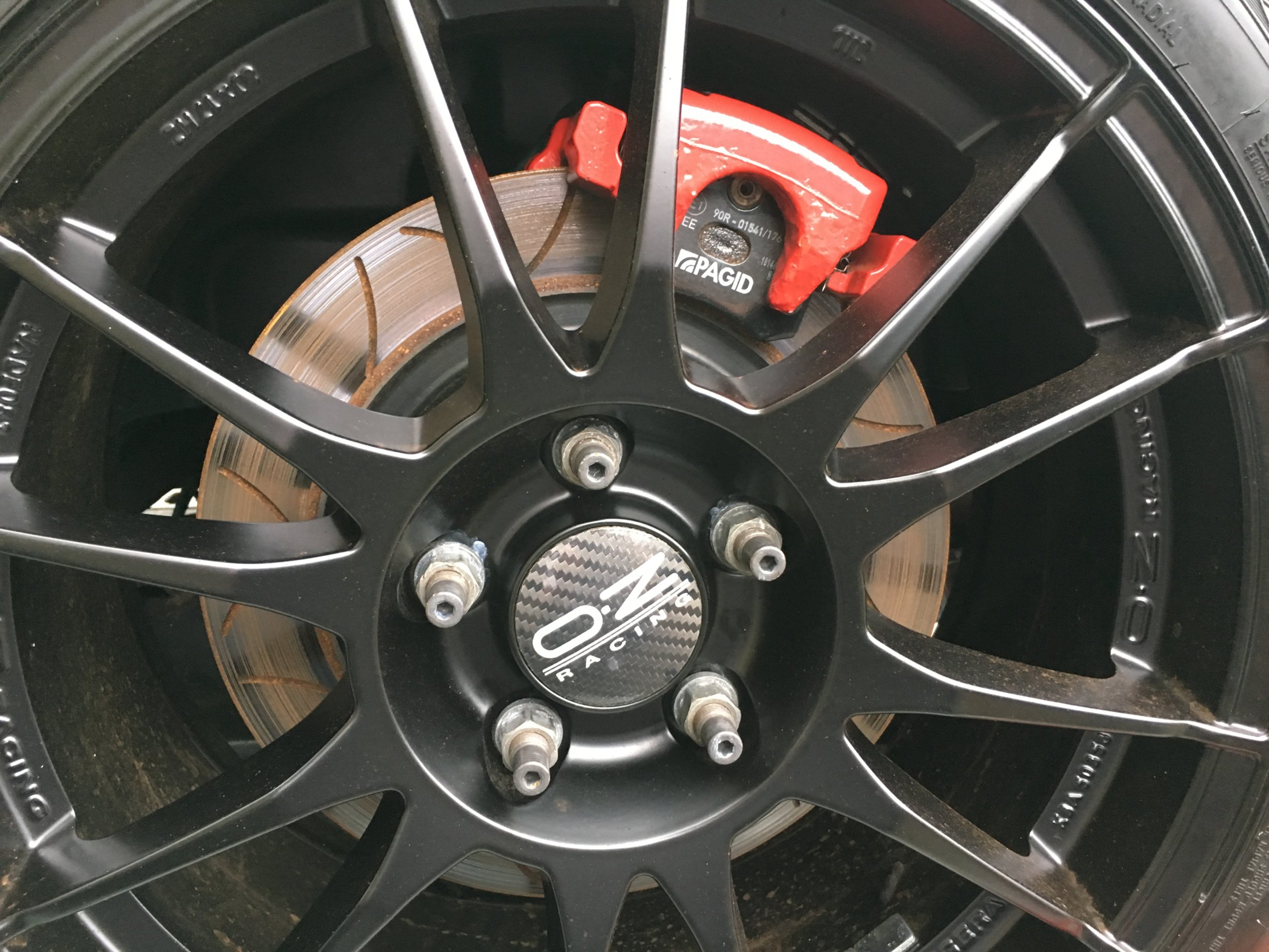

I had similar issues with 2500 on the Trophy mate, they are just no where near up for the job. I would however highly recommend the PAGID set up that the AG has on it just now, never failed at knockhill, which is hard on the car given weight and track..... the alcons also playing their part but the pads ran faultlessly all day with no fade etc..... biggest drawback is their price but, given your like me and do very limited mileage with it they will last a long time

You on pagid rs4-2's Craig?
NorthloopCup
RS-19 front with big rotor set up, RS-2 rear with R26R discs, Mark
Ah right ok. I'm just going to run the standard discs front and rear, but get the J hook pattern machined into them like I had on the cup up front.
It doesn't feel as though the pads want to 'bite' the disc if you get me? Granted ds2500's up front are probably not the best choice up front for hauling the speed off on track though.
I ran the same setup on the cup (ds2500's all round) and you could definitely feel the pads biting the disc under heavy braking. Lighter car as well though!
R26R discs just have grooves in them don't they? I don't recall them being any larger in diameter.
