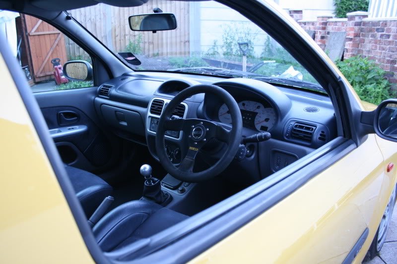

Love it, got to be one of the last mint sunflowers.
Steering wheel looks good ;)
Cheers, I wouldn't say it's "mint" there are still a few little things that need sorting out. I really want to get it into the bodysgop to get a few little imperfections sorted out.
The steering wheel made a huge difference, massive imporvement.

Cheers mate. it's the same wheel as mine hence the wink, not that I've had a chance to use it yet :P
Re: Bren's Sunflower 172
oh right, makes sense. I've had this wheel for ages, was on my MK5 Zetec-s oh so long ago. Beats the Renalt windmill you get as standard.

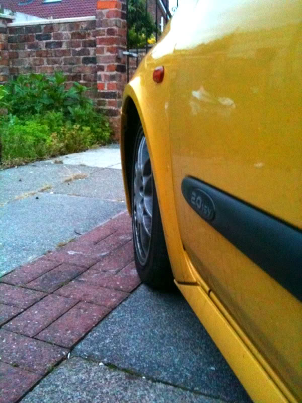

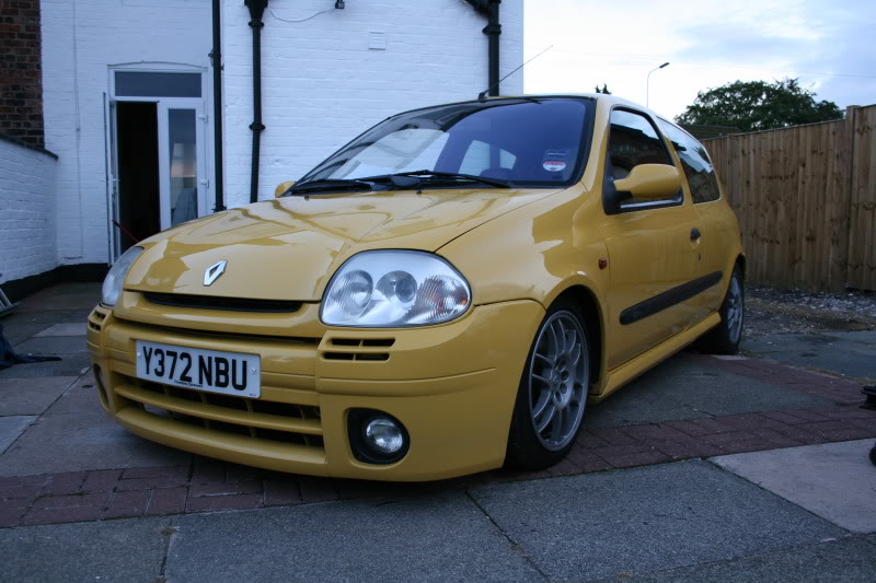

Finally sorted out the camber on the front, didn't take long and improved the handling substantially. The turn-in is fantastic now. Just need some decent tyres to compliment everything.
Much happier

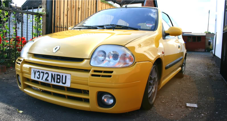

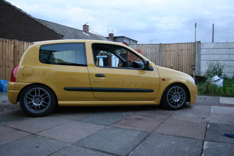

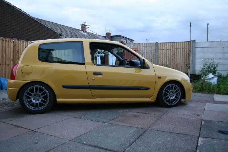

Whilst waiting for f0xy to pop down and show me how to do the tracking on the drive, I gave the car a good clean and took a couple of pics before the light completely faded.... all ready for RR meet at RS Tuning tomorrow morning. We finished everything at midnight, and I'm up at 7:30 to set off to Leeds. Grim.
How she is sitting at the moment.

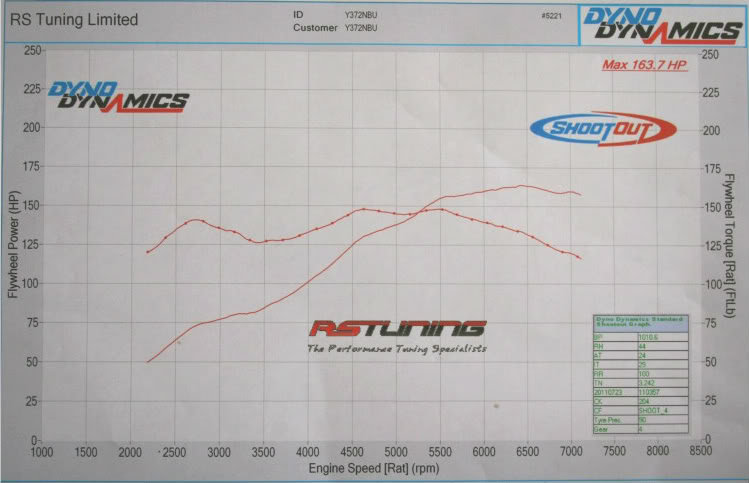

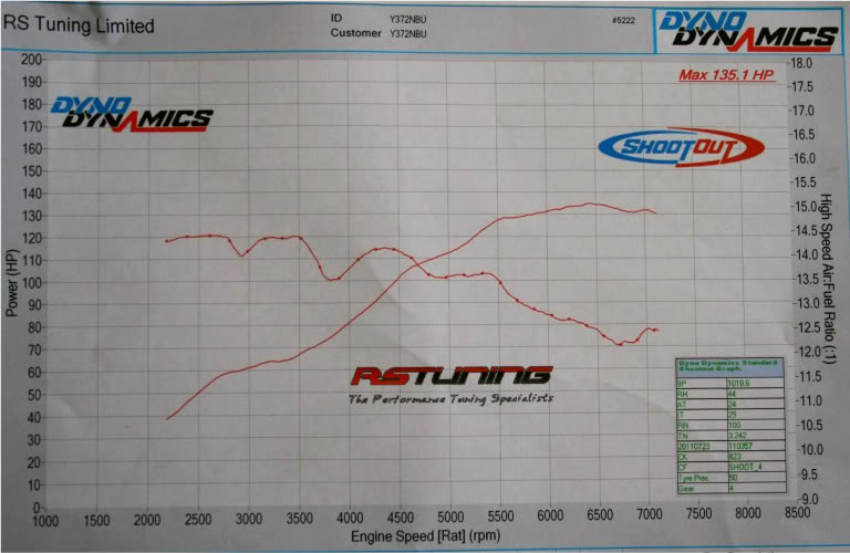

Off to RS Tuning today for the NE RR day. Was a little anxious A) I wasn't sure if the car would actually get on the rollers, due to it being so low. B) With it being a new car, I wasn't entirely sure how it was running. With the MIL light being on, but performance not noticably lacking, I couldn't be sure if any issues would come up.
Thankfully, all seems well. The car was recently serviced, and I'm just yet to change the spark plugs.
I don't know anything about air/fuel ratios, so hopefully someone can give me some insight as to what the graph below is really telling me. Lean/Rich?

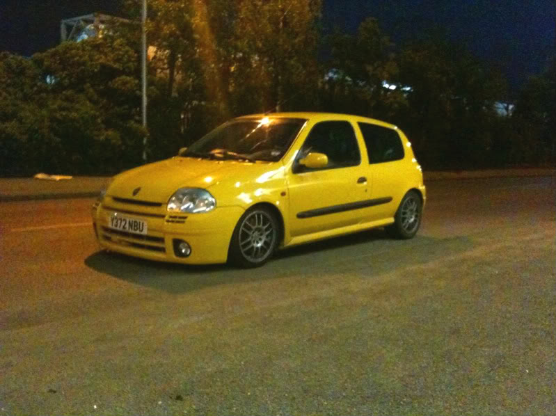

And just a cheeky one to give you an idea of just how low it is, and why it was a bit of a struggle to get it on the rollers. Think there was 3-5mm gap between the subframe and the rollers :cool:
Good day, think an RS Tuner is in order sometime soon. Some examples running well on them today.

Nice one, should be happy enough with that. Looks awesome too!
Cheers man, seems to be running pretty well which I'm happy with.

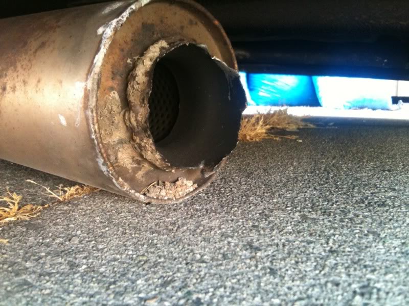

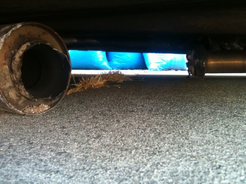

Finally got around to taking a look at the exhaust.. just another example as to why powerflow are cr*p. The flange has ripped off, thank to crappy welds.

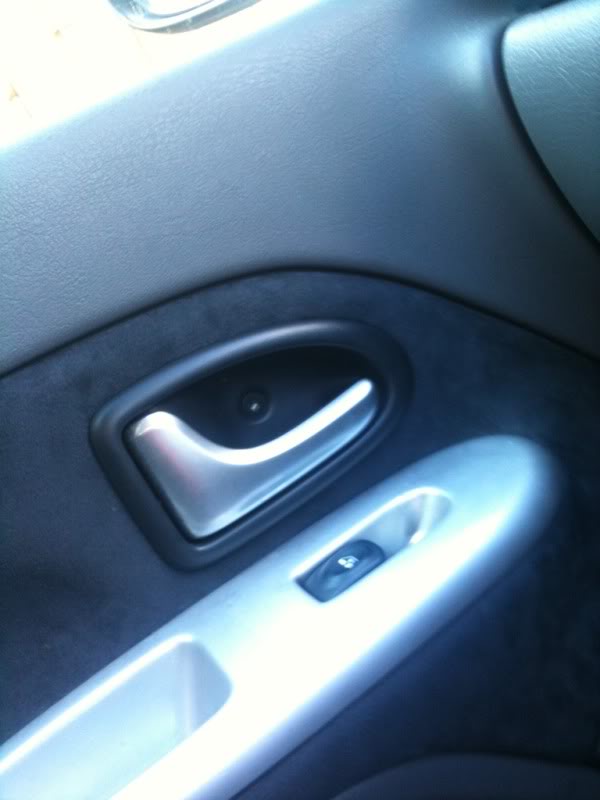

nicer note, ph2 door handles arrived.

The lowness just totally spoils it for me, looks ridiculous and is sure to spoil what the car is about - that cant drive nice?
Other than that I liked it

decent power for standard car, should be chuffed!
Yeah I'm pretty happy, just good to know it's running well. From other peoples results at the RR day it seems like Matched inlets and an RS Tuner is the way to go. not going ot rush things though, enjoy it with the power it has now. I don't want to go figure chasing.

Haven't had a chance to adjust the fronts yet, will be raised a tad, but not a huge amount. What doesn't help is the front tyres are 45 profile and the rear are 50. Shall be changing them when I can. Also given the offset of the F1s the fron wheels are lost in the arches. Probably some new wheels in order later down the line.
In terms of driving, it handled like a pig before the tracking and camber was sorted. Has excellent turn-in and grip now though. I was worried it would ruin the handling, but it is just as good if not better than standard (removed a lot of the roll in the corners, and better front end grip)

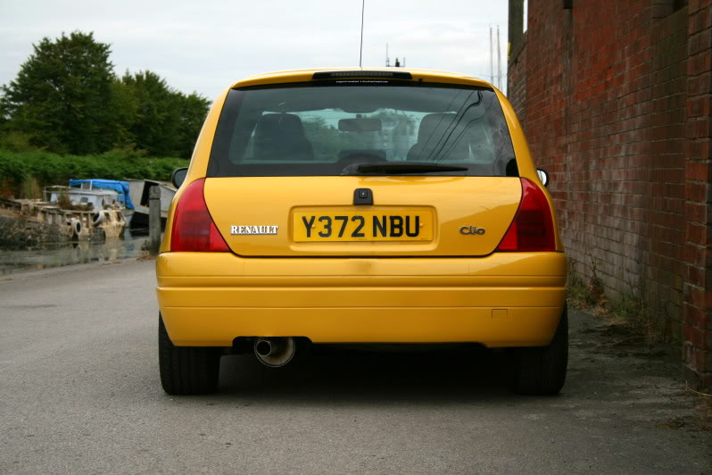

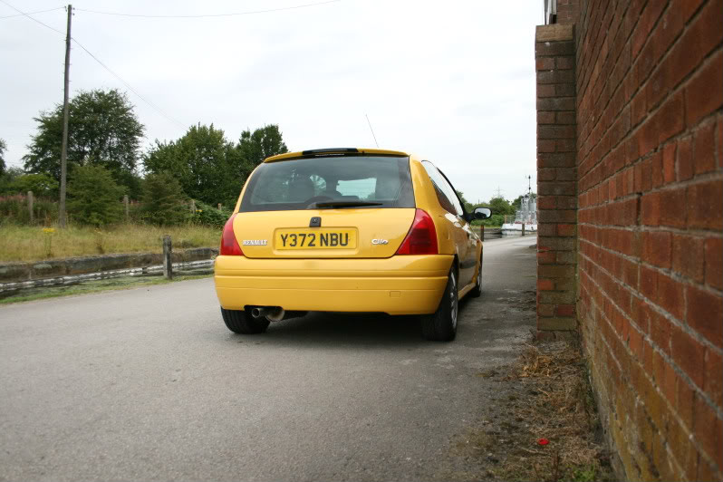

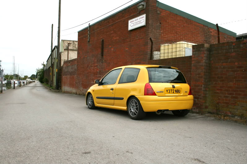

Off to pipewerx this morning to get the exhaust sorted, was pretty horrible driving down on just the manifold, but got there without being pulled (phyew).
Sacked off the shagged centre box, and welded in a straight 2 1/4" pipe. Mostly because I don't want to spend money on this crap powerflow exhaust. Decided to stick straight tip on whilst I was there as there was a 'stealth' tip on there (which made no sense as there is a massiv cutout in the bumper from a previous owner).
Ph2 bumper will be on soon, and a trip to the bodyshop next week. Now I need to set off for Awesomfest for the weekend!!
Yes it's at a slight angle, I quite like it.

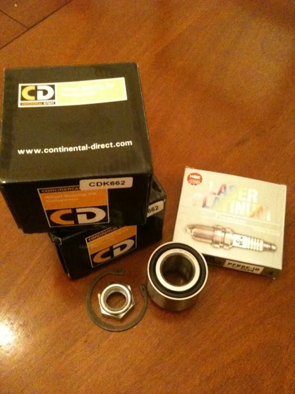

New rear bearings arrived, so shall be getting them pressed into the rear discs this week. The discs have plenty of life left in them, so new bearings (£25 for the pair) is better than paying £100+ for a set of discs. New PFR6E-10 spark plugs arrived, so they need fitting at some point.

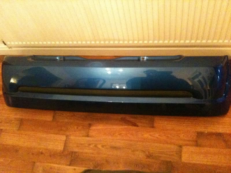

Depending on funds... a trip to the bodyshop. With regards to the rear bumper, this one has a silly cutout that really annoys me, plus the ph1 bumper has always baffled me as it just completely doesn't suit the rest of the car. So a ph2 (which I've had for about a year) will be going on soon.

.......................... So a ph2 (which I've had for about a year) will be going on soon.
Oh no.. not another ba5tardised ph1 :(
Looks great as it is! With the exception of the trimmed bumber, as you said. Out of interest, what is it that "baffles" you about the rear bumper fella? The ph2 rear bumper shares no characteristics of the ph1 front bumper what so ever.. :s

Exhaust looks really good now!
Thanks man, loving it. Really quiet on the motorway, nice little bit of rasp higher up the revs.

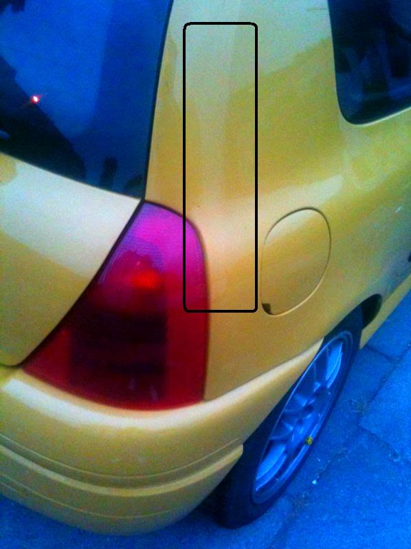

Another puritan... I can appreciate that some cars shouldn't be fettled with, but I have a big problem with the rear end of the ph1. It's not about the front and rear bumpers sharing characteristics, it's about the line of the body not matching the rear bumper in any way. Specifically there is a crease down the rear quarter that carries on down ph2 bumper, where as the ph1 is just completely out of sync.
This is a crap way of showing you what I mean...

agreed about the rear bumper, i hate the phs 1 bumper. It looks good here though. Its your project at end of the day though mate, bang the ph2 bumper on! give it ya best! :D
Very valid point with the sweige line there Bren. Never looked at that and how it continues down onto the ph2 bumper before.
However, for me, the ph2 rear and the ph1 front just look way too much of a miss-match.... Yes I am a self confessed purist lol.
What ever you choose to do, i'm sure it'll be well done.

Due to being so tired, sunburnt and lazy I didn't bother going to the bodyshop to get a quote. However I did manage to pick up the bearings that I may be able to get pressed in tomorrow, and I nipped around to f0xy's to pick up my ph2 sport bumper that I bought nearly a year ago. Still need to fit these spark plugs, and diagnose that weird rattle from the rear shocks.
