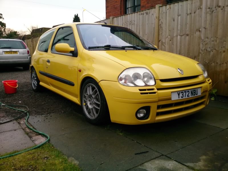

The car has been sat for a total of 15 months now, and hasn't been washed once in that time, so set about it today. Took a while, but pretty pleased with the results

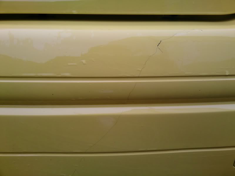

Whilst going over the car though I spotted a few bodywork issues that I really wanted sorted. The rear bumper has a few cracks in the paint, not sure exactly how this is caused but it's a little annoying.

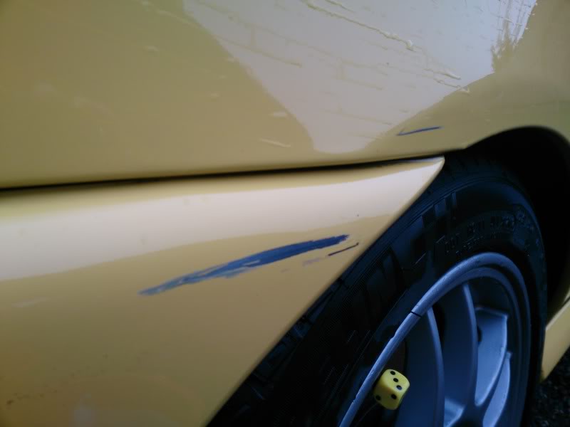

Also, still need to get this scratch my lovely neighbour caused.

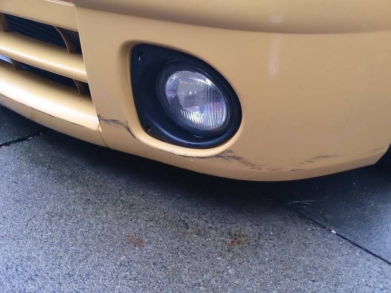

Also, one of my other lovely neighbours has somehow caused this mark all the way along the front bumper. Looks like someone has dragged their wheelie bin right across the front of the car. Had a bash at trying to remove it, but no luck.
