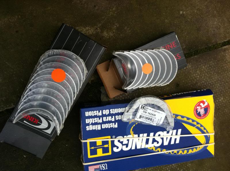

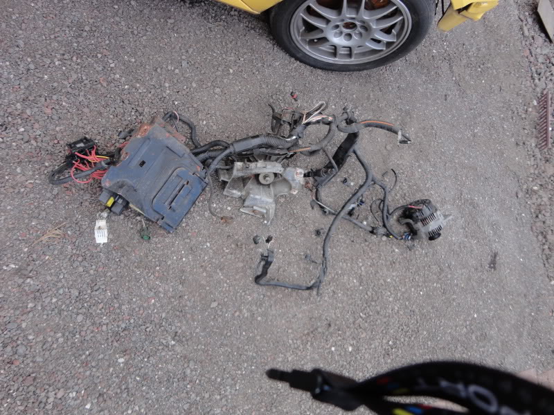

Couple of purchases this weekend. Managed to find an engine, so went to pick that up off Bomber with f0xy yesterday. Ordering new bearings, rings, seals, gaskets, head bolts, cambelt and aux belt kit etc etc next week. Engine will be getting stripped down and off for some machining: block decked, cylinders honed and head skimmed. That'll take a few weeks to get everything together as it'll have to be done at weekends.

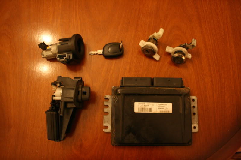

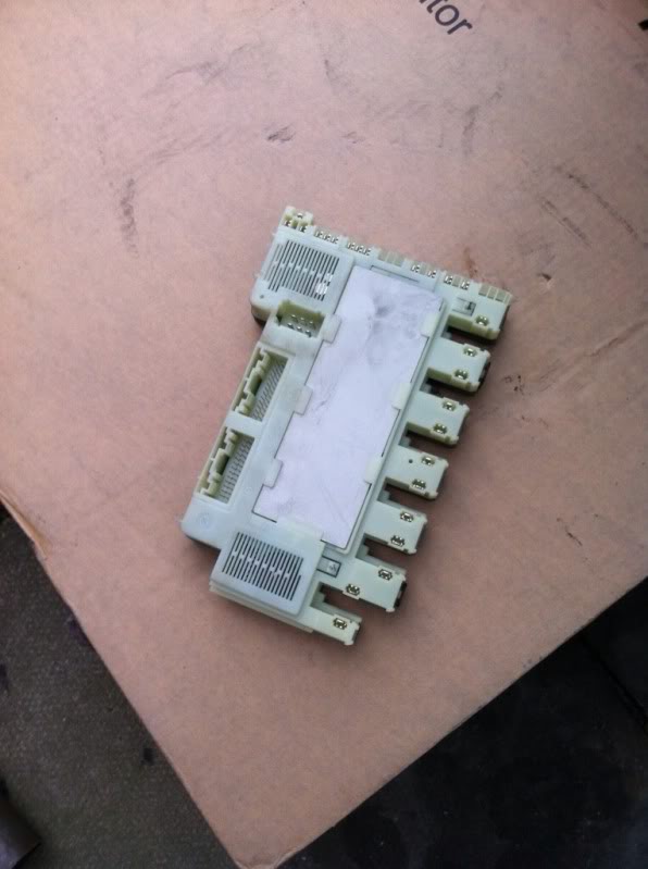

As he was breaking a complete ph1 I managed to get my hands on a few things I needed to get rid of the annoying aftermarket alarm and immobiliser. The locks must have been replaced at some point in it's life as the key starts the car, but doesn't work in the door or boot lock. Thanks to this I managed to lock myself out of the car with the engine running a few days after first picking it up. :eek: ...so to save future embarrassment I picked up a full lock set, ignition, key, ECU and UCH (multi timer unit on ph1).
Multi timer unit (UCH to you and me)
Locks ECU etc..
Thankfully Bomber also had a ICH knocking around, as this was something that needed doing before the engine died.

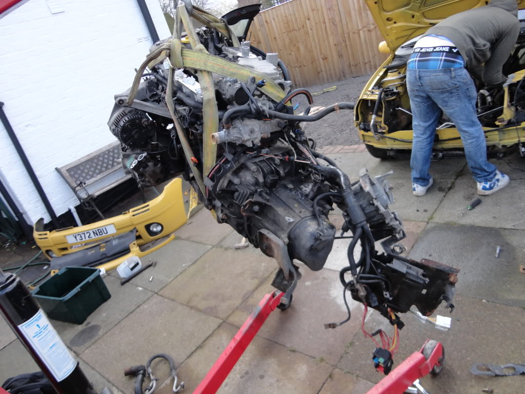

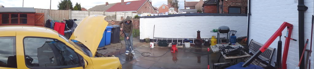

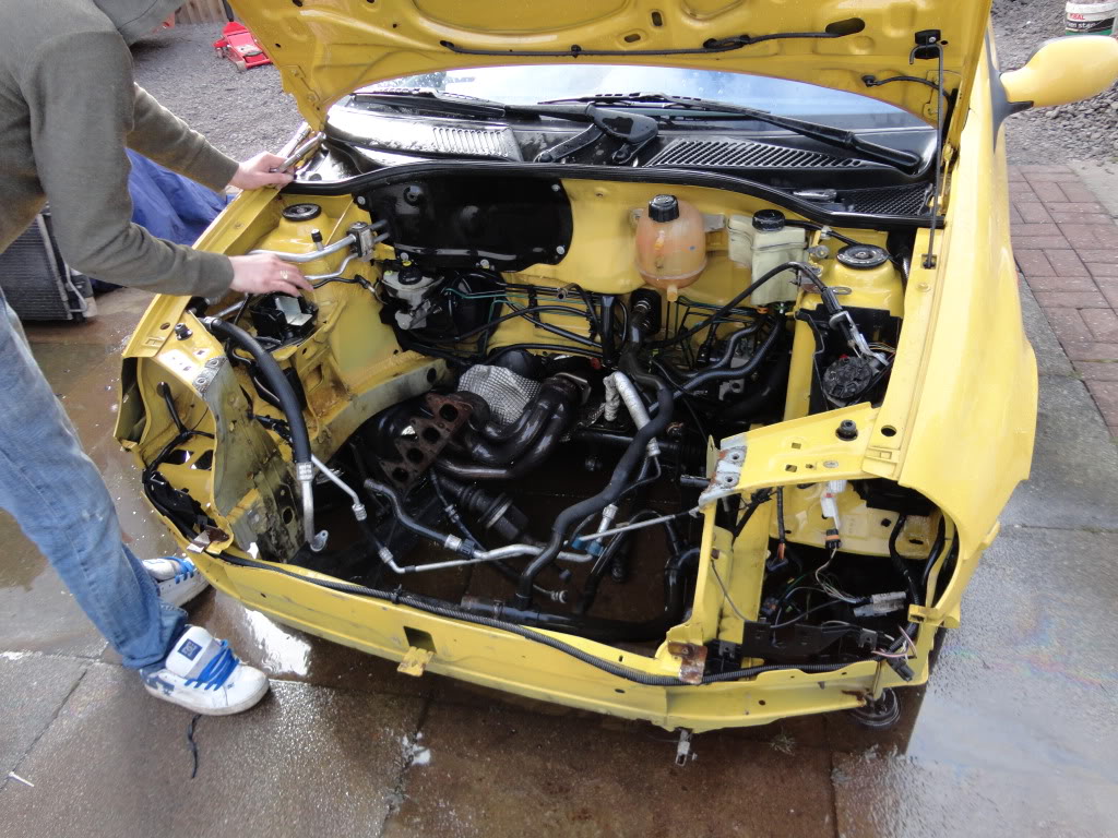

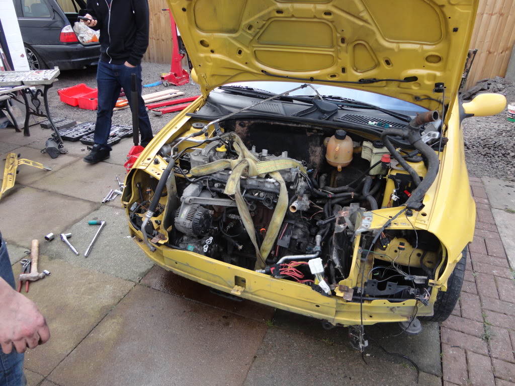

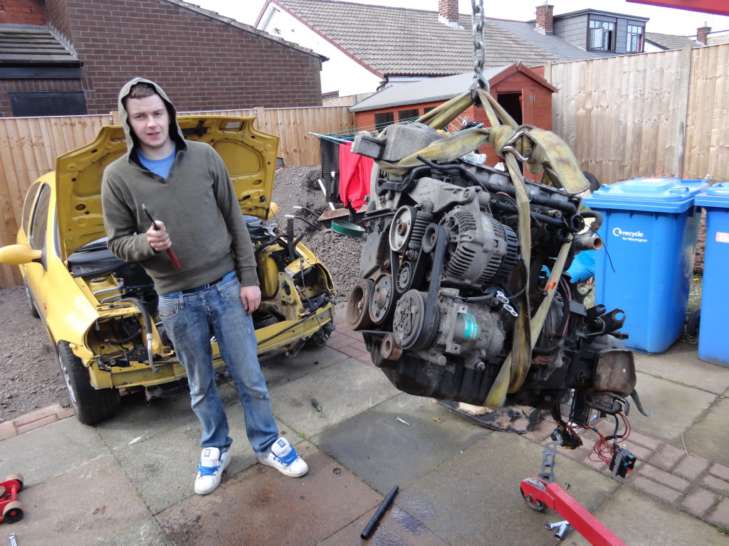

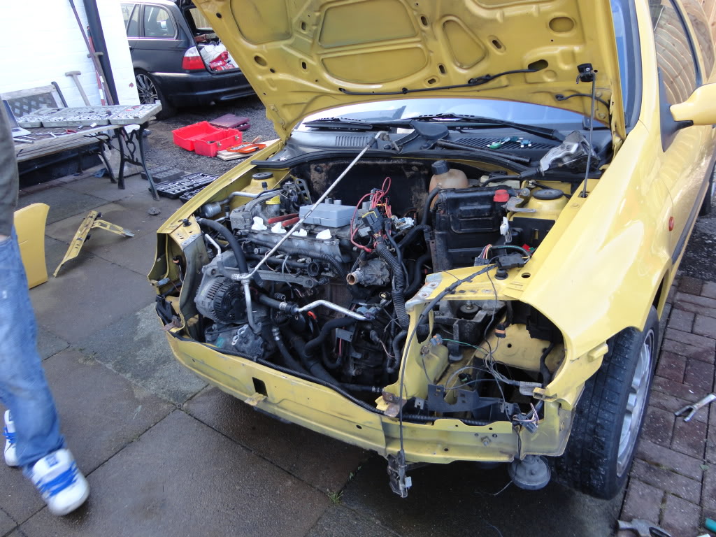

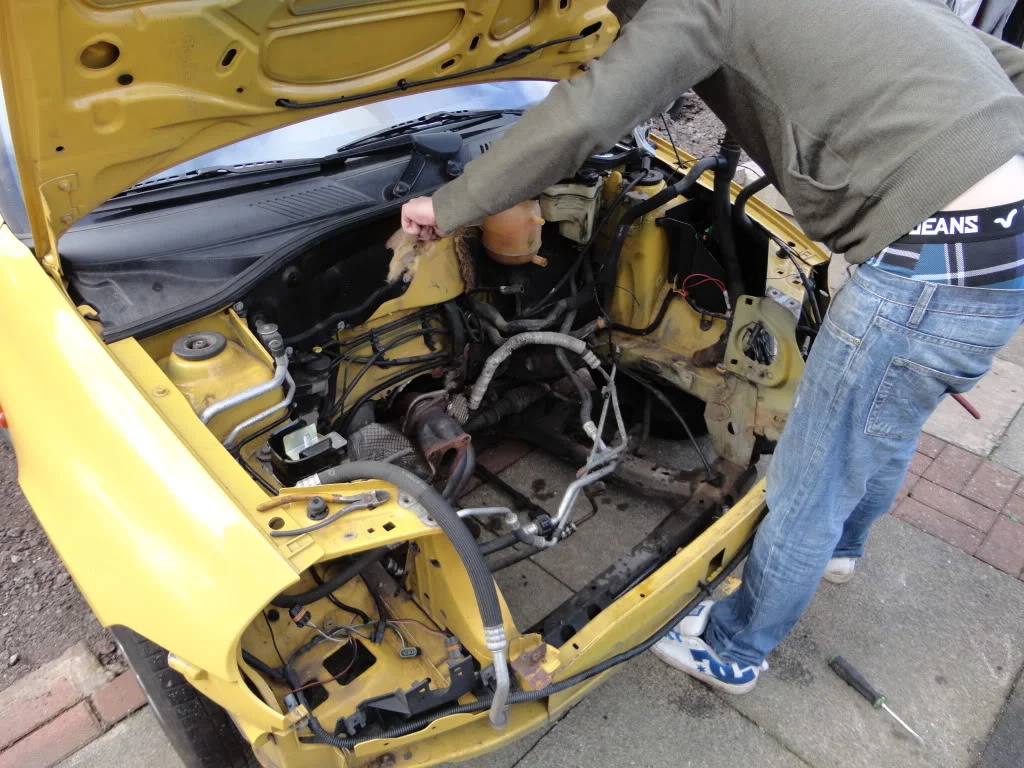

Well finally got things moving. I'm lazy and crap at manual labour so f0xy helped rip out the old engine. Early start (for a saturday). I'd already removed some of the simple stuff, so we go to work.

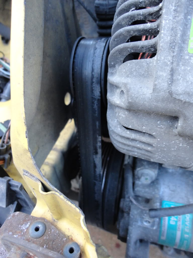

Noticed something a little worrying, so glad I'll have a fresh Aux kit on the new engine.
Had some real trouble with the O/S driveshaft, as it seems to be welded into the hub. Even smashed it with a sledge hammer and it wasn't moving. So strapped up the engine, and soon enough it was out.
Got to work ripping the soundproofing out.
Left with an empty bay, gave it a scrub with some cleaner and gave it a jetwash.
Then Cleanup time....

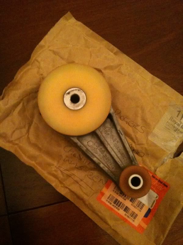

Next few updates will probably just be a tonne of purchases that I have to make; the first of which arrived this morning.
Polybushed Dogbone mount.

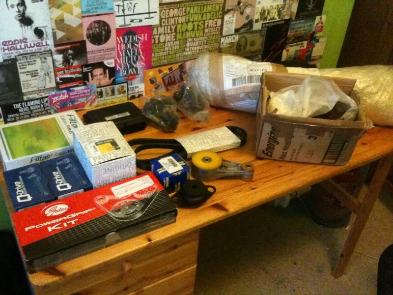

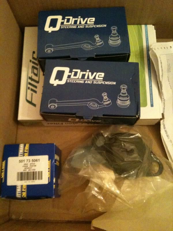

Another boring update, few little bits arrived this morning from ECP. Just waiting on a price for a cambelt kit and aux kit from an truer on here, but if anyone has any suggestions let me know.
Track Rod Ends
Gearbox Mount
Oil Filter
Cabin Filter
...boring bits.

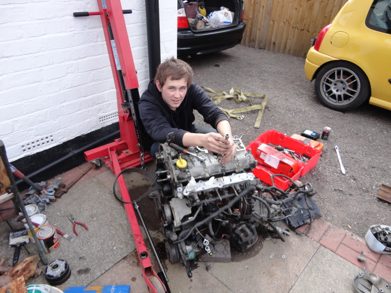

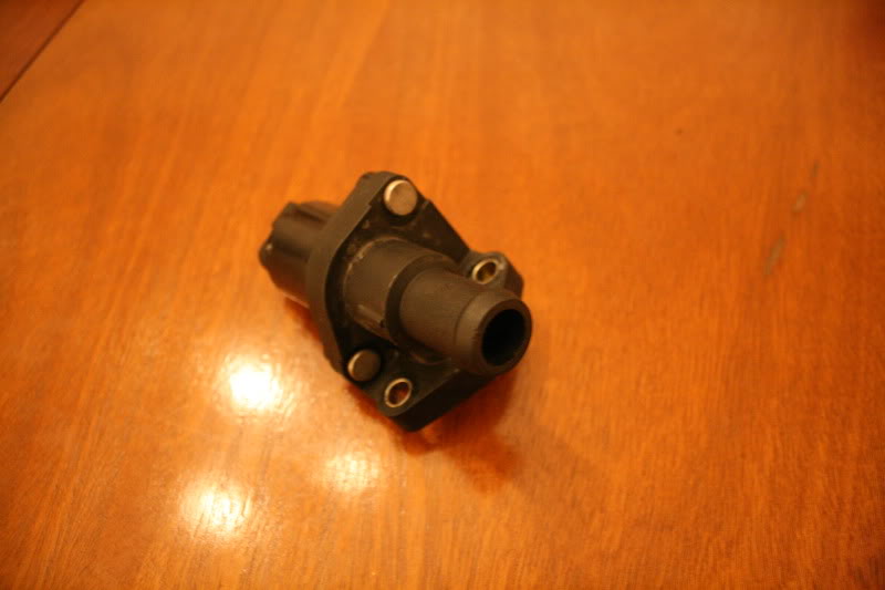

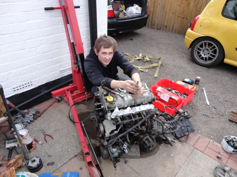

Well the engine was ripped out a couple of weeks ago, and I've spent that time waiting for parts to arrive. Also, as I'm doing most of this on favours I've had to wait until other people are free to help out. So finally when f0xy was free he popped down and got to stripping down the old engine. Friend of ours wants the head off it as long as it's in good order, and we also wanted to see what went wrong. I was banking on the oil pump having failed just due to the way it lost pressure completely at random... so we (or shall I say f0xy) got cracking.

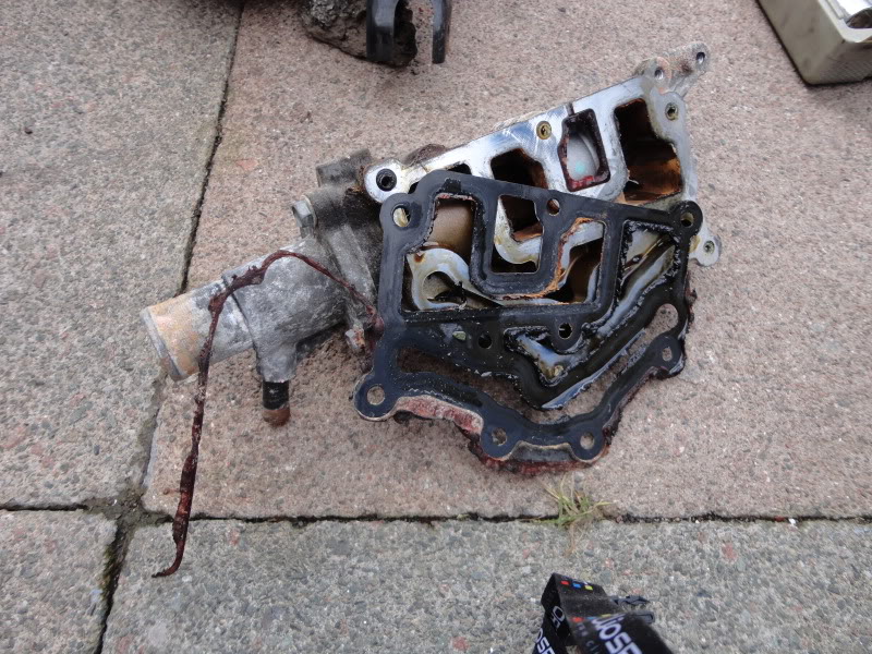

The thermostat housing seemed to be have been sealed at some point with what looks like actual faeces.

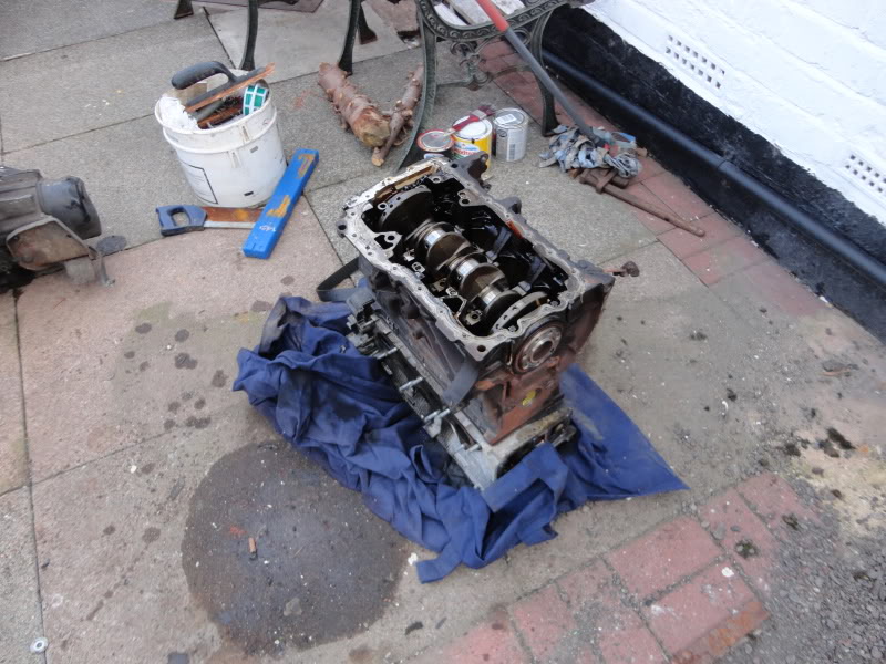

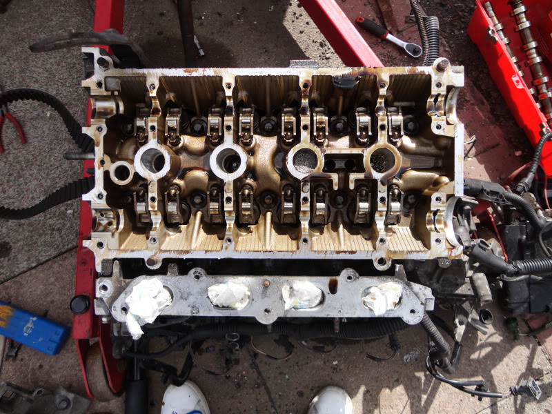

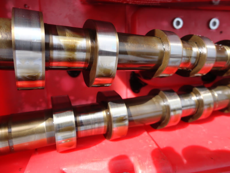

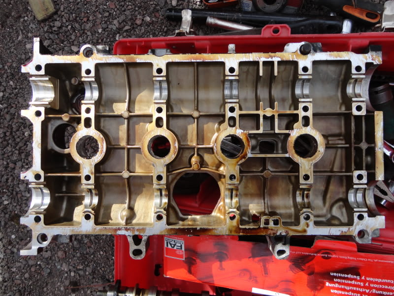

after much fiddling about, swearing and beef sandwiches almost everything was off. As you can see to our surprise there was no scoring whatsoever on the head, cams or rocker cover. Strange, but the bottom end went literally around the corner from my house, so it wasn't running very long. Also meant Adam could have the head for his F4R'd MK1.
Annoyingly, even though we were careful we rounded off the first head bolt we tried, so it'll head off to the machine shop to be milled off. Not too much of a problem as the new engine will be heading to the same machine shop to have work done.

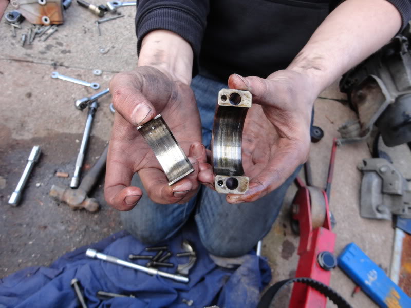

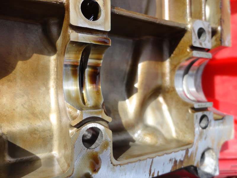

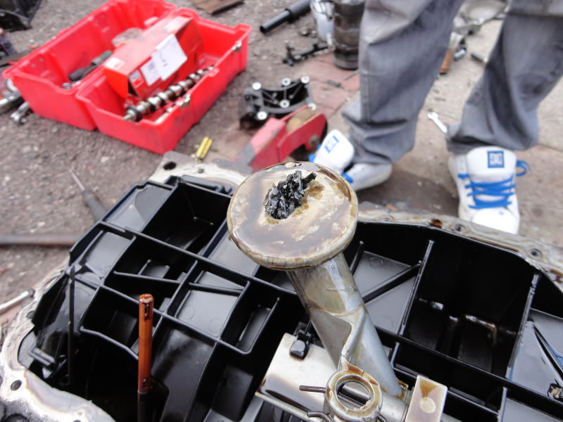

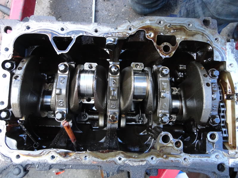

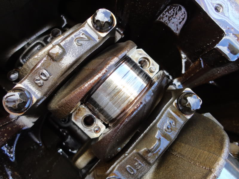

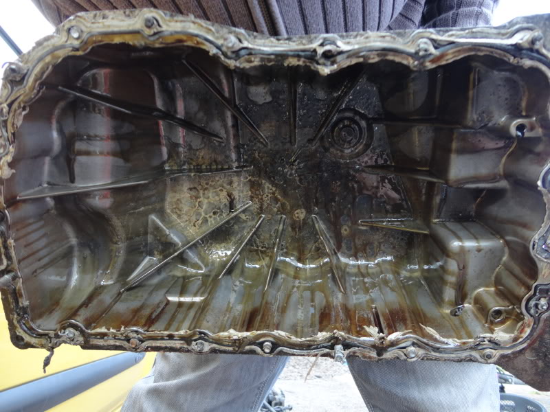

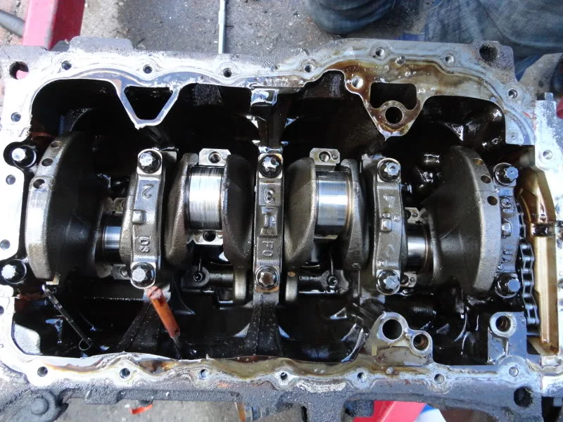

We then turned the engine over and started to take the bottom end apart. Sump came off easy enough, ready to see what the problem was. Didn't take long to find it. Well, it was staring us in the face really.
At first we thought it was metal swarf from the bottom end that had just been sucked in and clogged the pickup. After a bit of pocking around we realised it was actually sealant. Basically... when I cracked the sump in Ireland last year, my cousin and a friend had to put the new sump back on (with no knowledge of the F4R). So when they stuck on the new sump then put some universal gasket around it to stop any leaks on the drive home. It was really just a 'patch up' job to get the car back in England, yet it lasted well over 5k. After a while the sealant on the inside of the sump has degraded and broken free to get sucked into the pump. This has probably built up over a couple of months, and finally come to a head. We could see that the end of the pickup had actually bowed due to the pressure of forcing oil past the blockage.
The sump/pan looked in a bit of a state too.

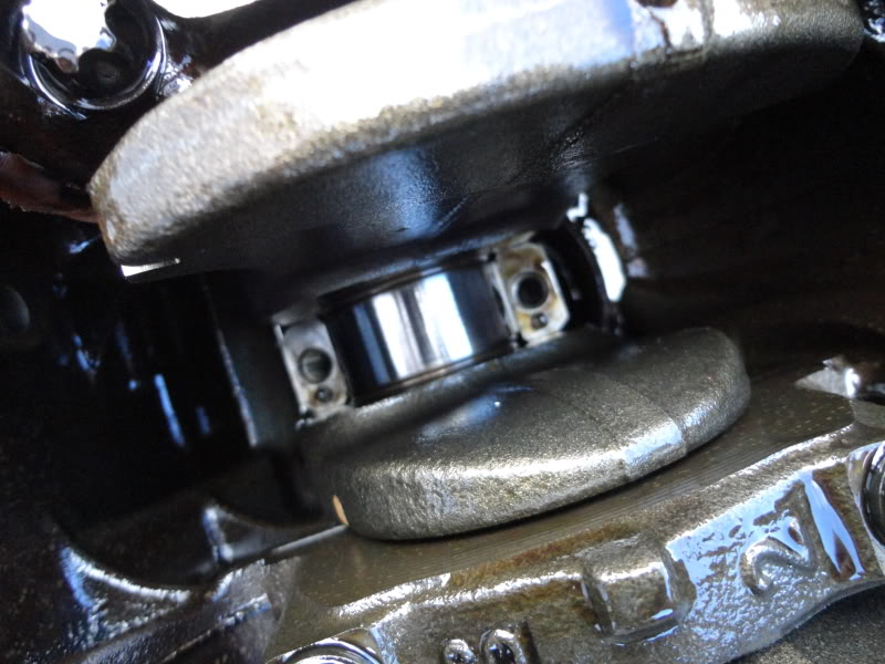

Took a look at the crank, and it was cylinder 3 that had been damaged, there was a nice chunk of swarf resting on the crank, and the bearings where also deeply scored.
However, the rest of the cylinders were immaculate, just like the head and cams etc. Again, the car only ran for 1-2 miles when I first heard a knock.

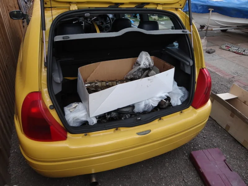

So the plan is to sort this mess out next weekend ideally, get rid of any trace of the crappy clifford alarm/immobiliser that was retrofitted at some point, and fit the new locks and ignition.
So the car is currently packed full of engine parts (there is a lot under that box)
.....and this is what's left of the old engine, ready to head off to the machine shop to get the head off, and then off to the scrap heap.
Looking at the new engine being ready in a week or two. We'll have the electrics sorted, pop the ancillaries on and stick the new engine in, new driveshafts in, new track rods and new hub on... then all should be set.
*should*

Can't edit the post, but just realised it's Cylinder number 2 that is scored, not 3.
