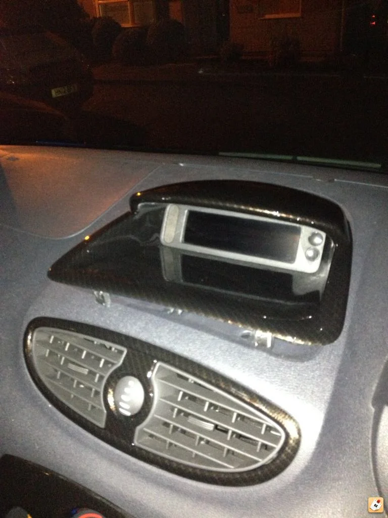

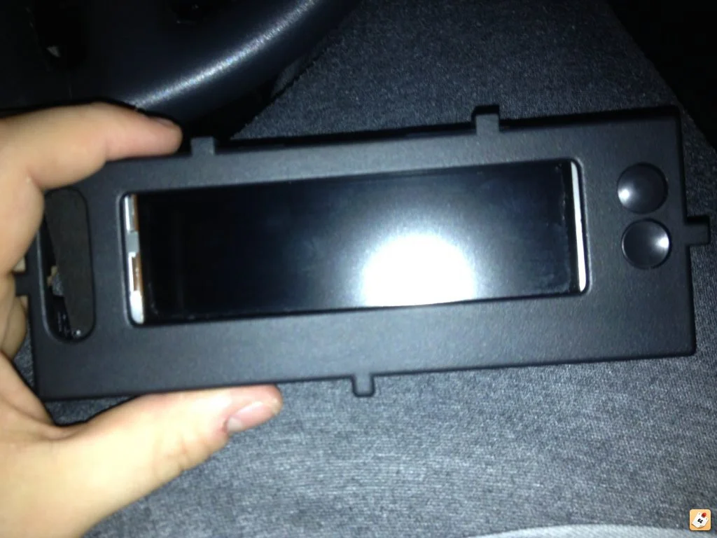

Just collected my new clock surround from Tyler. Looks fab.
Re-fitted it all, and the buttons wouldn't work to re-set my time. Hmm. Out it comes again.

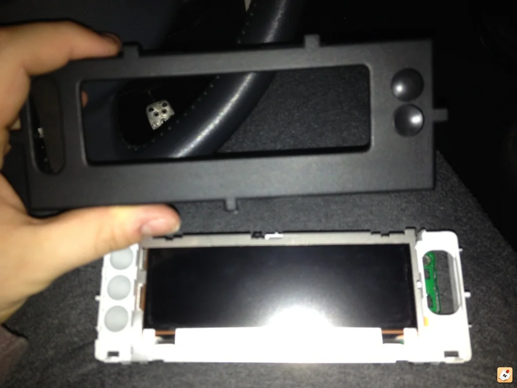

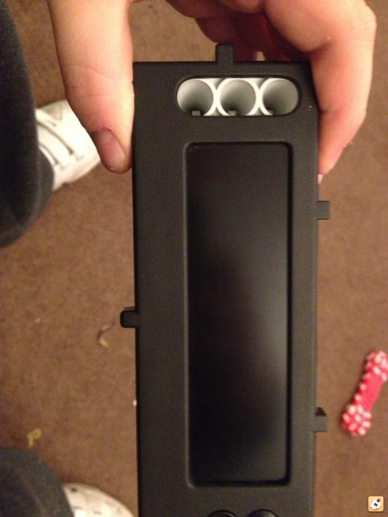

Take the clock out
Remove the case

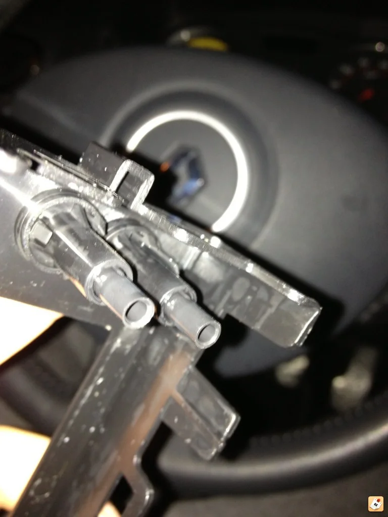

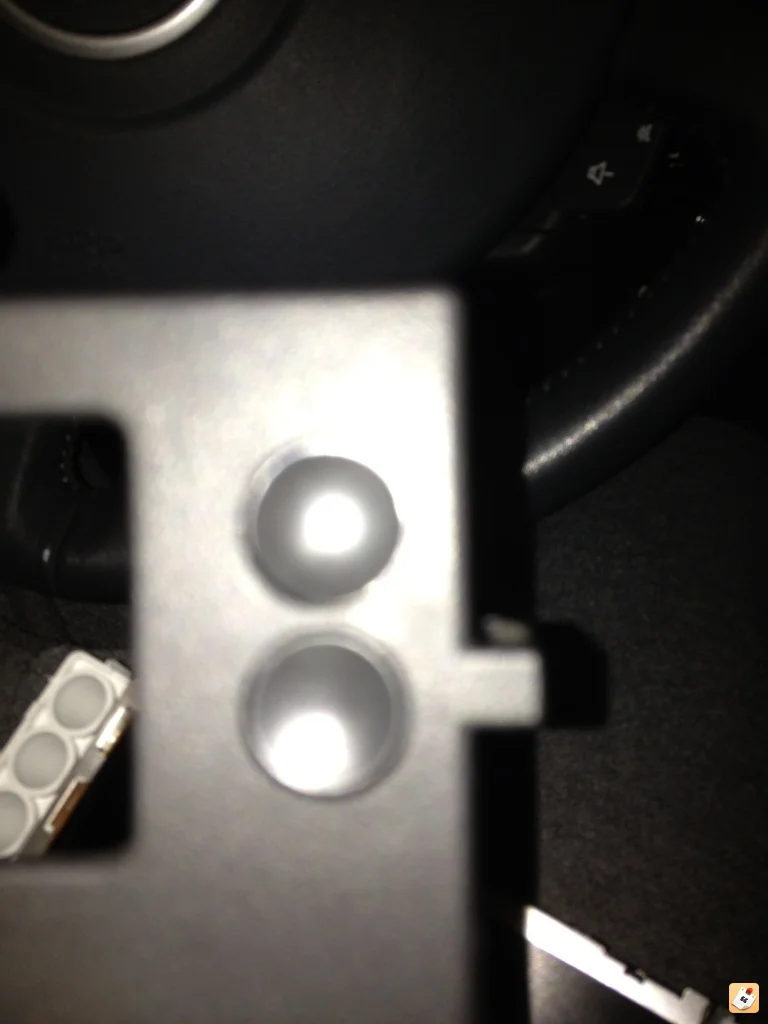

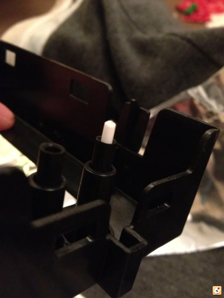

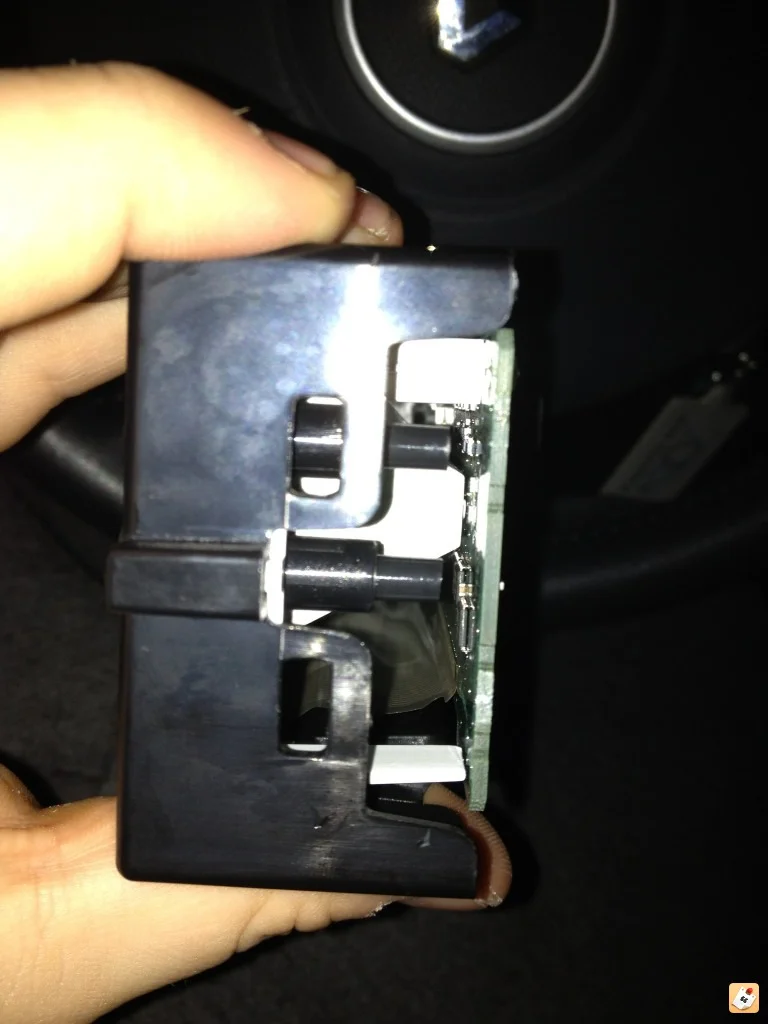

The offending buttons that do not work.

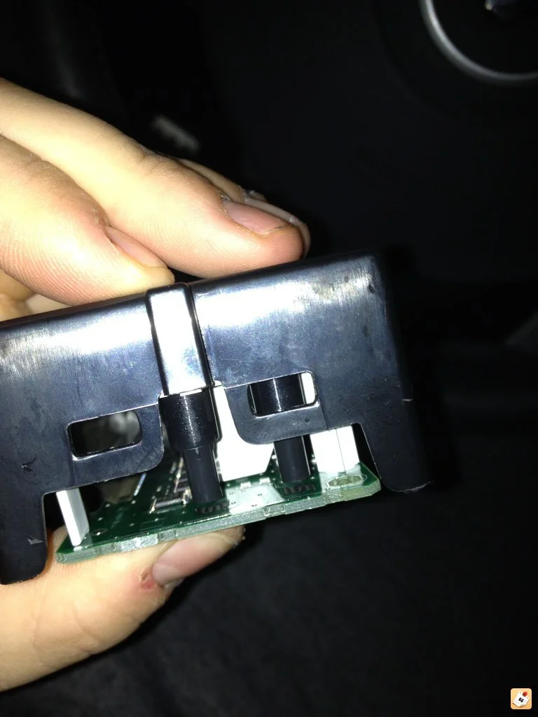

These things need to press down on the green motherboard type thing

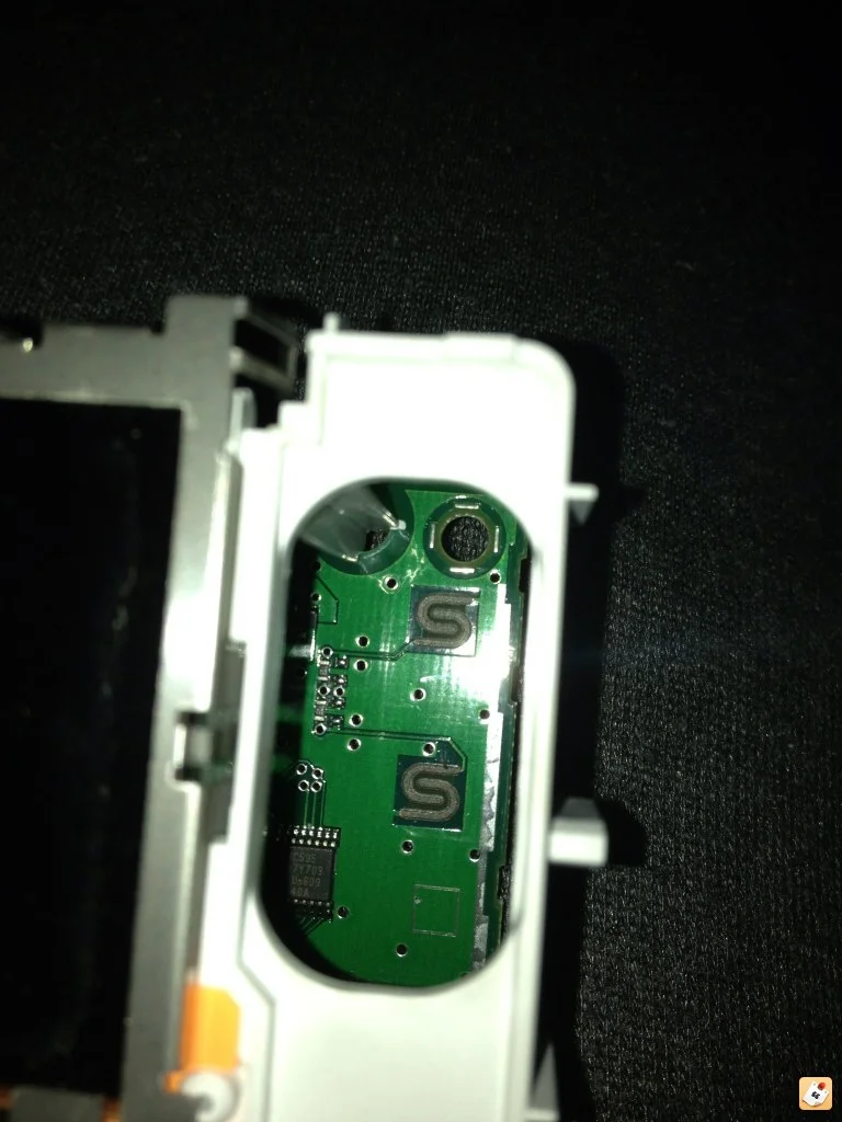

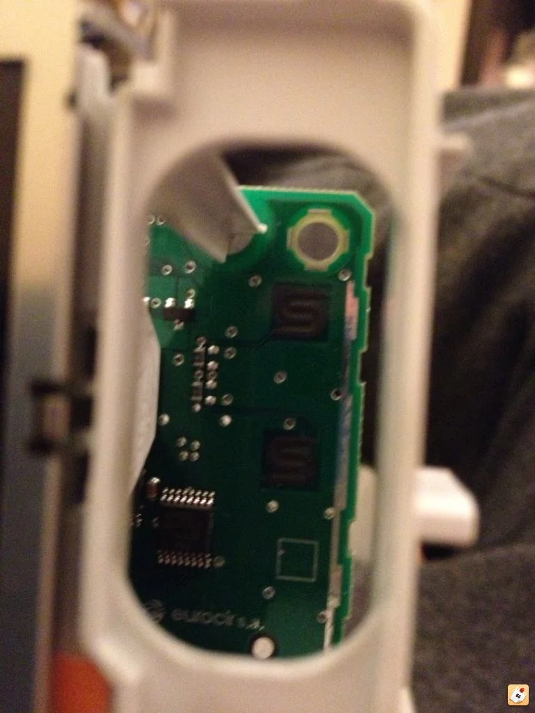

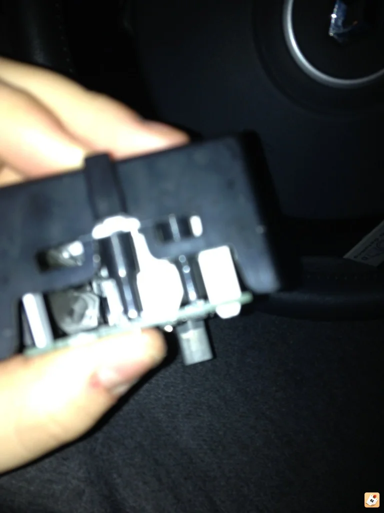

This is the green motherboard type thing, where the above needs to press down on
Now the buggering awful shittyness:

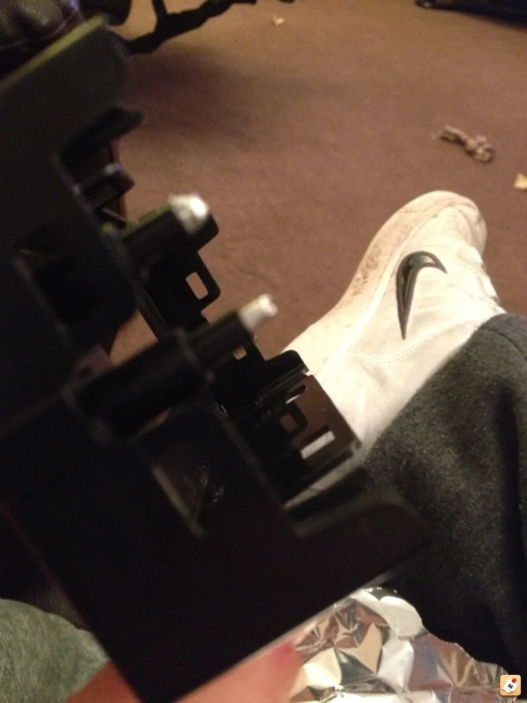

It doesn't reach. Its about a millimetre off. I assume I have lost 2 little rubber caps of some sort along the way.
Any idea's how I can fix this?
Thanks
some foil should fix that
stick a ball on the end some how that will contact the pcb
What are the chances of buggering it even more? I assumed it would be rubber and it was almost touch sensitive. Excuse my ignorance, I have no idea with this sort of thing :(
it just senses for a connection either side of the S like line on the pcb
it will be a conductive rubber on it originally
Dink, you're a legend. Thank you SO much.

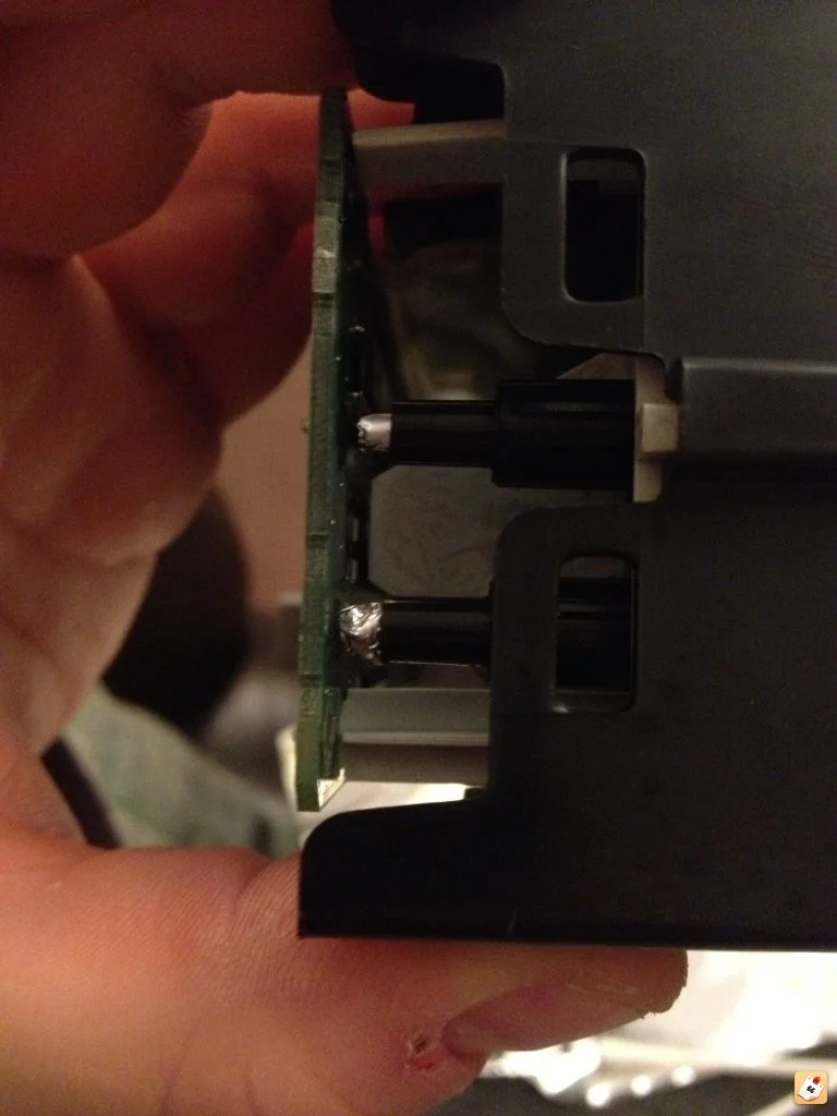

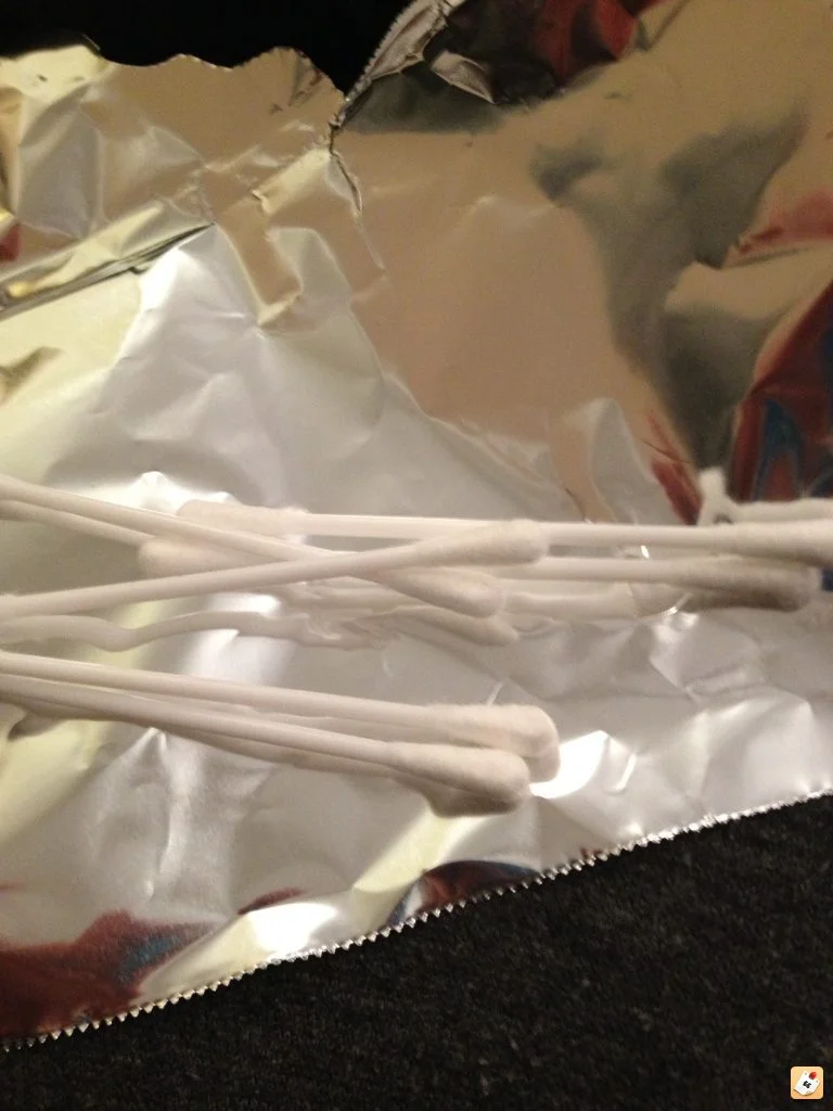

I grabbed these:

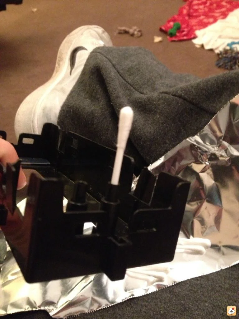

Started like this
Chopped down
Foil wrapped

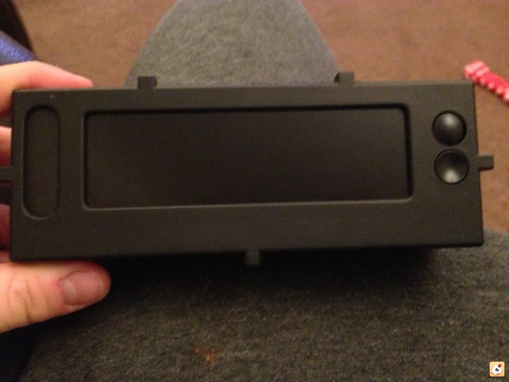

Put it back together. b****cks. Missing another bit!
Found it

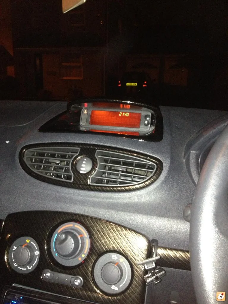

Fingers crossed.. And BOOM!
Thanks again
