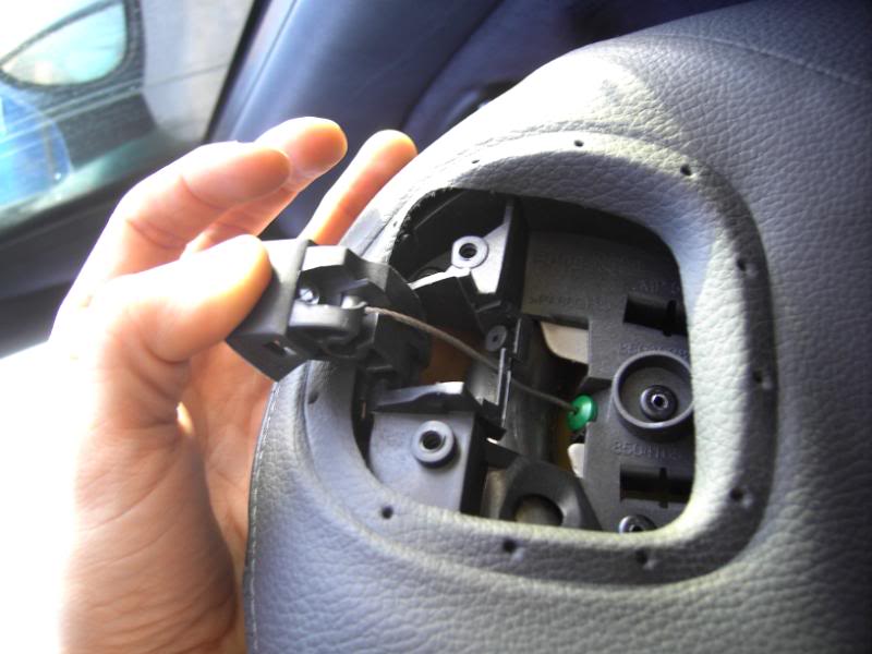

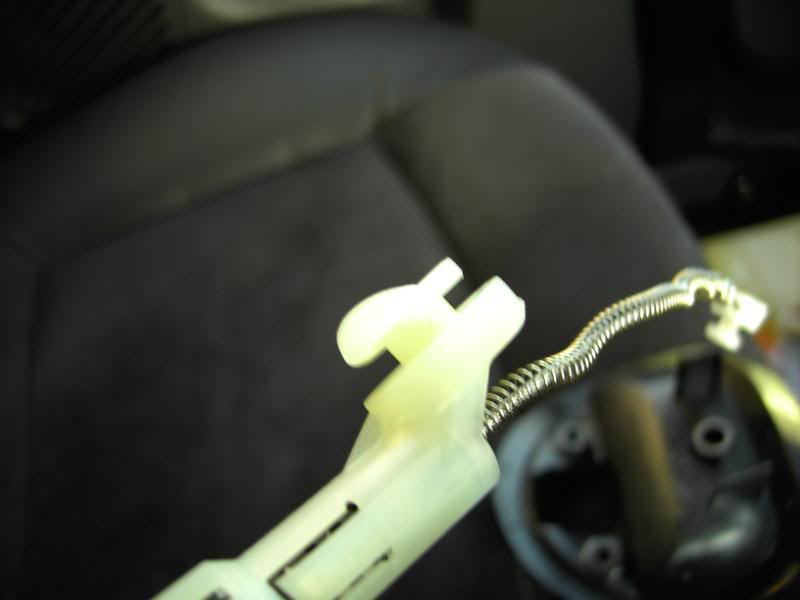

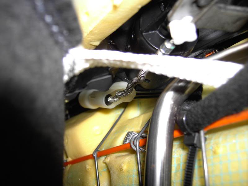

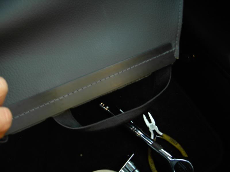

I fitted a new cable yesterday. It took about 45minutes, but now I know how to do it I could do the next one much quicker. Its quite a simple job to do, but is a bit fiddley. I took some photos and could put a guide together if it would be useful?
A few pics:
This is looking up the seat. On mine the upper of the two little white plastic bits had broken and wasn't pulling the bar enough to release it.
The top of the cable in the handle.
Seat cord, holding the seat cover to the base. There are three cords which are just on little hooks.
Its difficult to make out, but this is the broken bit.

Hi, I have the same problem. I have bought a new cable and threaded it through, the problem I have is figuring out how to attach it at the handle. I have removed all the screws as directed but cant see how to connect! Any advise??

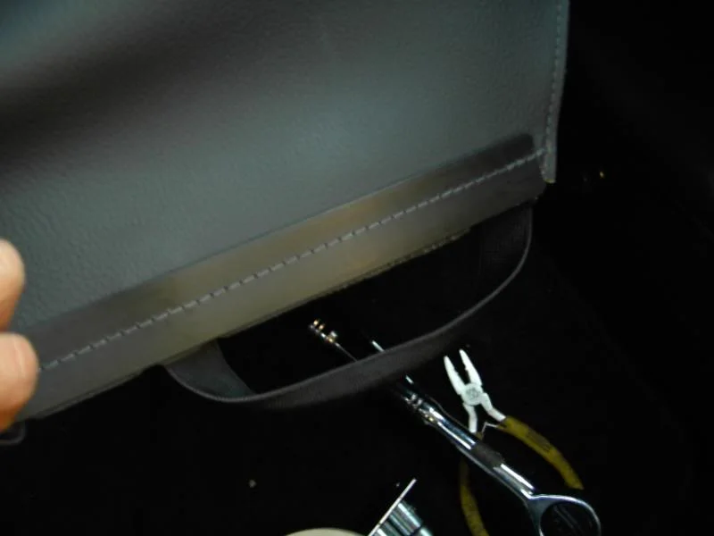

A few pics:
