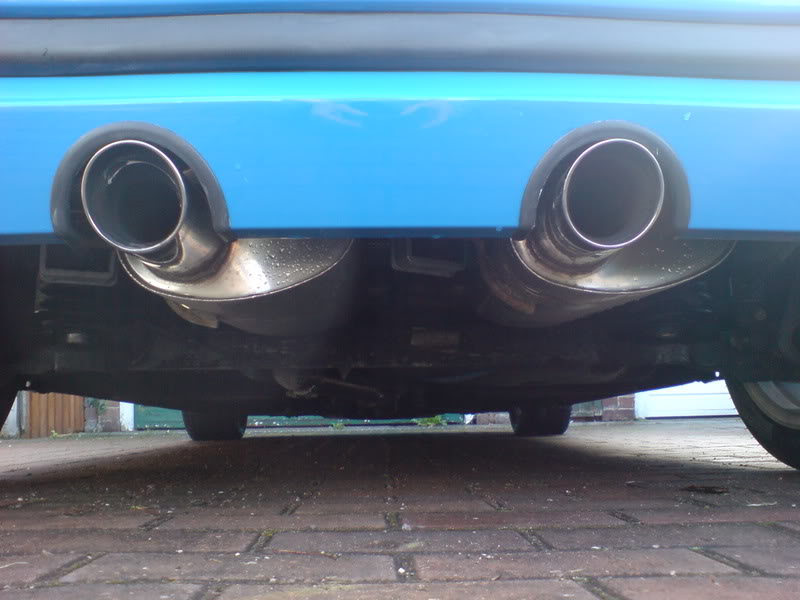

have been running my btb with a yozza decat for the last year or so, im sure ive got a clip some where..........
edit: i cant access photobucket at work so will post up a little vid when i get home later on
  VRS
this was taken with my phone last summer, imo the yozza doesnt change the note of the btb too much
i may do a better video over the weekend if i get time but hopefully this give you an idea
you may have to crank the volume up as its a bit of a quiet vid
