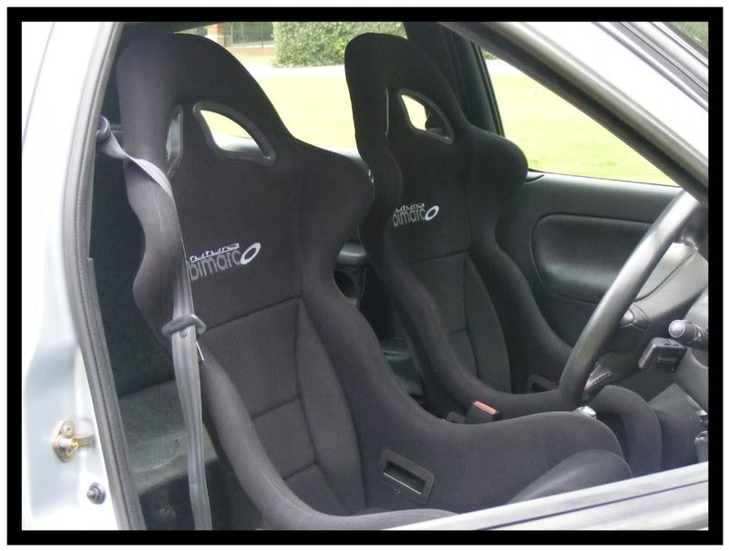

Theres a good chance i'll be putting together a few Futara bucket seats + adjustable custom sub frames & fitting in the near future...
Fitted to my 172
Will be in the region of £700 for 2 seats & custom sub frames & fitting, which is veeeery cheap compared to others on the market :cool:
