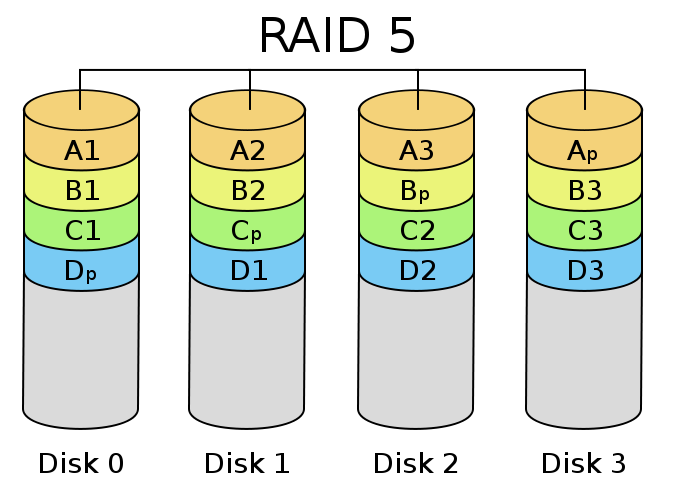

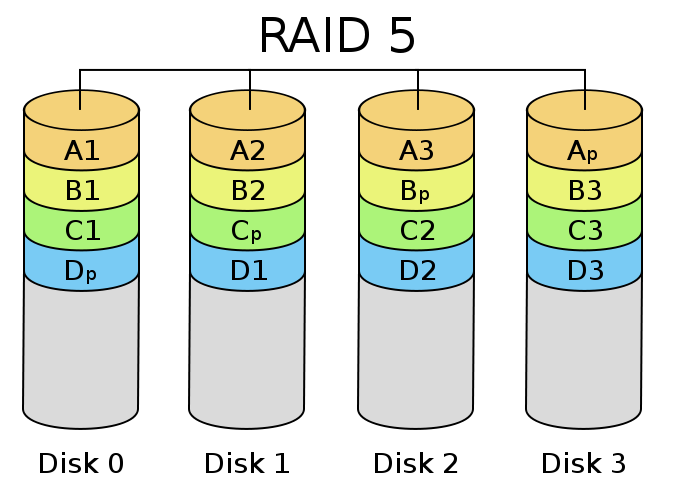

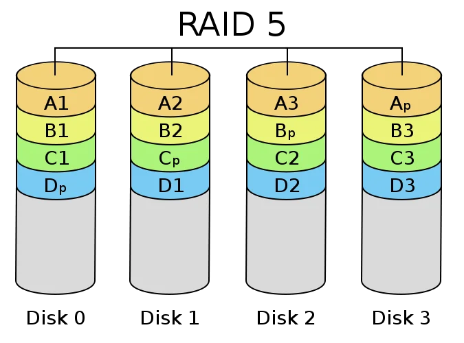

Im cant get my head around how RAID 5 works with its 'Parity' Blocks? Take this diagram for example...
Say Disk 1 went down, you loose part of A, B, D and C's Parity Block... How would fitting a new drive rebuild A, B, C and D when C's Parity block has died? What is the Parity block?
Nick
KDF
  Audi TT Stronic
In laymens terms !
If disk 1 went down, you would loose
A2
B2
Cp
D1
We have parity data for A on 3, B on 2 and D on 0.
We don't need the parity data on the failed disk because non of the C data is missing and a new parity table can be rebuilt from the existing data on the remaining disks.
If you don't understand this then may I suggest that the 3 week time window you gave yourself to learn everything a pro knows may not be long enough ?? :rasp:
