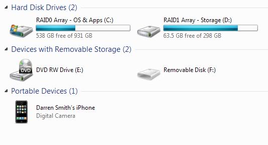

I have 2 x 150GB mirrored 10,000 rpm raptor HDDs for my OS, then 2 x 1TB mirrored HDDs for everything else

As its been a while since i have updated systems myself, but it appears the intel controllers will do RAID aswell.
Never bothered with RAID myself. My machine uses an old Raptor for the OS and a s**tty 200GB for program files, 90% of which is empty. I have nothing on my game rig apart from Steam and a few games. Those two discs have done me proud for quite a few years now. HDDs rarely have an impact on in-game performance anyway so it's not something that concerns me.
