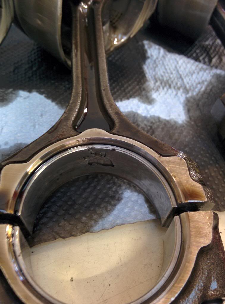

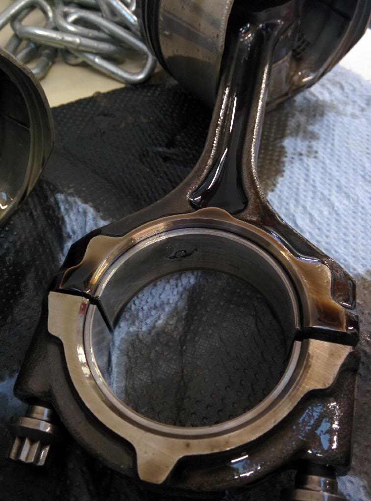

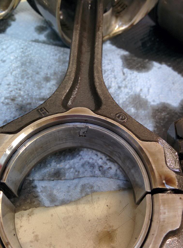

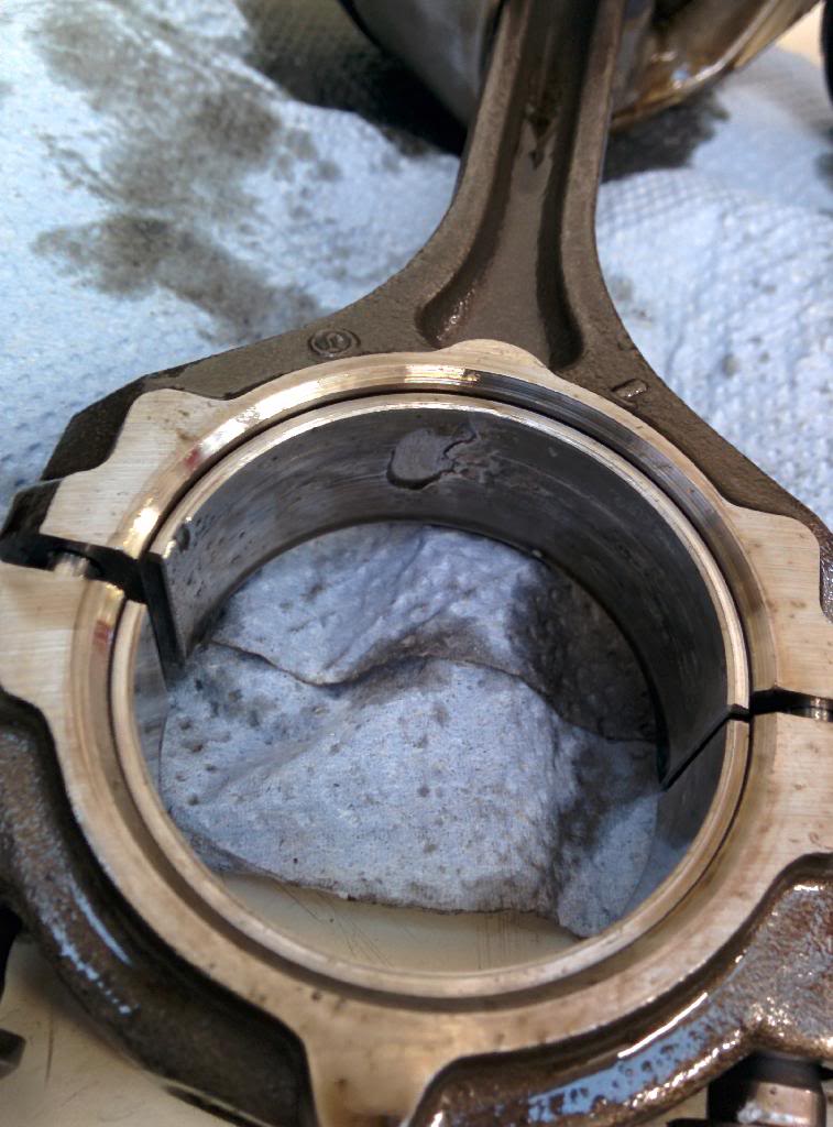

So this is what happens when you contaminate the fuel by mapping WAY too rich, then rev to almost 8k for 2 seasons of racing. Bearing coatings have been smashed to pieces! Thrust face of the crank was also eaten up, but didn't get a picture as I threw it in the skip outside the machinists in disgust.
detonation pin marks on every piston so they're scrap, all the bores were shiny (bore washed by running rich)
Start again......

No I didn't. I had a look at it mid season last year for Tony as he said it was getting slower, then found the over fueling. Leaned it off 30% or more in places but the damage was done by then :(

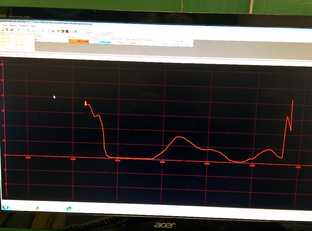

That's horrific! You expect a very highly boosted engine at around 8-9 on full chat don't you? Not an NA engine!
No not really, beyond about 11:1 you're not gaining anything from cooling on even a huge boost turbo 11.8:1 is average target AFR for WOT on boost. Go too rich and you actually encouraged knock. Should be between 12.5 and 13.2:1 on WOT. Below 4k there's no need to go richer than 13.6:1 really.
1 AFR point is approximately 15% so you can see how far out it was
I've been looking into the ECU software, and every setting in the original map, I've not found a compensation table that isn't wrong yet. Its just all crap
After reading that it's even scarier how far out it was. I've probably missed it but was this engine ran for a full season? I'm seriously surprised it last that long if it did.
