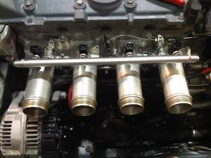

Now it has cam's in, the old set up was restricting it.
Went from 205 bhp to 212 bhp
So it now runs a Pipercross sausage on the front. Thanks Dan at 519 for that late visit.

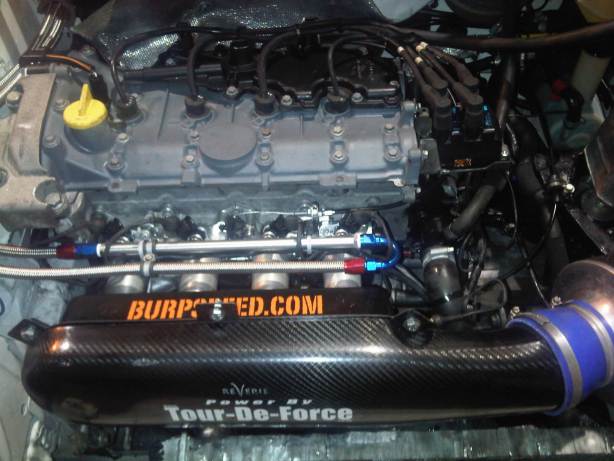

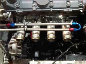

Were booked in at Tour-De-Force next week to get the new engine calibrated, in the meantime there is a few things we needed to finish off. For the last 2 seasons the car has run the standard plastic road car fuel rail, we have never been happy with the way the fuel lines joined together, it was a possible weak point.
We decided to swap to a solid AT Power fuel rail, also increasing the fuel pressure with a new regulator at the same time. It was a
fairly straight forward job.

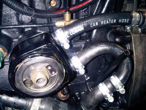

We are quite pleased how neat the fuel lines came out, the 180′ bend was quite expensive but makes a very tidy job of it. Another little job that we finished off was to fit an oil cooler/heat exchanger.
So that’s the engine bay complete and we’re all ready for our trip to TDF to see how many Gee Gee’s we have to play with this season………

What size of fuel lines did you guys use if you don't mind me asking?
