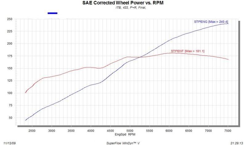

there you go. can see how with 421s and stock-ish compression, the peak torque plateau is reached quite a bit earlier. you could almost shuffle the curve over by 1000rpm. I like lower rpm torque gains :)

well, more the cams. High comp with 421's would be a nice graph to see (although I've seen it done, and IMO the cams held the engine back at that point) and 422's with stock pistons, remachined with larger valve pockets is also an interesting proposition. There are a lot more combinations to achieve different things than the obvious popular ways :) Of course, obvious and popular is normally cheaper and easier, hence popular

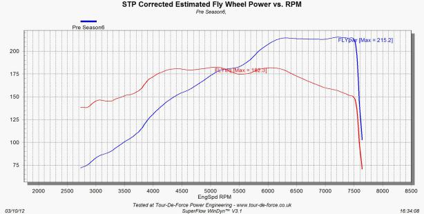

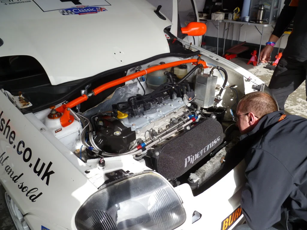

We went up a few weeks ago and despite a small problem with the fuel lines, all went well. The new engine was run in on the dyno and the low RPM stuff all sorted pretty quickly. It made a decent power figure but Matt at TDf thought there was more to be gained. The theory being that the carbon airbox we ran before was causing a restriction with the new spec engine. we took the box off completely and the car instantly gained 6bhp. We left it as it was and went back to sort out a different filter for it and try again.
Kinda glad I didn't buy that airbox now :P
Looking really good this year guys, that torque curve is immense!!

It was spot on for s stock engine. No mention of cams going in yours. Would of thought it obvious we got rid of it due to not suiting our new engine.

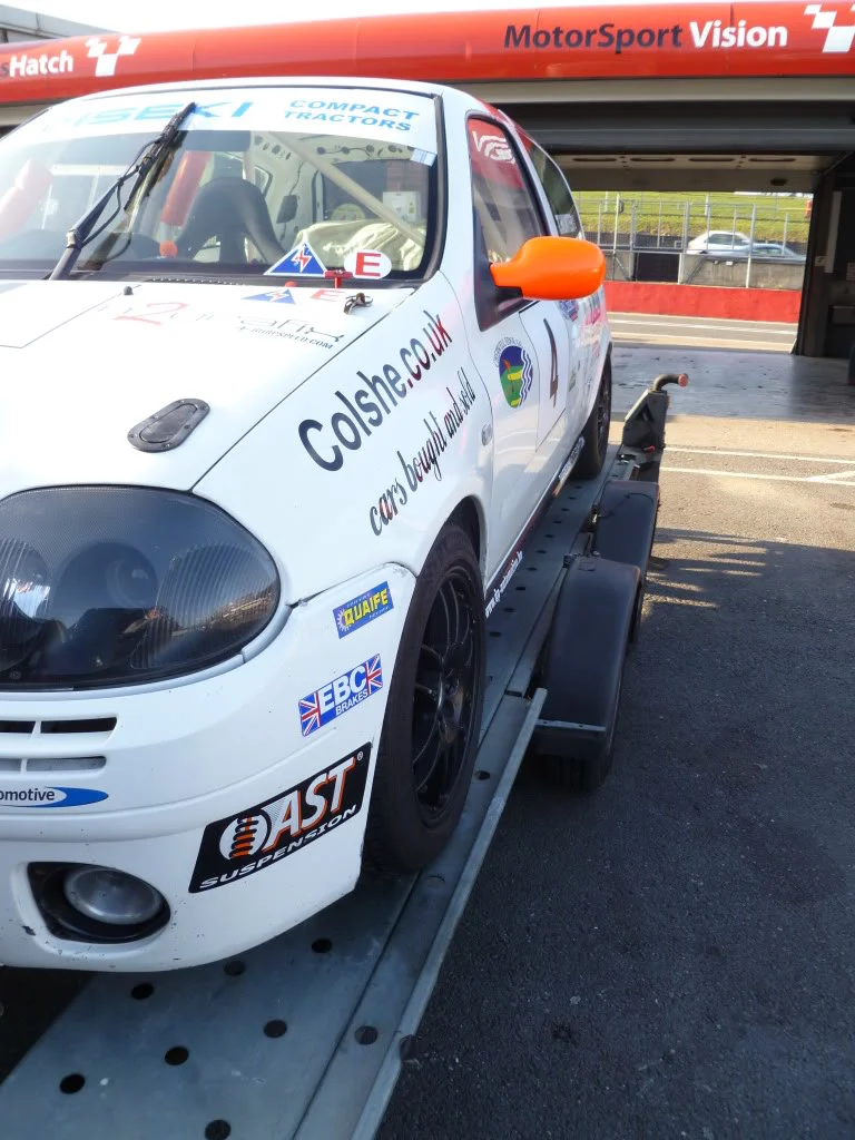

On our way back from Brands now. Had a pretty good day. Nice to shake the rust off and get comfy in the car again. Cameras were rolling so we will see if we got any decent footage. I had 2 clear laps all day. Lol
Car balance is good. Made some minor tweeks and both happy with the car.
The engine is MENTAL!
Sounds good from the inside too :)
