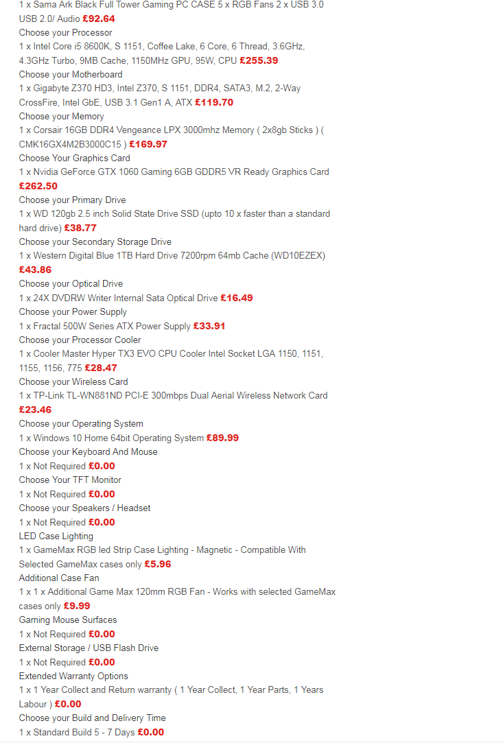

Looking at a gaming PC but not sure what spec he would need, now ive found this one which is local to me.
https://www.ebay.co.uk/itm/Gaming-v...1060-32GB-Ram-256GB-SSD-4k-Ready/163170900064
Billy has spec one on Fresh Tech, anygood?
Total £1191
Is there anywhere else i should be looking to get one built or is there someone on here who can do it?

Build critique:
I think you could build something less GPU limited than that for the money. I'd sack off a HDD, 120GB SSD is a bit small these days, 250GB is about £100. Probably less.
That CPU cooler is lame, the PSU looks weak but then hardware is more efficient these days so maybe it's enough.
If you're building yourself (surely that'd be a great father/son thing to do? especially if you've never done it before) then:
Pick graphics card first, I'm just throwing figures out there, but I'd say if you have £1200 to spend on a machine then try and spend £500 of that on a GPU. Maybe even 600.
I'd rather have a s**t looking case and previous gen mobo/CPU and graphics on high/ultra than a CPU I don't utilise and graphics on medium.

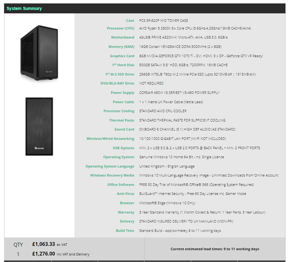

That’s an example of what you can get for your money.
I would get a copy of Custom PC and having a look at what they recommend for different price ranges. Obviously nothing is definitive, but it’s a good guide on what’s worth buying. If you can’t find the magazine then drop me a pm.
Mr R.
  A special one.
Many thanks for your time mate, is the one you've spec alot better than the one I posted for around the same money?
Daz...
  Inferno 182 Cup
It’s got a better graphics card, cpu cooler and power supply. There’s also more than double the storage space.
Like I said, you can still look through and change some bits for cheaper if needed.
I also haven’t put a copy of Windows 10 on the list.
Daz...
  Inferno 182 Cup
Just noticed the motherboard hasn’t got WiFi built in so that’s something to consider. I’ll blame the football, I was half watching it whilst doing the list ?

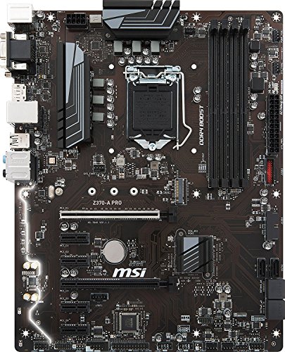

MotherboardView attachment 1378684
MSI - Z370-A PRO ATX LGA1151 Motherboard

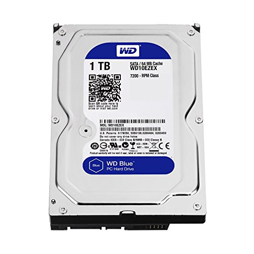

Western Digital - Caviar Blue 1TB 3.5" 7200RPM Internal Hard Drive

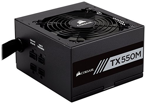

Power SupplyView attachment 1378690
Corsair - TXM Gold 550W 80+ Gold Certified Semi-Modular ATX Power Supply
This machine would demolish anything you throw at it. £1100 all in. Could save £50-60 by purchasing a non-K CPU as I doubt he will be overclocking the system.

500GB M2 SSD As the boot drive (m2 plugs directly into the board and is generally a little faster than SATA and takes up less space/no cables) and for storing the games he plays most, the 1TB Platter drive for long term storage/movies/music etc.
