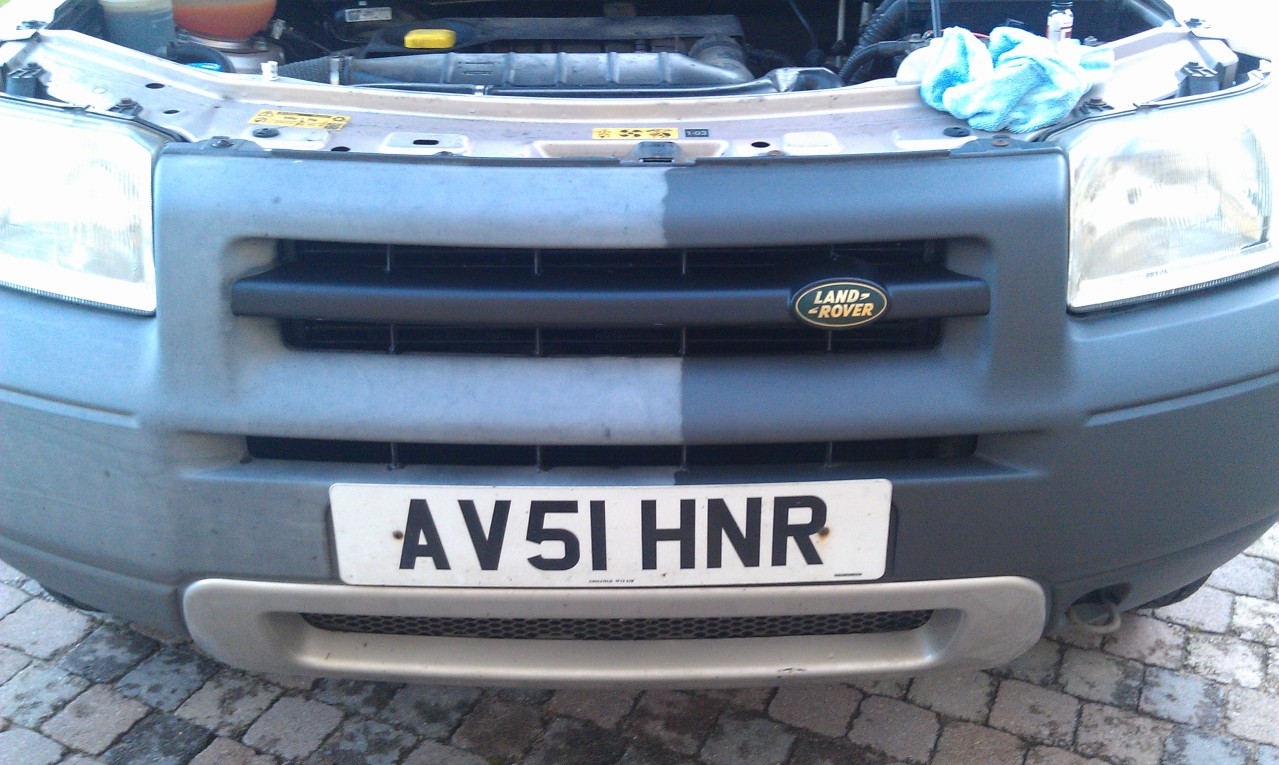

50/50 (ish)
And Finished

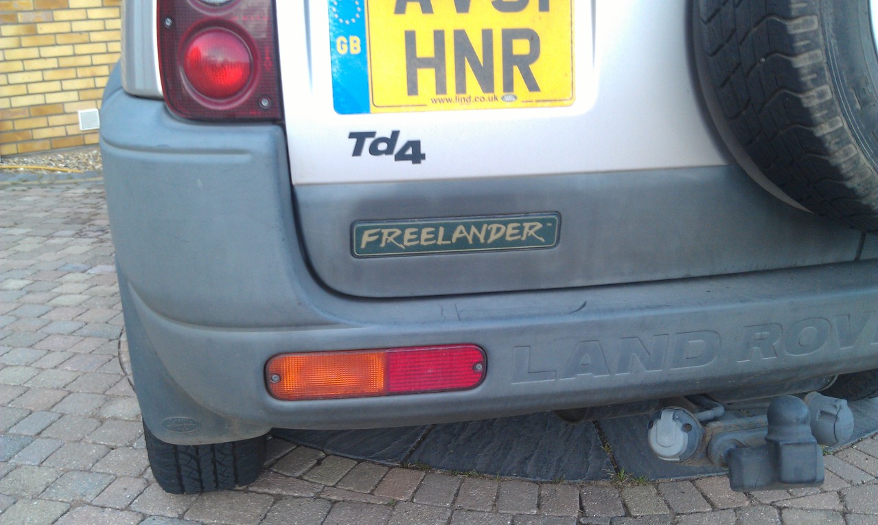

Just got to move onto the arse end now

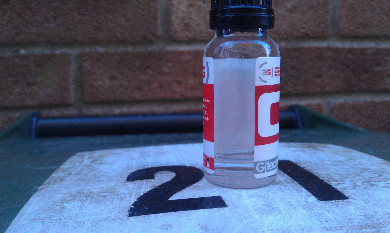

Although I shall need another bottle to finish it off 15ml was not enough and it wasn't exactly full when I got it. IT was just abelow the top of the label. I wondered if I was overusing it to start with (being the first time I have used it) but one quick "dab" I would continue to use until it ran out IE wasn't covering anything.

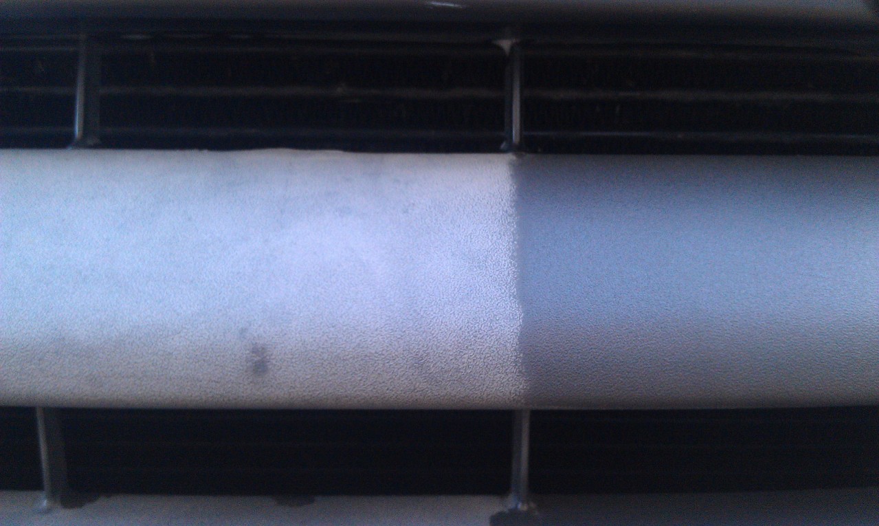

it doesn't spread quite so well on textured plastics as it does on painted panels / wheels IMO.
On that amount of plastic I don't think I would ever want to be reapplying every few weeks or months depending on product. Worth every penny when you see the difference there

If you don't use it that often I wouldn't. After it's opened it's performance will diminish after a length of time. Smaller bottles are better in most cases.
  Bumder With A Buffer
They reckon 2 years. I'm more inclined to think a year maximum on this car as the bumpers take a pounding due to their size.

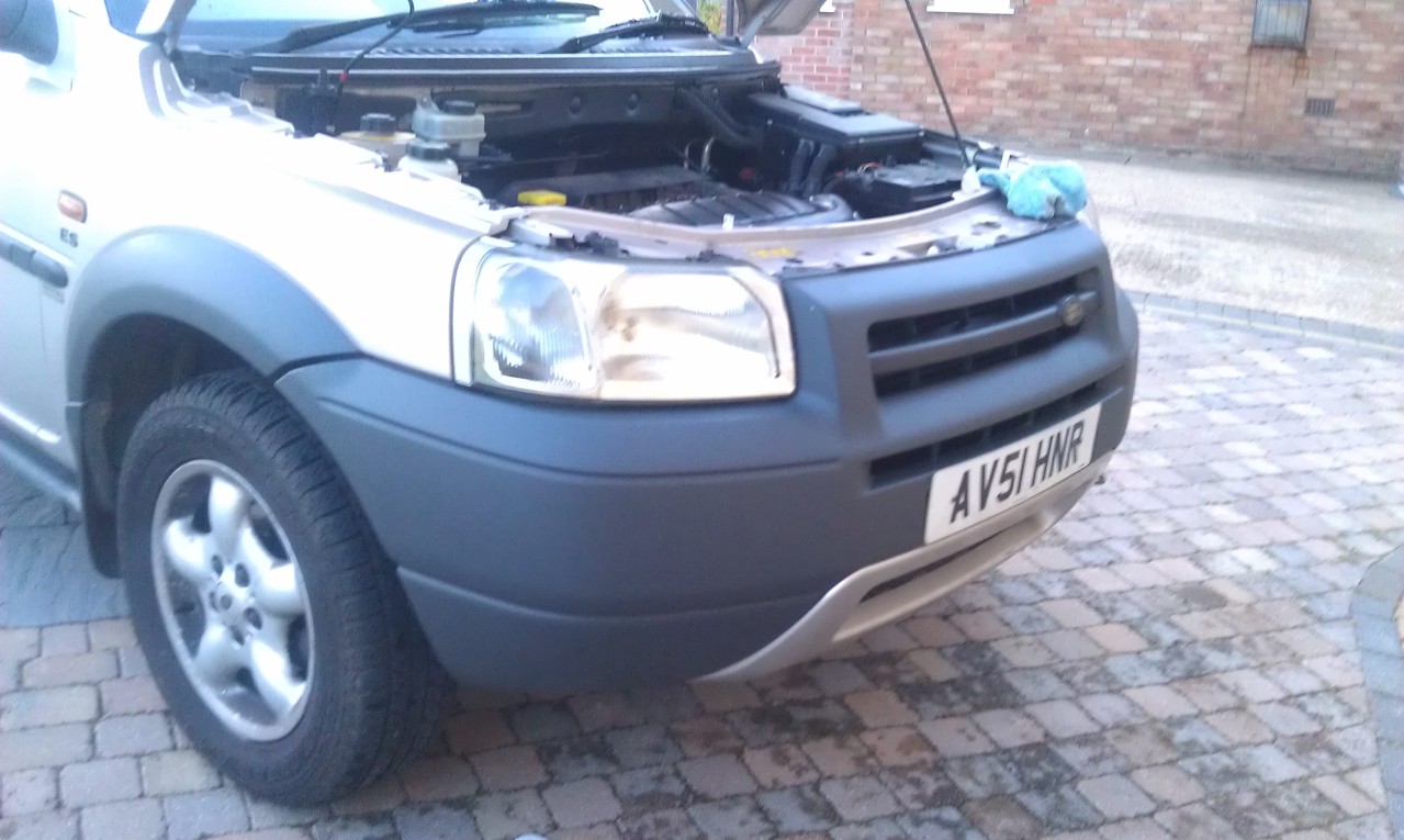

Dave that's exactly why I finally decided on C4...got fed up applying products to it every 3-4 week's.
Ol see if this is money well spent soon enough. I did a test piece last week and it hadn't budged unlike most of the other dressings I have used.

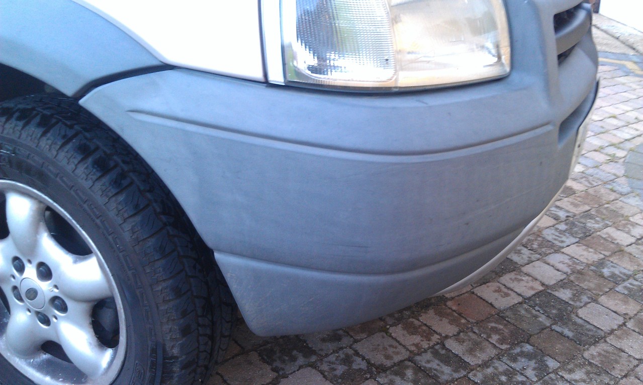

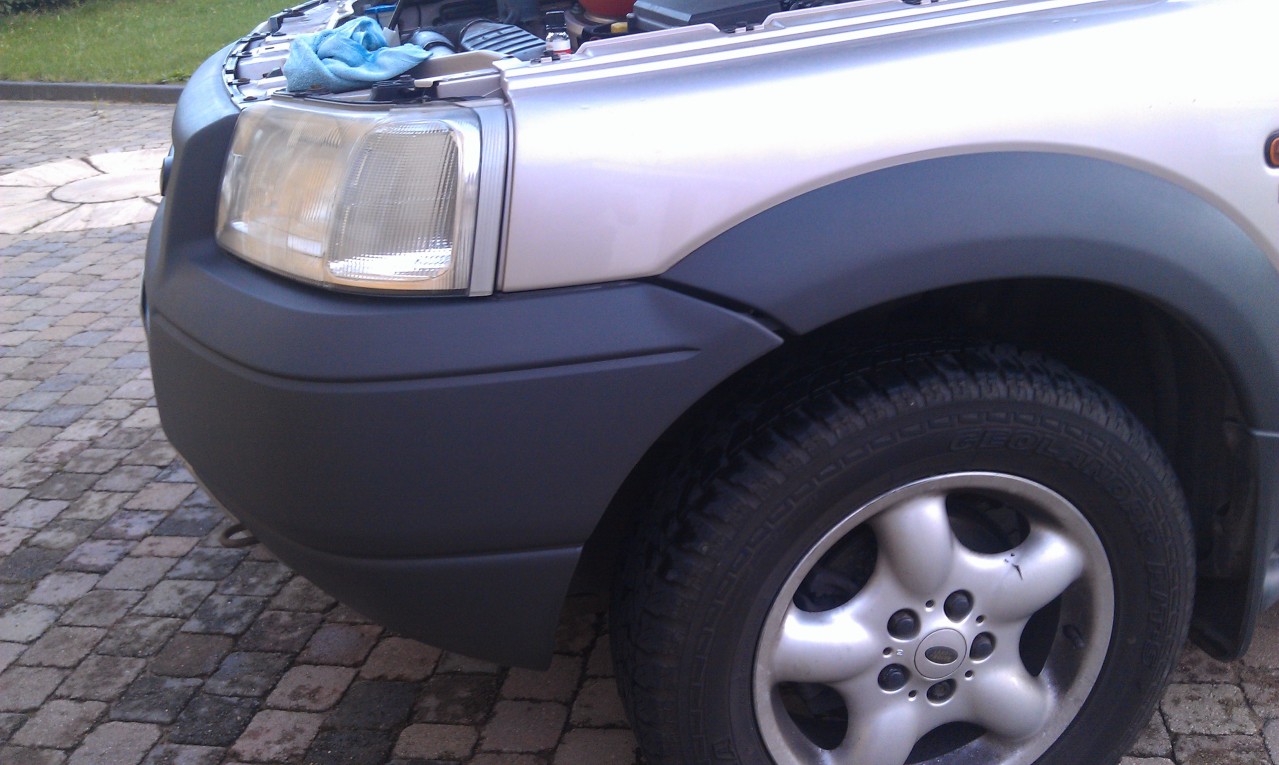

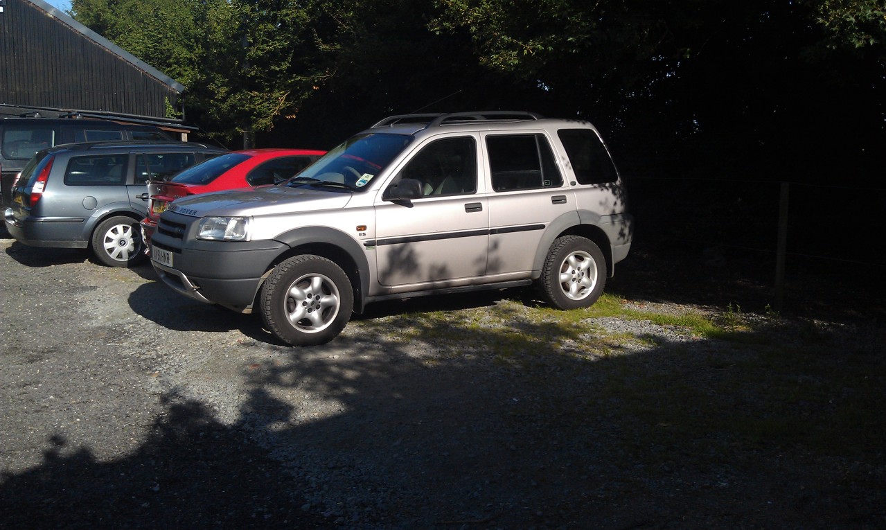

Managed to get a side on view this morning and its mental to see how faded it was before. The front was worse then the back for some reason.

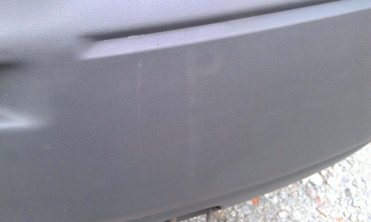

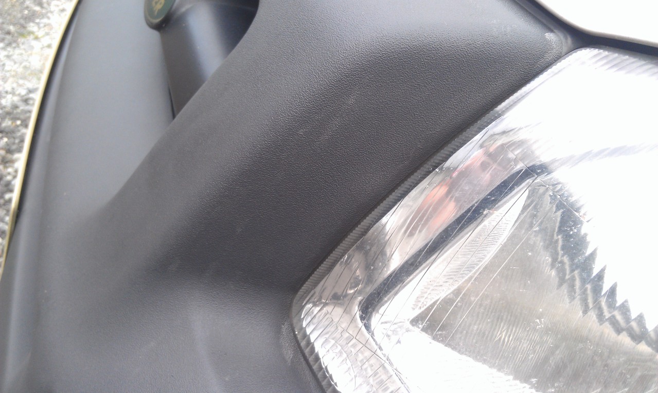

Now I did notice that over night where the "dew" had formed it has left water run marks down certain bits (near the corner of the lights) and also some bits seem a bit patchy. Maybe needs going over again lightly but I assure that the same amount was applied all over. Maybe that bit of the bumper had some deeper contaminants and should of been degreased rather then APC'd. Il remember that for the back end.
Can "lesser" trim dressing be applied over the top of this if needed to top up the "New look"? I suspect after a few months it will be fading again.
Gally
Sounds like it hasn't be buffed off enough mate. Common issue. I had the same thing with some new mudflaps.
Yeah you can apply trim dressing over the top if you want mate.

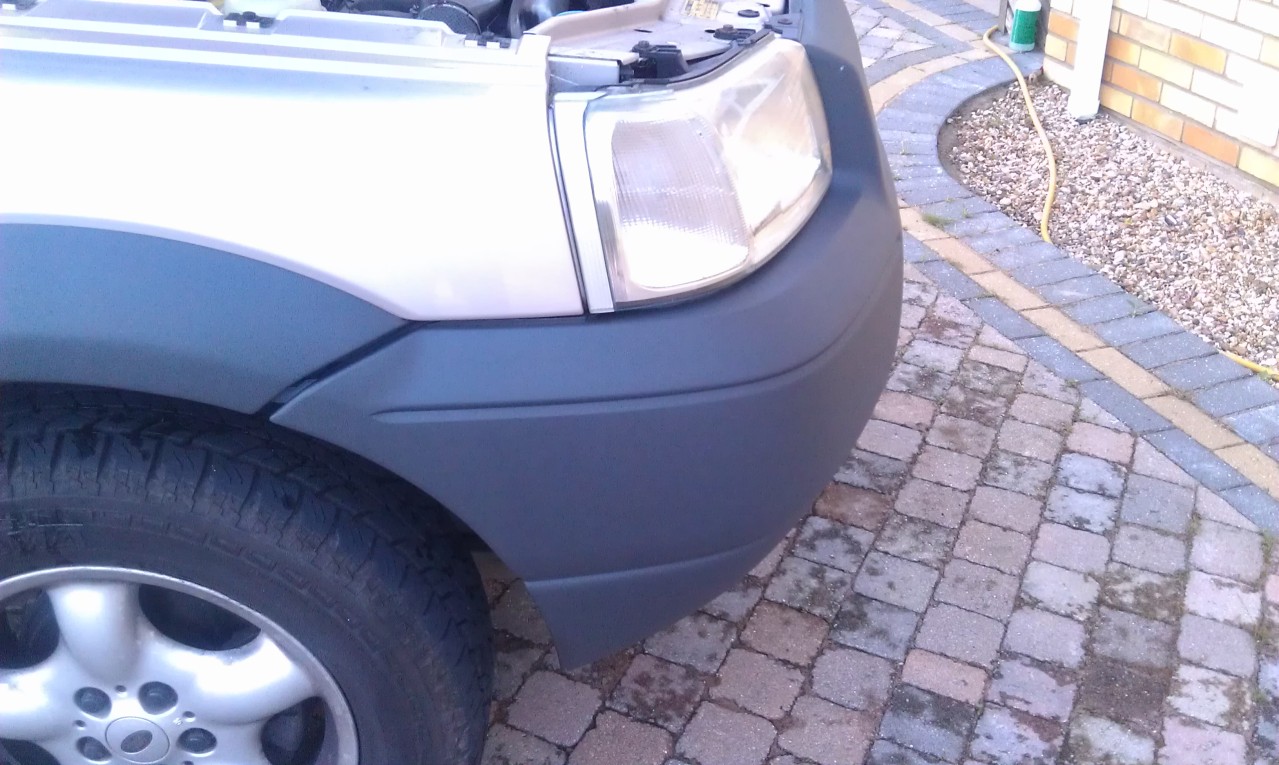

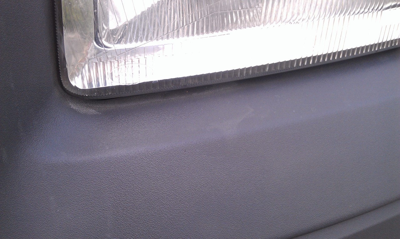

This is what I mean... (im aware I have missed the 2 bits in the corner :))
I assume the below is just water mark
Aucky, re apply. It's such a small area!
Richy, looks like mist pre application. May have caused bonding issues. No harm in washing, APC/DGing/IPAing and reapplying.
