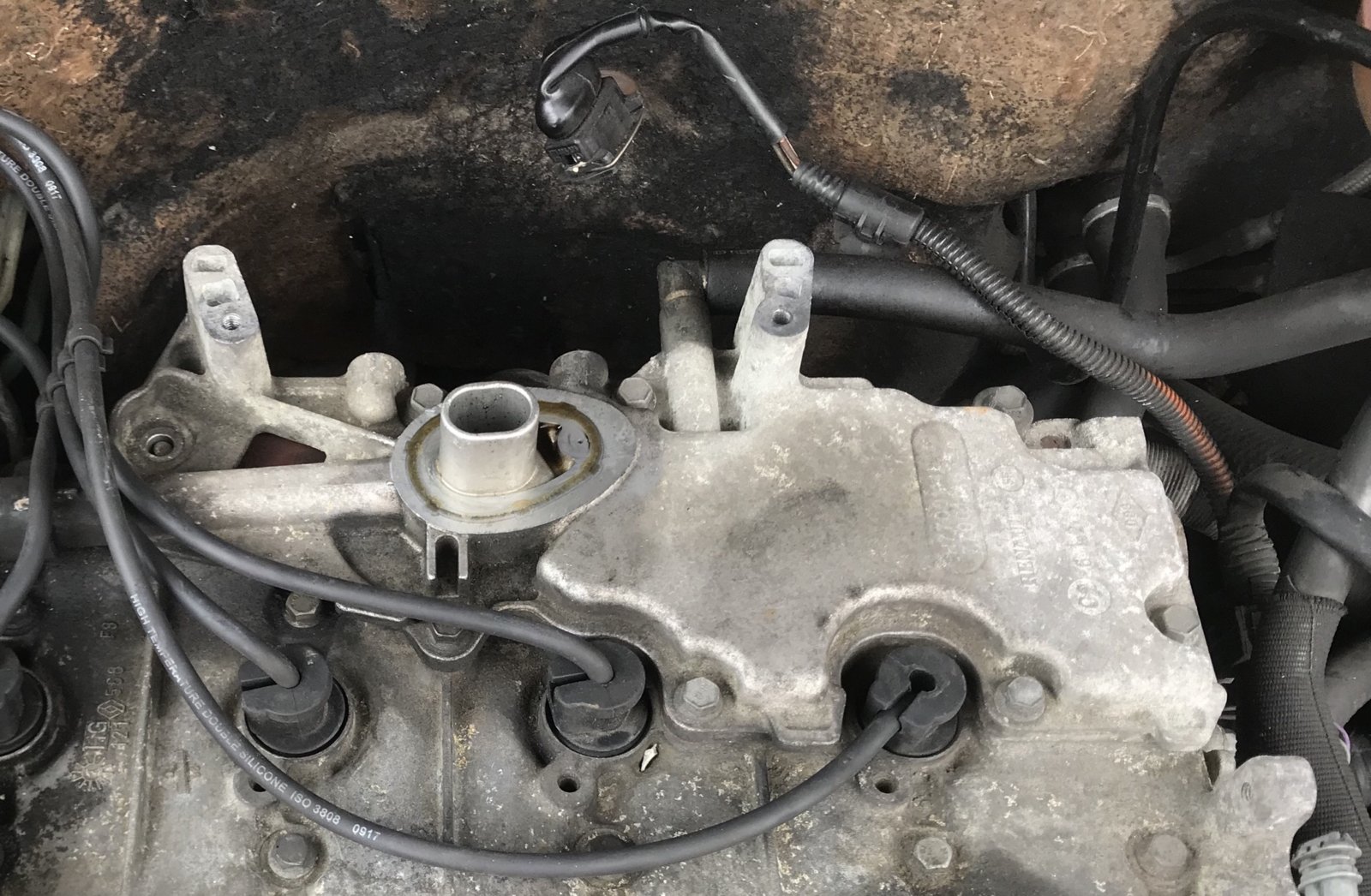

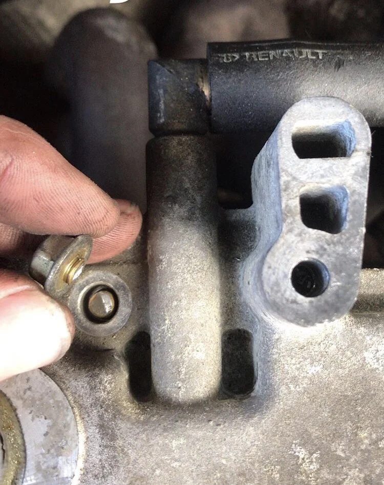

After poking my head around for the source of my oil leak I noticed that one of the bolts which holds the cam cover breather plate has sheared off.
I went to check one of the other bolts and that sheared straight off with no effort. Before I try to remove the rest of them does anybody know the bolt size and if there is anywhere which supply them?
Rystar
  2003 Clio 172
M6x25mm afaik,
Think Renault list them as M6x1 (1 inch length)
At least that's what I use ?
