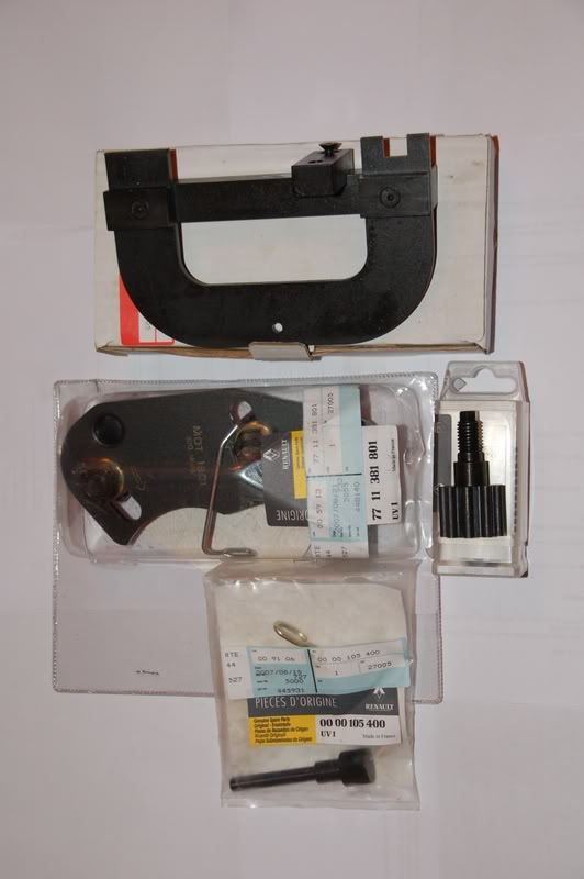

Hi, My friend has a 172 and it needs the Aux Belt and Cam belt changing. After a bit of searching, I take it a special tool is required and you cannot just get it done at a local garage? Is this correct?

What tools are required? I take it you do need specialist tools then?

the tools required

renault quote over £550 when i checked, a non dealer might do it for around the £250/£300 mark if you supply the tools if they dont have them. MAKE SURE they do as their required.
best bet is maby to nip into the workshop at renault and ask 1 of the RTE techs if they fancy a homer
