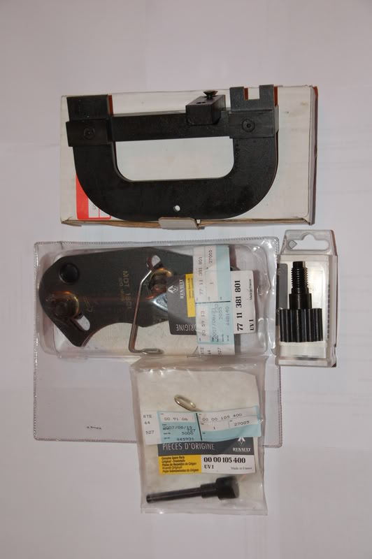

have you got the special tools needed?
  Lionel Richie
the tools required

My uncle a mechanic and has the tools, he's also doing the job - anyone know if there is a cheaper cambelt kit/aux belt kit that is available??
