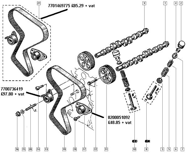

For a valver. Don't know if this is the correct name but that's practically what it is anyway. It's pressed into a bracket that sits behind the cambelt rear cover. It just seems a bit noisy and I want to replace it whilst it's in bits so that the engine runs nice and smooth when back together. Where? How much?

depending on which idler it is ? pulleys can usually be bought in kits ie - cambelt kit or an alt belt kit ( both contain the tensioner pulley / jockey wheel ) you can buy them seperate but i recommend you fit the kit
