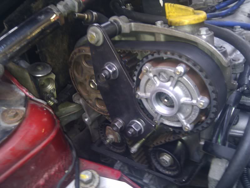

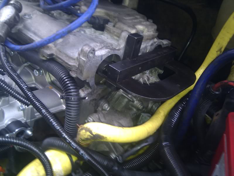

The correct, NECESSARY tools to do the job
  ITB'd MK1
depends on the engine. K4M/J (1.6 and 1.4 16v) require similar tools. 1.5 dci requires the correct pins to be used, and 1.2 16v isn't particularly a specialist job, although I've seen a LOT done incorrectly as no-one seems to know how to set a tensioner

The one in the first pic Dan, does it just lock the two pulleys together, like the ones you get that slide into the cam pullies, or does it also lock the VVT? I've no problem doing it and have the tools, I just like to get an understanding for what i'm using.

Depends on how you define "Proper" D as Renault don't actually make them. The most common items found in workshops these days are usually built by AST but Laser, Franklin and Sealey offer cheaper units that people seem to **** off (though I can't see what's obviously wrong with them myself).
A cam position "Setting Bar" and crank "Lock" pin kit will set you back around £70-90. The Pulley imobilliser will cost anoter £90-120 (The F4R/F4P uses one type and there's a seperate tool for the K4/K7 16v engines). Another tool that isn't always used in favour of a decent jubilee clip is the Aux belt tensioner bar... tricky to use on the F4'd Clio II's due to a silly plate being in teh way but on the Laguna II and Megane II its so much easier to use.
If like me you work with these things everyday then they're worth there weight in gold but for the DIY mechanic they're outrageously priced for a one time job on the driveway.

i hate the laser crap, the horseshoe is made of cheese, genuine renault ones are the best (and not that expensive anyway)

@Fred: I agree but in the defence of mild steel positioning tool, the setting bar shouldn't be used for any purpose other than holding the cams in place (Which is why we use the imobilliser tools). Still, I've seen people attempt to release the cam pulley 18mm nuts with them before. It's always funny to watch their face when the tool bends and then snaps the cam locating boss before blaming Renault for the shite design [shakes head].
