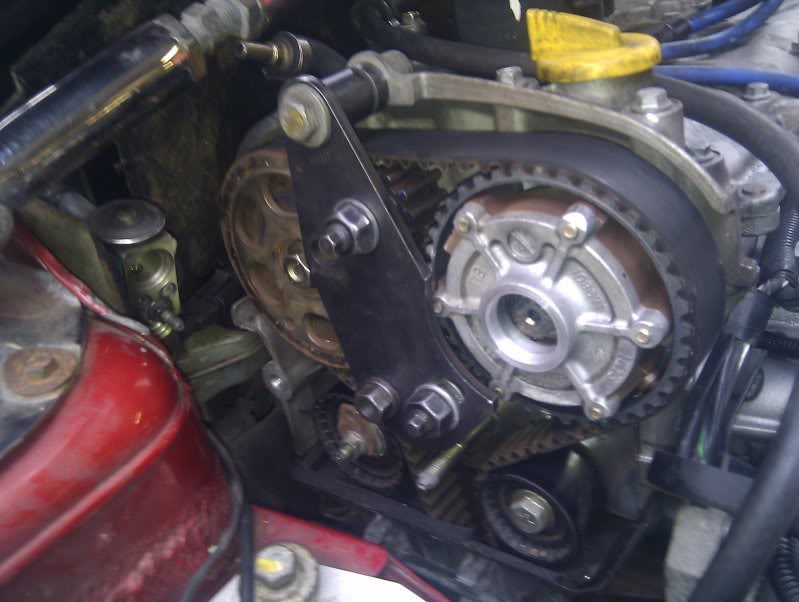

first one is s**t, its made of cheese

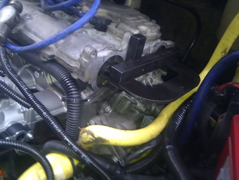

second one is nearly correct, missing a few bits
Hi everyone with regards to locking off the rear of the cams, to get the dephaser off couldnt you get away with using an impact and taking it off? and when installing the new one place it with mark in 12 oclock position and buzz it back on then torque it to spec when the new belt is on?
  megane
if you want your timing to be out then yes
also how are you going to get a gun on the exhaust nut?
I was just on about the dephaser pulley swap, if you lock the back of the cams, plus the tool to lock the actual pulleys then use an impact to undo the nut and when you come to re-installing it you can lightly zip it on then torque it to spec. What you guys think?
Does anyone know what the torque spec for the dephaser pulley bolt?
Cheers
  Lionel Richie
because you HAVE to undo the exhaust nut also to do the timing PROPERLY, without the pulley tool = forget doing the job

The correct, NECESSARY tools to do the job
What is the tool in the first picture used for if the tool in the second locks the cams into place anyway? Just wondering :)
  172
It locks the pulleys in place, without this you'll bend the tool in the lower photograph when undoing or doing up the camshaft pulley bolts - putting the timing out.
