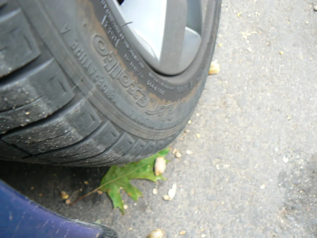

went last night to a car park and had some fun with the car but then seen this an wondered if some negative camber would help..
you can see how much flex the tyre suffered, was wondering if I could throw in some camber bolts on the stock dampers
do you think 1-1,2 neg camber on the front would be too much for road use and occasional b road blast?
thx!

The manufacturer value is from -0°59’ to - 1°02’ with a tolerance of +/- 30'. Your worst case would be to have only -0°29’ of negative camber.
is you -0,4 in degrees or minutes. this looks ok. The other side lacks some negative camber, which can be due to not spot on fitting. Fitting can change the camber values if you know what I mean.

Eibach or H&R...I bought them on k-tec. Tyre wire is BETTER! I use the car everyday on b-road and sometimes on the motorway. I bought them because I had different angles between R and L, so with the bolt I was able to put them both at -1,1°.
