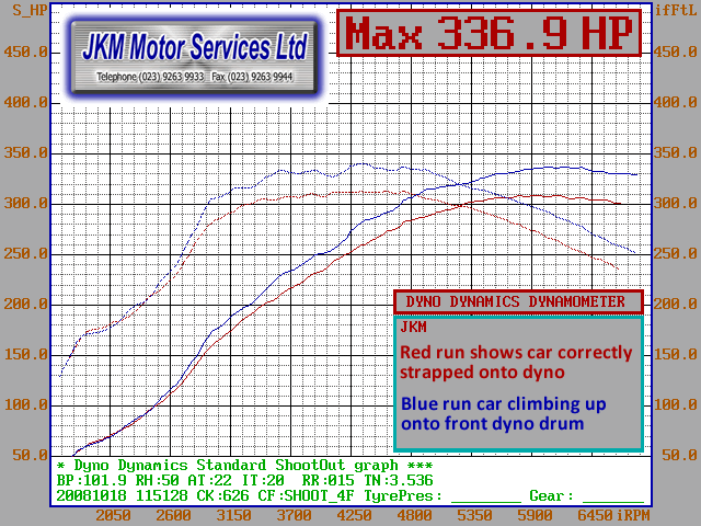

PS, this is what I mean about strapping the car so it climbs the front roller.
How's that for a power gain.
Thats 2 runs a minute apart, no changes to the car, just the straps being deliberately changed to show the effects.

If its a dyno dynamics set of rollers, it tells them everything they need to do in the manual TBH mate.
The two key things are:
Sensible placement of the air temp probe
Making sure the car is squarely between the two rollers on the driven wheel
But there are loads of other little cheats as well.

Had my Dyno training last week, plenty you can do to cheat dynos, not strapping the car down properly is an easy one. I tested it on my clio, strapped down properly it made 180bhp (after map) but with it slackened slightly, it made 202bhp (front wheel goes up onto the front roller)
Even a small movement to the steering wheel can cause it to mis-read.
