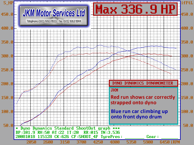

PS, this is what I mean about strapping the car so it climbs the front roller.
How's that for a power gain.
Thats 2 runs a minute apart, no changes to the car, just the straps being deliberately changed to show the effects.
