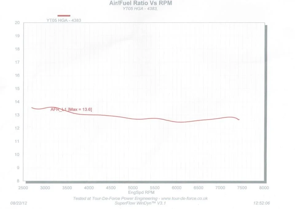

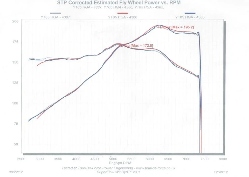

I've just had 438 cams fitted and mapped at TDF and made 195.2 really happy with the results so I would recommend these

Yeah probably works out with the same map about 190 ish I'd imagine. Only as Dynodynamics read 'differently'. Don't like the term under-read!
only one way to find out :) place down the road from me in hinkley 'dynodaze' has a dynodynamics RR £30 for two power runs and print il take it down there soon when the gearbox is back together in the next couple of days and see what it does!
Just don't read too much into it mate, if it drives well enough that's all that matters. You won't get much if any more out of it safely than what Matt can
nah I won't, pulls really nicely great improvement over standard so either way im happy but I had it on their rollers before the cams so would be interested to see what the difference is on the same RR.. plus for £30 you cant go far wrong with that !
Always nice to have an "independant" figure to back up the claims of the person doing the work, but as said its how it drives that really matters anyway.
