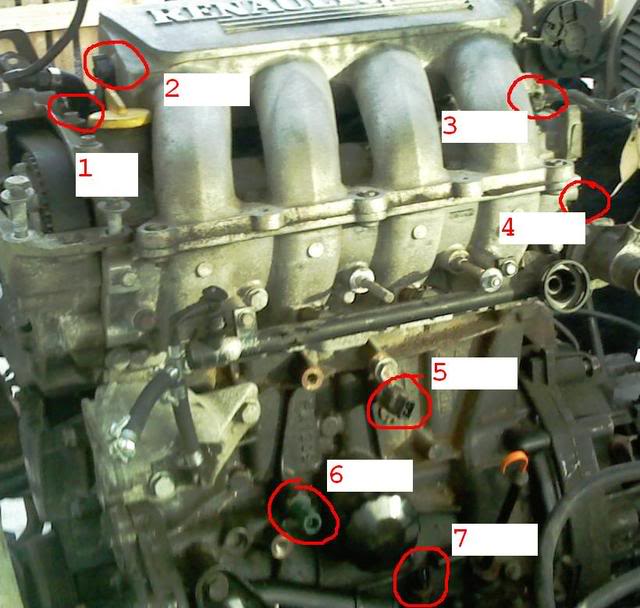

can anyone identify these engine sensors?
Car  RB 182
Apologies for this but I'm new to the clio engine, would it be possible for someone to list what each of these sensors are.. and if you have any addition info like colour of wire size etc I would be most appreciative
many thanks
Andrew
1 - VVT
2 - MAP
3 - IAT
4 - not sure what you've circled, but i assume you mean the CTS on the side on the head
5 - knock
6 - OPS
7 - OL/TS
What he said. Just to decode.
1 - VVT - VVT Soleniod
2 - MAP - Manifold Absolute Pressure Sensors
3 - IAT - Intake Air Temp Sensor
4 - not sure what you've circled, but i assume you mean the CTS on the side on the head - Coolant Temp Sensor
5 - knock - Knock Sensor
6 - OPS - Oil Pressure Switch
7 - OL/TS - Oil Level Sender
What's the one on the back next to the coil pack? Attaches using the same clip mechanism as the IAT, and is black.
Are there any others further down the back?
digital linear actuator
the air passes in side from it when you are on idle
and it arrage the air on idle
Be either the map sensor or the vvt soleniod. Nothing down the back on the engine, pre cat lambda is in the area though.
