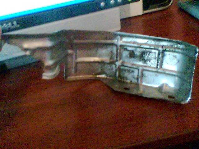

Can anyone identify what this is that fell off my car last night??? Pics attached!
Paddy_g46
Can anyone identify this? fell off my car!
basically i hit a bit of a bump in the road and this came off from underneath and made a clatering noise on the road which was what allerted me to it, recently on low revs iv been having a metal springy noise which i think was this possibly loose and now it has snapped off from the vibration of the car.
the metal is quite thin so i think it is soem sort of gaurd, it has a couple of bolts holes but a piece of it has snapped off!

Re: Can anyone identify what this is that fell off my car last night???
That looks like a wheel archer liner but metal! LOL
Though is probably just some sort of sump guard :)
shorten the title ;) Looks like the heat shield.
its very likely to be an exhaust manifold heat sheald that protect the o/s drive shaft boot from melting from the heat of the manifold
you'll find the rest of it attached to the rear engine hoist point.
Its the heat sheild that goes between ex manfiold and oil pressure sender area.

is that a definate answer? is it ok to drive without it for now, or forever?
Go have a look, you should have half of it still bolted to the rear engine lift eye.
Alot of people dont put them back on.
Yes, that is definatly what it is.
Haynes lists it as a fuel pipe heatshield, so on that grounds i would get it replaced.
I have a spare.

Re: what this is that fell off my car last night??? Pics attached!
aye def the mani/oil press guard.
no real problem running without 1. id be more worried about how its managed to rip itself in 1/2 tbh.

cheers guys, ill replace it when i get back from my trip next week, matt how much do you want for 1?
