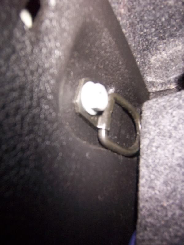

Okay, I've looked at how it's been installed. They HAVE ran the power and RCA leads down the same side of the car (which makes me angry), however, when i do unplug the RCA's from my amp (so no inputs are connected to it) I am STILL getting alternator noise through the 6x9's which indicates to me the the earth is the problem.
The amp is earthed to a large bolt which appears to hold the rear seats in place. The earth wire is really thick (about 1.3cm thick without measuring it).
Someone said about earthing it to some bolts where the lights were. All i could see were some thumb plastic bolts which seem to go into the lights.
Any ideas or suggestions? Also the 6x9's still seem to have a constant hiss to them (even when RCA inputs are pulled out). I'm hopeing this is also the earth that's causing this.

I don't seem to have thease earth points in my boot like you do. I've taken some pictures of my boot so you can see.
I also am now 95% sure that the AMP's earth is causing the problem.
On the picture of the right side of the boot, the rear seat bolt is where the amp is currently earthed and seems to be picking up noise from.
My clio is a Mk3 I believe (2005 model).
