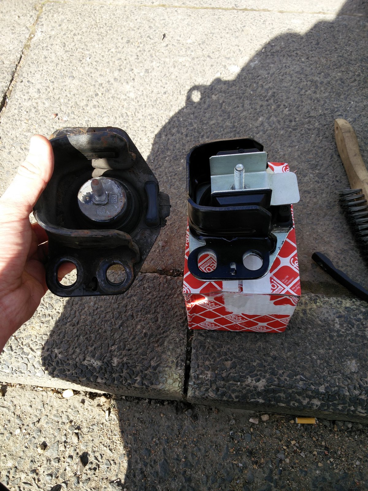

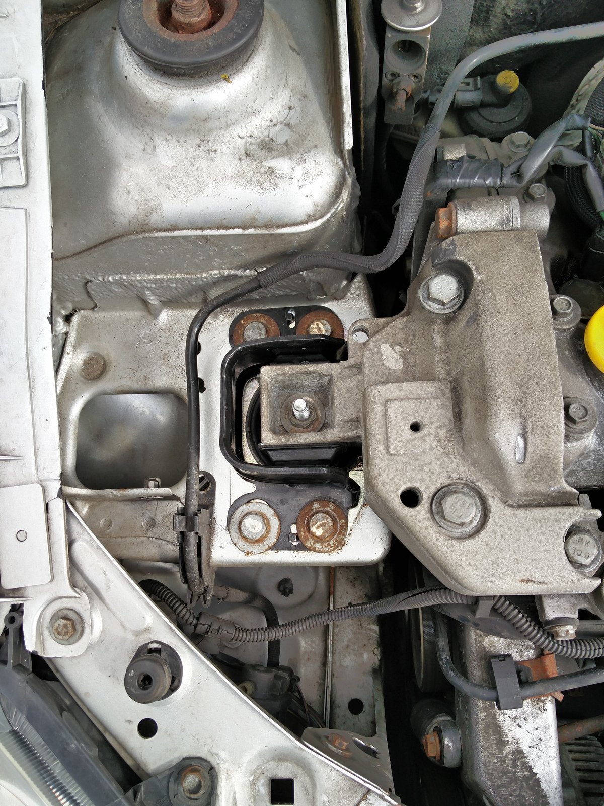

Thanks to all that posted, inspired by your ideas I parked the drivers side on the pavement, jacked up passenger side and supported with axle stands, which gave me enough room to get trolley jack under the front of car.
