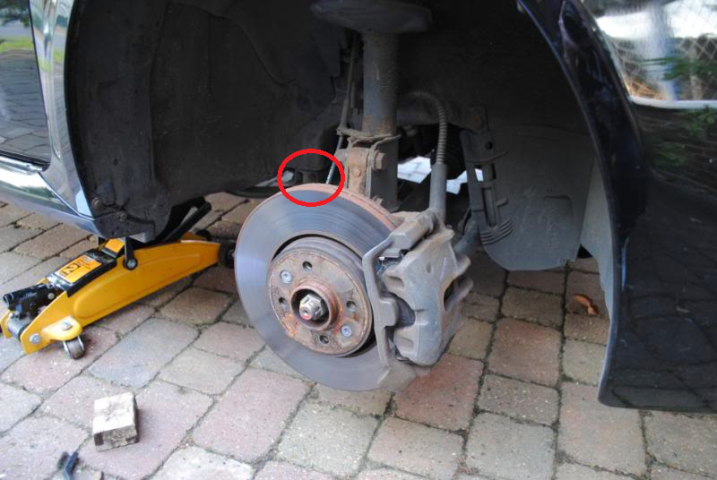

Old shocks and springs are off, new ones are together in the correct order, but I can't for the life of me get them back on.
I've got the car jacked on these points circled red here (not my photo):
For whatever reason, I can't get the hub holes and shock holes to line up and it's not without trying either. I've had me and another person trying to get it to match up but I must be missing something?
Any ideas?

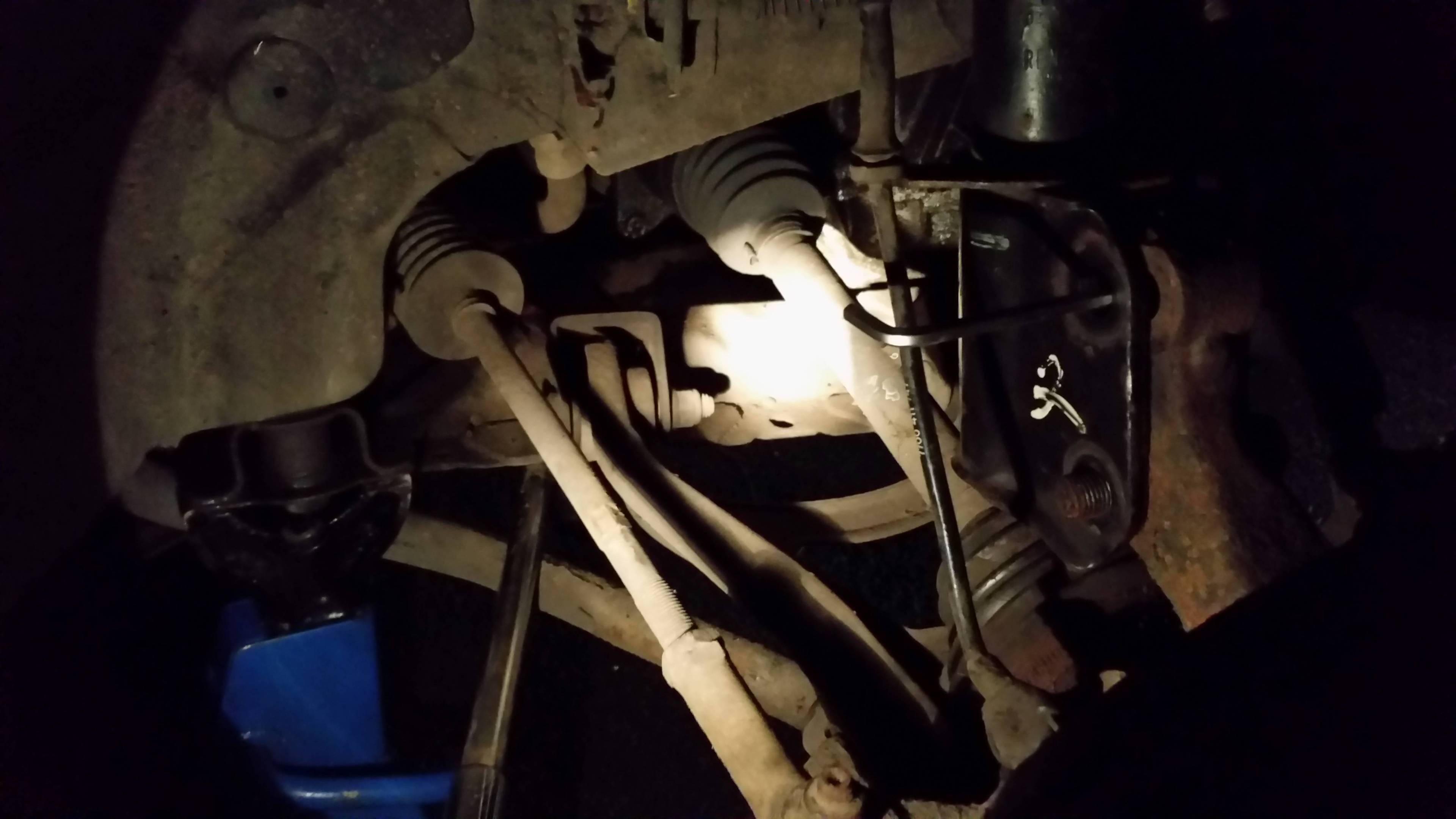

Jack handle between anti rollbar and wishbone to help the hub down and line it all up. Then use a screwdriver to locate the bottom hole on strut.
I'm using the renault widow maker and axle stands. So I take it I'll need to take it off the axle stand one side at a time temporarily with the renault jack, to allow the hub to drop down? I've not done a huge amount of work on the clio so forgive me, but when you say jack handle between the antirollbar and wishbone, do you mean there's a good jacking point in that area that I should be using the axle stand on instead?
no what he means is this...
leave the car on the jack / axle stands how you have it. then remove the lever / handle from the jack to use it as a bar, or if you have a large pry bar get it in your hand. then use it as a lever between the wishbone and anti roll bar and push down hard on the bar with your weight behind it. this will move the hub / wishbone etc downwards allowing you to just get the shock lined up. hope this makes sense.
