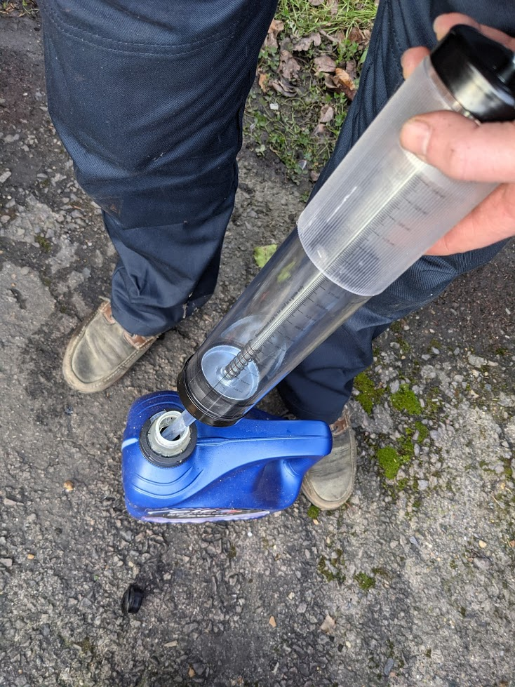

I've gone for ;
Elf Tranself NFP 75W-80 Transmission Fluid​

JC5 box Oil is ELF NFJ not NFP
Fecker, had to go out to the garage to check what I used at the weekend, couldn't see the front in the only pic I had.
It was NFJ :) do you happen to know what the difference is?
YorkshireKyle
Not all gingers stink of piss. But I do.
NFP is slightly thinner, they're both GL4 iirc so shouldn't be too much of an issue but the PK4 boxes had issues with NFJ so they made NFP a bit thinner so bearings and diffs didn't wear out as much
